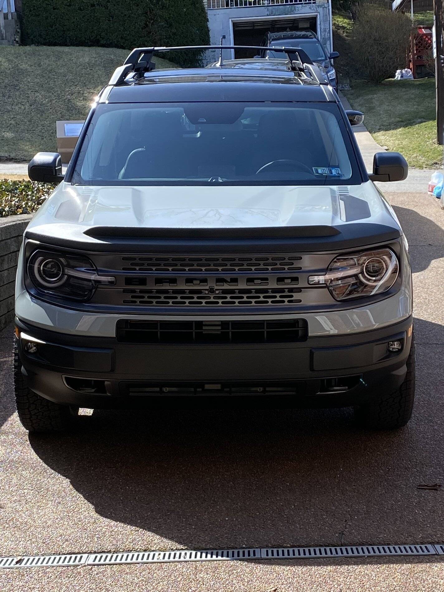

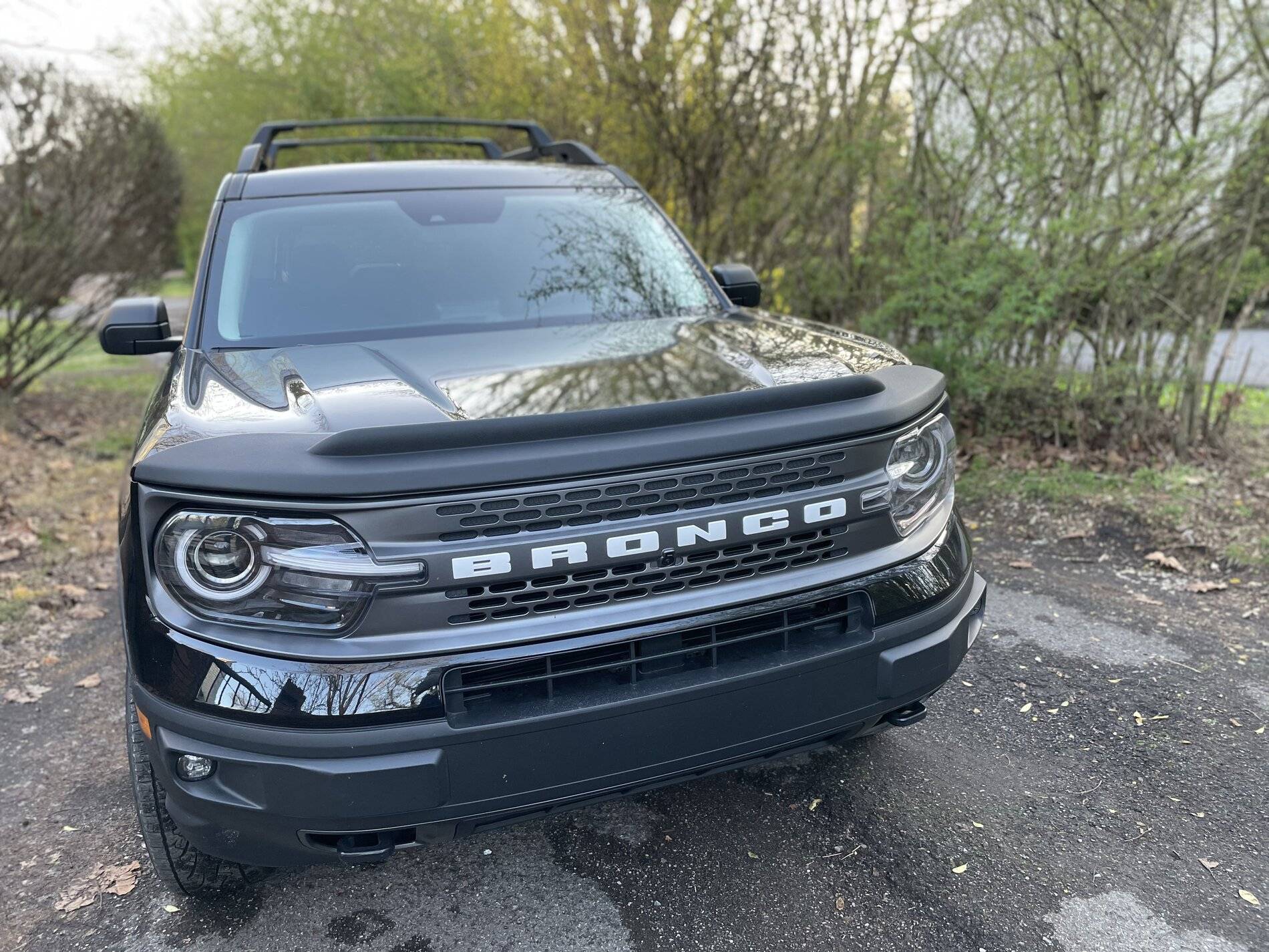

Install today
Ford Bronco Sport Anyone install Aeroskin Hood Protector on their Bronco Sport? 813E6C57-87C4-4CA5-B7B8-841A9A419035
Ford Bronco Sport Anyone install Aeroskin Hood Protector on their Bronco Sport? 33E6C31D-8C56-4EB4-AA2D-6B847B444300
Btw, when I watched the Ford guys install mine one of them used a razor blade to cut out some of the tape and a small notch along the edge to achieve the drainage. I was pleased to know he had experience to consider that as I wouldn’t have thought myself. Looks so good though, I like your color contrast!

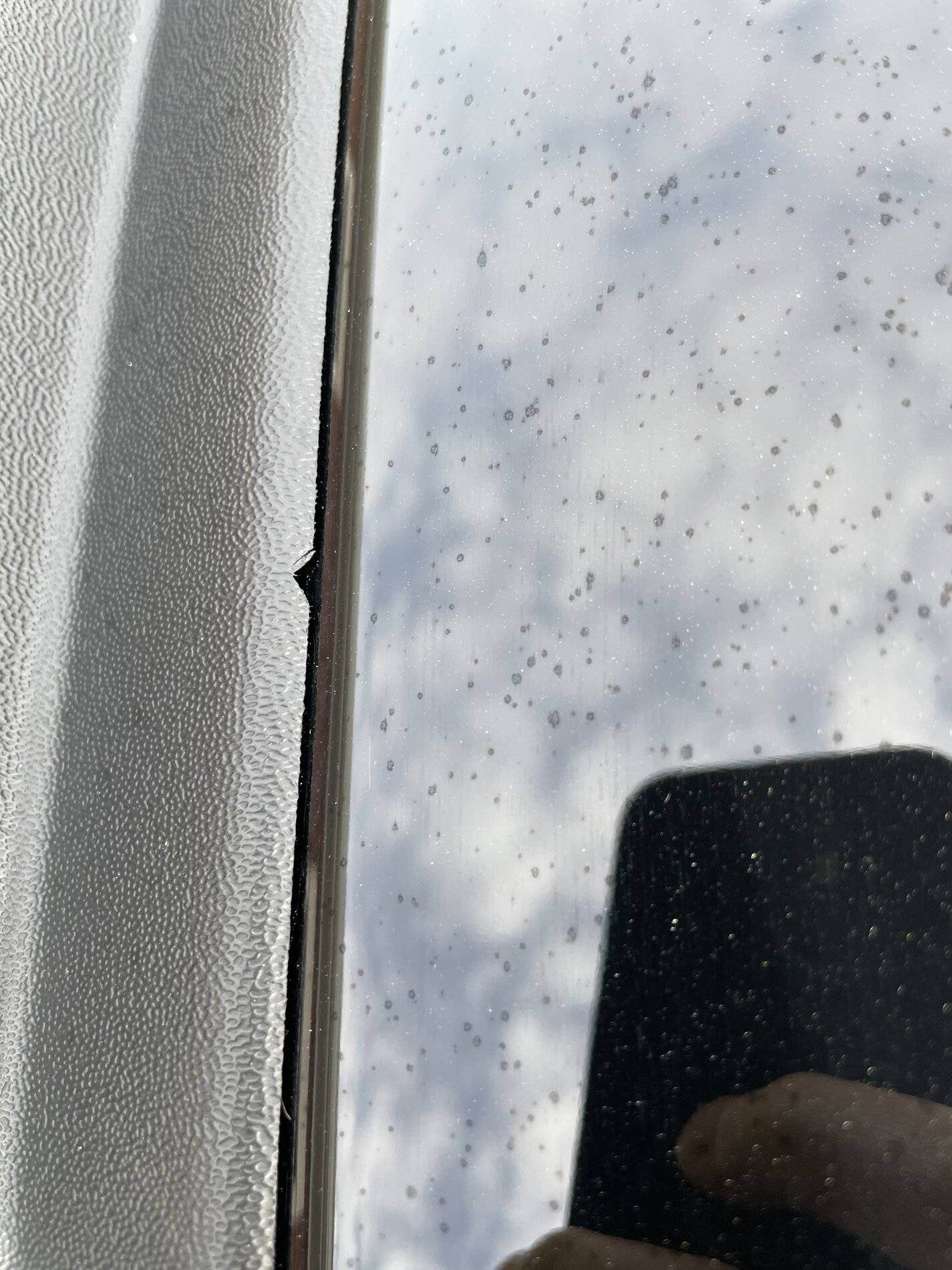

In the center when you flip the protector over there is already a gap where the tape is left open. The guy cut out a section of about an inch on the area that adheres to the hood above the gap and the a small notch in the outer edge. I’ll snap a quick pic and post if it’s easy to see.
Ford Bronco Sport Anyone install Aeroskin Hood Protector on their Bronco Sport? F6C00275-B8A6-4D64-BFB3-2348C544C0A3

Install today
Have you noticed an increase in movement of your hood on the interstate? I can’t tell if mine is due to wind picking up the last two days or the addition of this hood protector.
