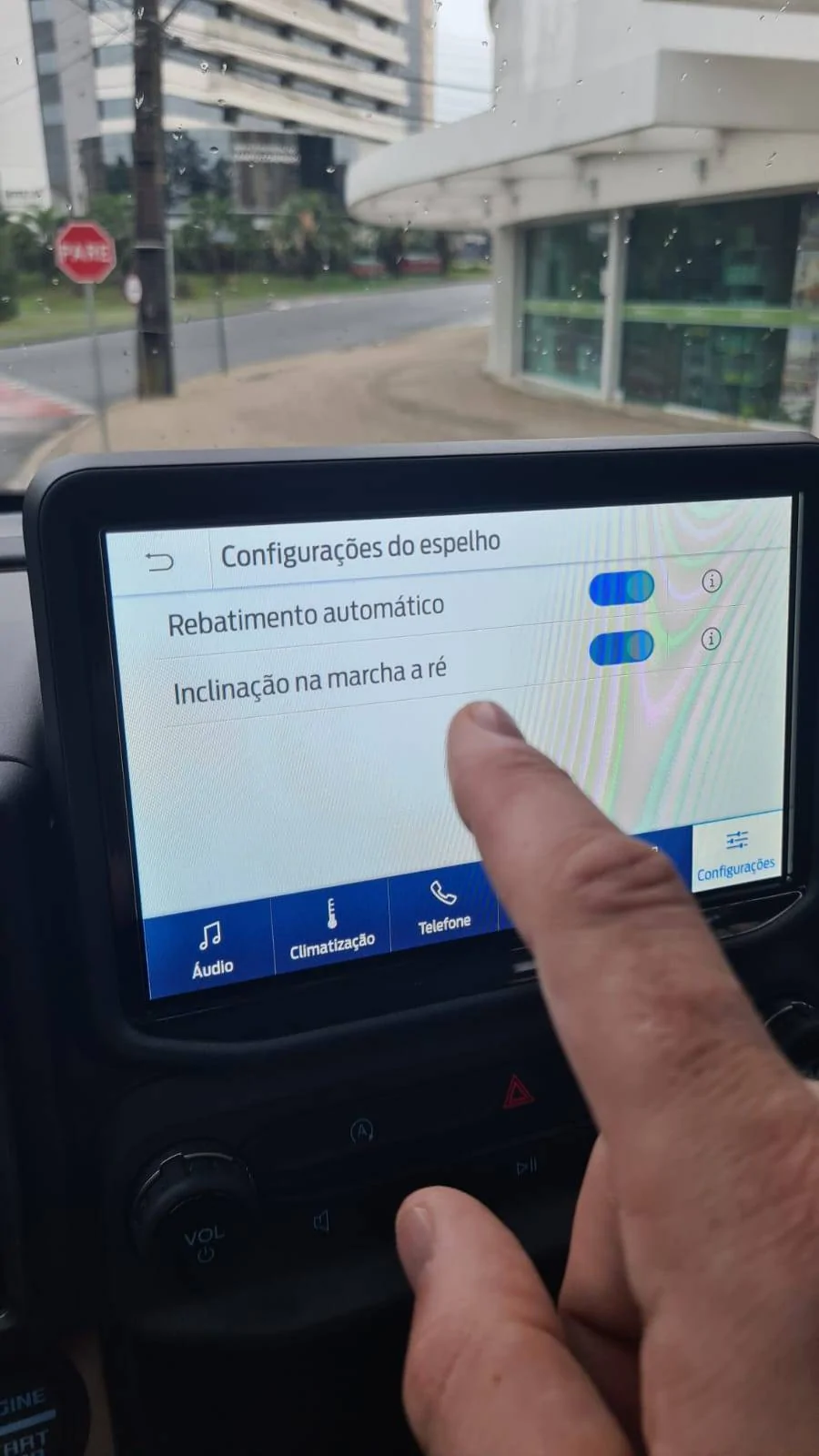

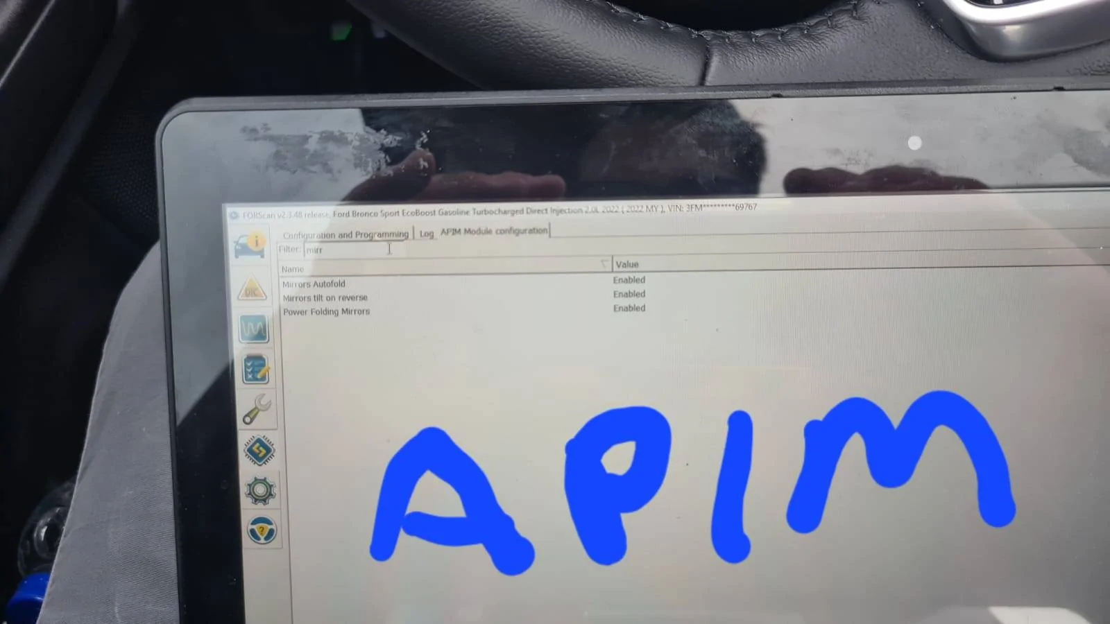

Looking again in the options and all electronic modules I got few advance, but no functionality yet.
Messing around and enabling some options in the IPC and APIM, I got to the "Mirrors" option appear in the screen.

om APIMI enabled 3 items
MIRRORS AUTOFOLD
MIRRORS TILT ON REVERSE
POWER FOLDING MIRRORS
Ford Bronco Sport Any way to program Auto Fold Mirrors when locking vehicle? WhatsApp Image 2022-10-15 at 10.53.29 (4)

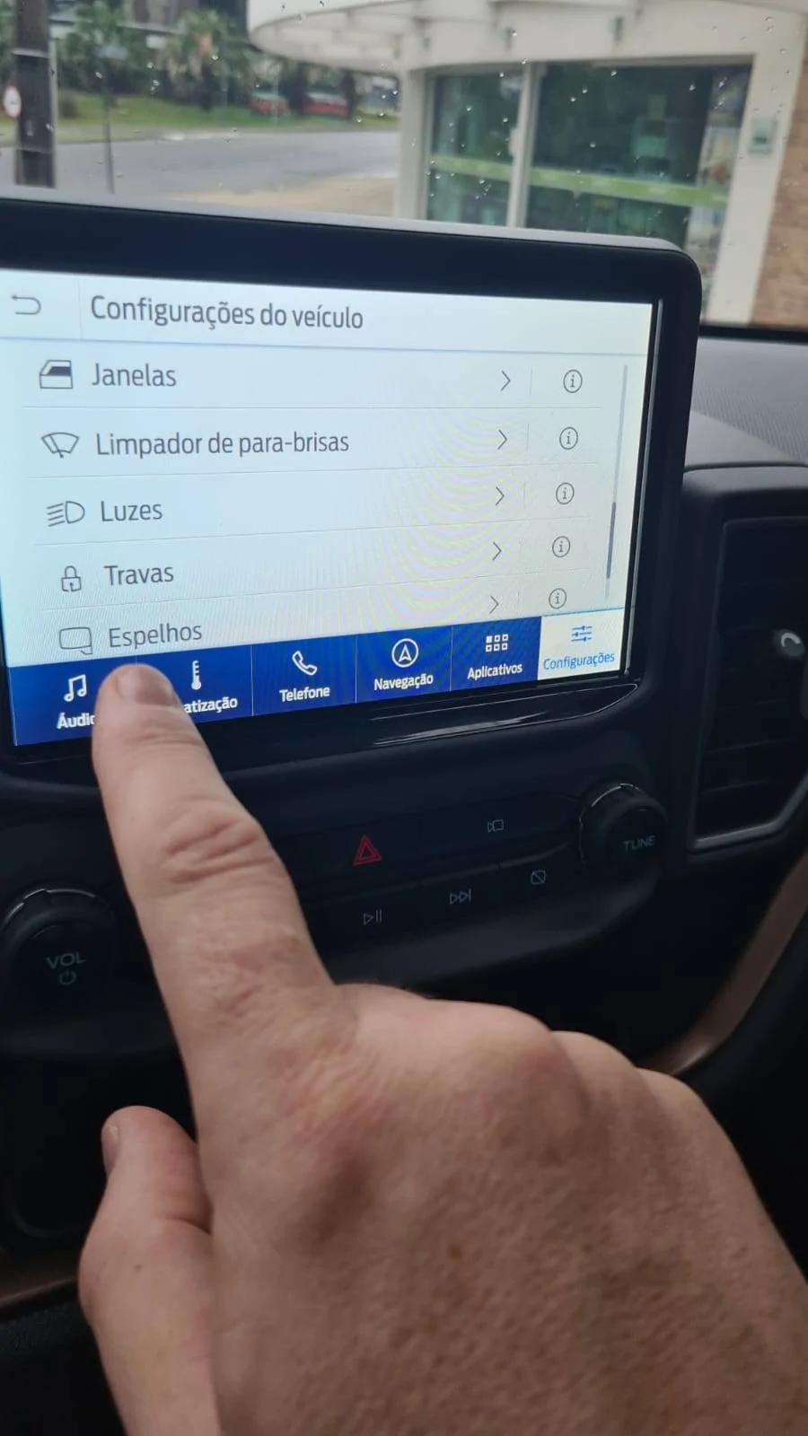

And now on Settings - Vehicle I have MIRRORS (ESPELHOS) and both options enabled (autofold and tiltdown)
Ford Bronco Sport Any way to program Auto Fold Mirrors when locking vehicle? WhatsApp Image 2022-10-15 at 10.53.29 (1)
Ford Bronco Sport Any way to program Auto Fold Mirrors when locking vehicle? WhatsApp Image 2022-10-15 at 10.53.29 (2)
But with no success in the funcionality yet :-(

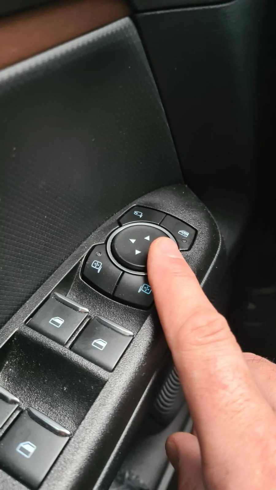

I realized something really weired today....
When I press the button to manually fold the mirrors (with engine still running), the mirrors fold ok.
Then I press the start/stop button to turn the vehicle off and leave it.
When I touch the door handle or press the RC button to lock the vehicle, the mirrors UNFOLD !!!!
WHen I return to the car and unlock it, the mirrors FOLD again
:crackup: :crackup: :crackup: :crackup:
I had to disable the function I added in the screen so that I can mannualy fold the mirrors and KEEP THEM FOLDED
