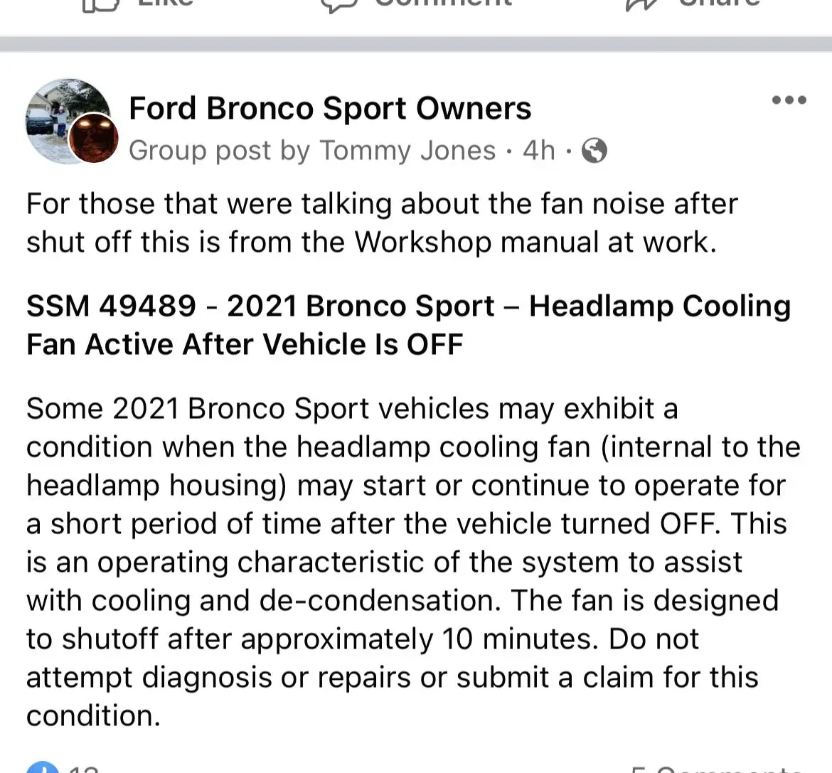

Has anyone noticed a small fan sound when the car has been turned off for some time? I hear it while washing the car and it sounds like it’s right behind the driver’s side headlight.
Jenma
Jan 25, 2021
Vancouver WA
2021 Bronco Sport, 2015 Mustang GT, 1994 Explorer
Yes, I posted a thread on this but I don't know how to point you to it. Could someone chime in and explain how to link to a different thread?

Do you recall what the thread was under? In your history you can locate where it was and then I can seek it out...?

It's in general topics. "Brand new with a question" I think we concluded it is a fan for the headlights but I don't know that for sure. I went in the garage yesterday and it started to make the noise. The car hadn't been run for two days so I don't know what it is doing. You are not alone.

Interesting... oh well, I guess I won’t worry about it. It’s under warranty so all good I suppose. Thanks!
It is the fan to cool the led headlights it can run for about 20 minutes after.

Someone above said it was running on a vehicle that had been sitting for 2 days.... a little weird if you ask me.

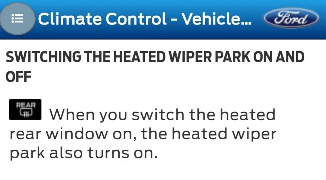

I love the fact that the windshield wipers are tucked in and out of site below the hood. The only exception is when you get 2" of sleet, it's very difficult to clean the area out and rescue the wiper blades. Thankfully I don't experience sleet conditions very often!
schizorage
Brian
Jan 7, 2021
41
Southwest Ohio
2021 Bronco Sport Base
If you turn on the Rear Defroster it also heats the front wiper park.

Hold up, what??? 😮
... So this is different from the "wiper de-icer" that is only available on the OB and FE? (i guess it IS because that screenshot doesn't mention anything model specific....)
If so, this is great news.
