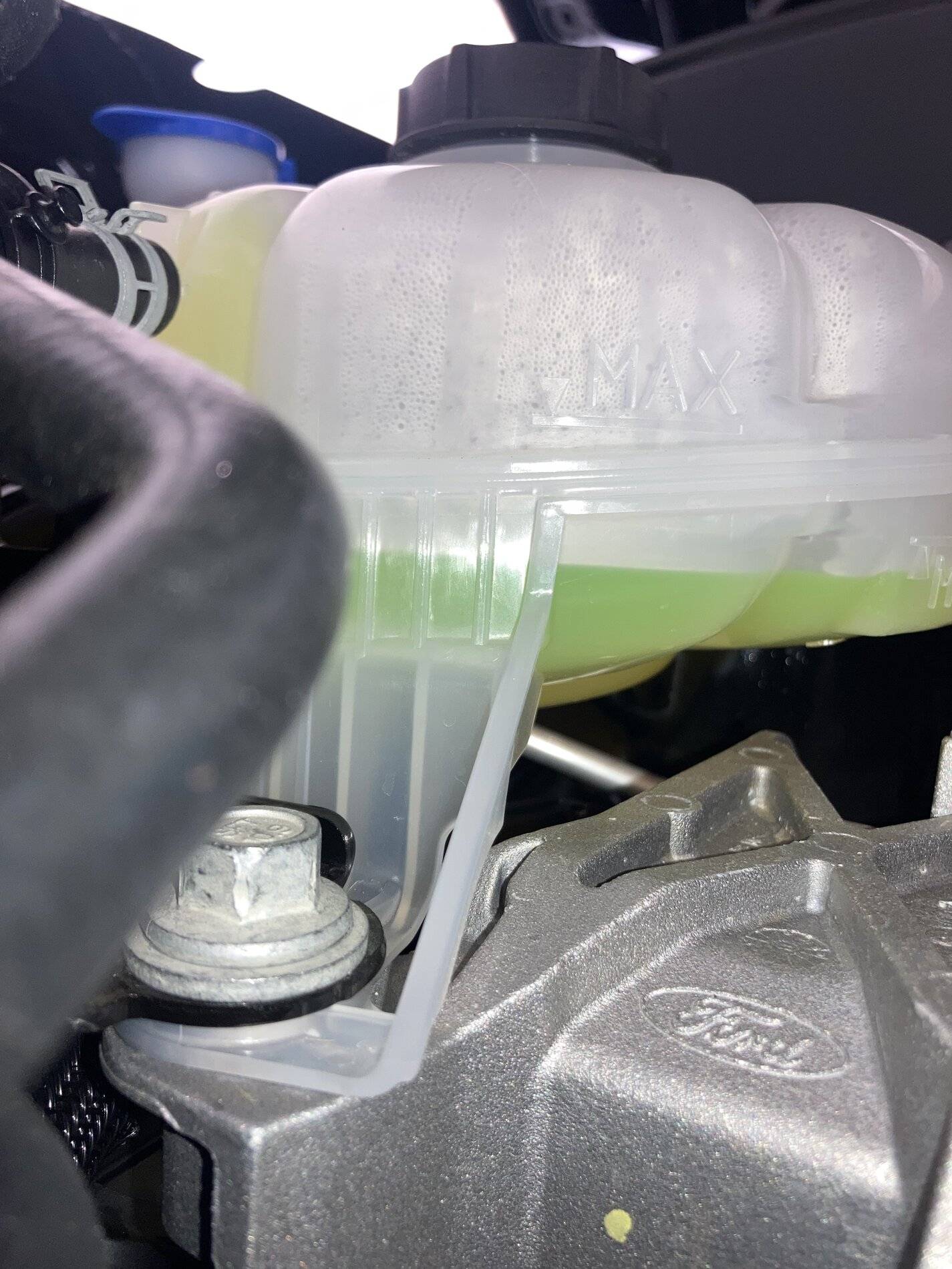

Repair ticket did mention that they added coolant, I checked it later at home and it was well below minimum. I’m guessing that they were supposed to refill as part of the wsm and didn’t. Not the most pleasing thing to see but I have some Motorcraft VC13 here at the house so I topped it off and will keep an eye on it.

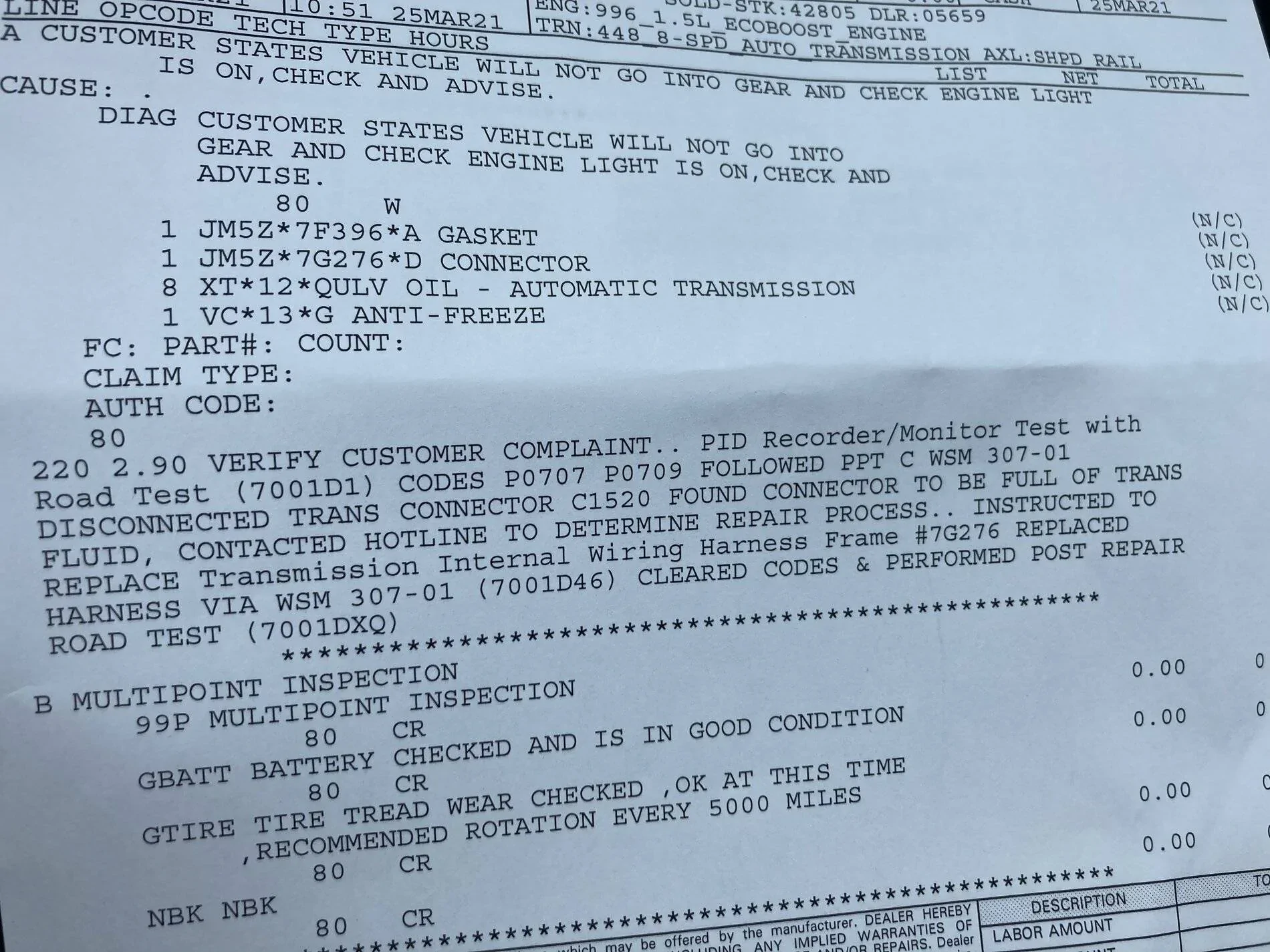

The repair Ticket for those interested, the ticket mentioned trans fluid specifically flooded the wire which I was not told about :
