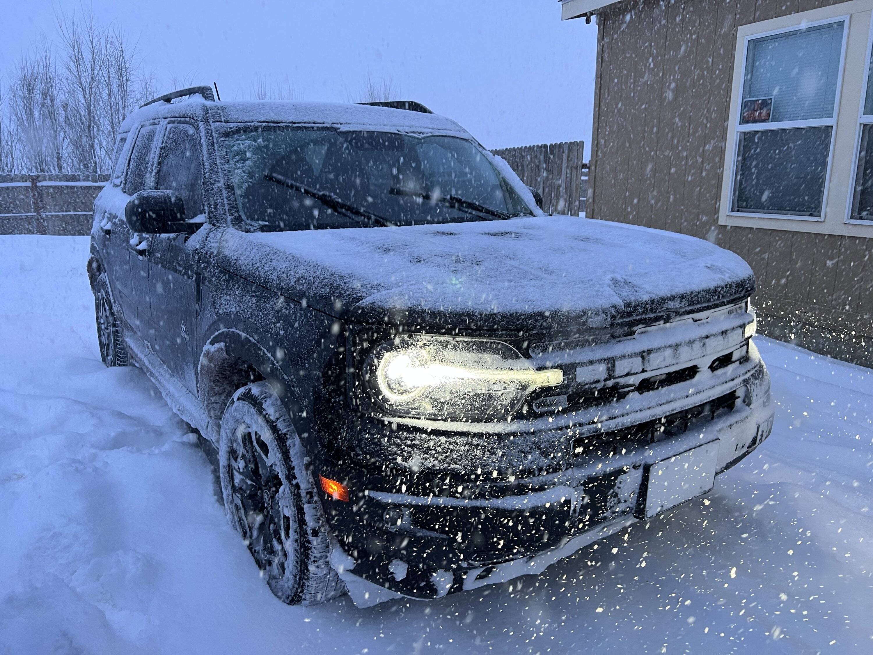

Will, I got the bronco Sport in the shadow black color back in 2021. It has reached 102 thousand miles this year and I decided to take it in for a diagnostic test because I noticed there was a slight shudder when excelling to speeds from 30 to 36 mph. It took a while for the dealers to get my bronco sport in the shop to do the diagnostic because I had to wait until 2024 of January. Appointments were backed up til then. Anyways, so I got the diagnostic done and when I finally got to talk to the mechanic he told me that I needed a brand new transmission because the discs in transmission was slipping and that the car has reached its half life point. He said it would be about 7 thousand for a new transmission. On top of that, he continued to tell me that there was also misfiring going on in the engine and that I would need work on the engine as well. I was horrified and lost for words…I don’t have any warranty’s left on my bronco. i don’t know why I’m writing this, I only think it’s because, I needed to tell my story. I guess, I also need some suggestions and wondered if there were other people out there with these same issues? I tried to see if I could trade in, but even the dealers don’t want to give me another ride due to upside down equity issues with the car loan.
