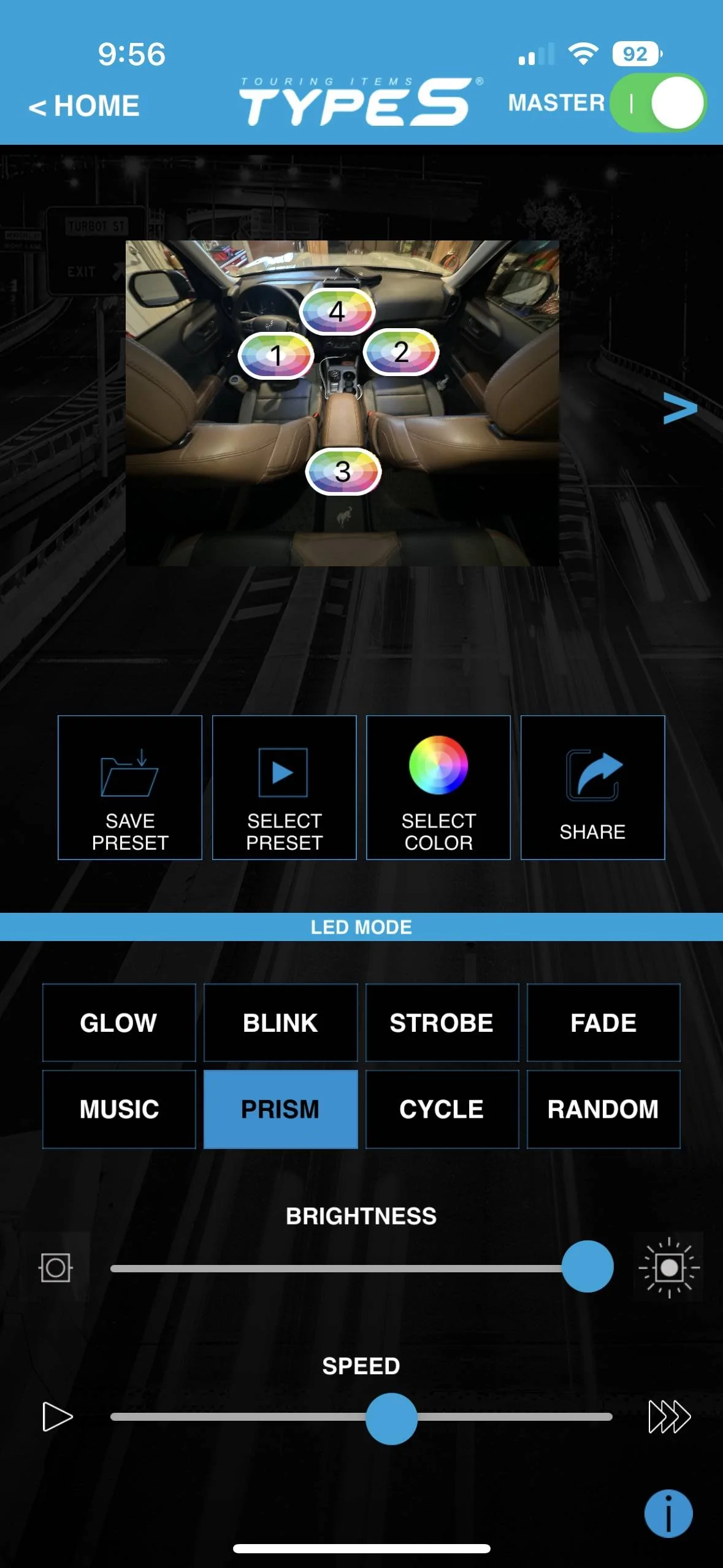

yeah the kit comes with a little control box that you plug the light strips into (then the control box plugs into the 12V) there are 4 different ports on the control box for 4 different zones, you can control them all together or separately to adjust brightness or color, my pics show max brightness but the minimum brightness is very dim that you can’t really even see the light. Here’s a screenshot of the app and the 4 different zones.

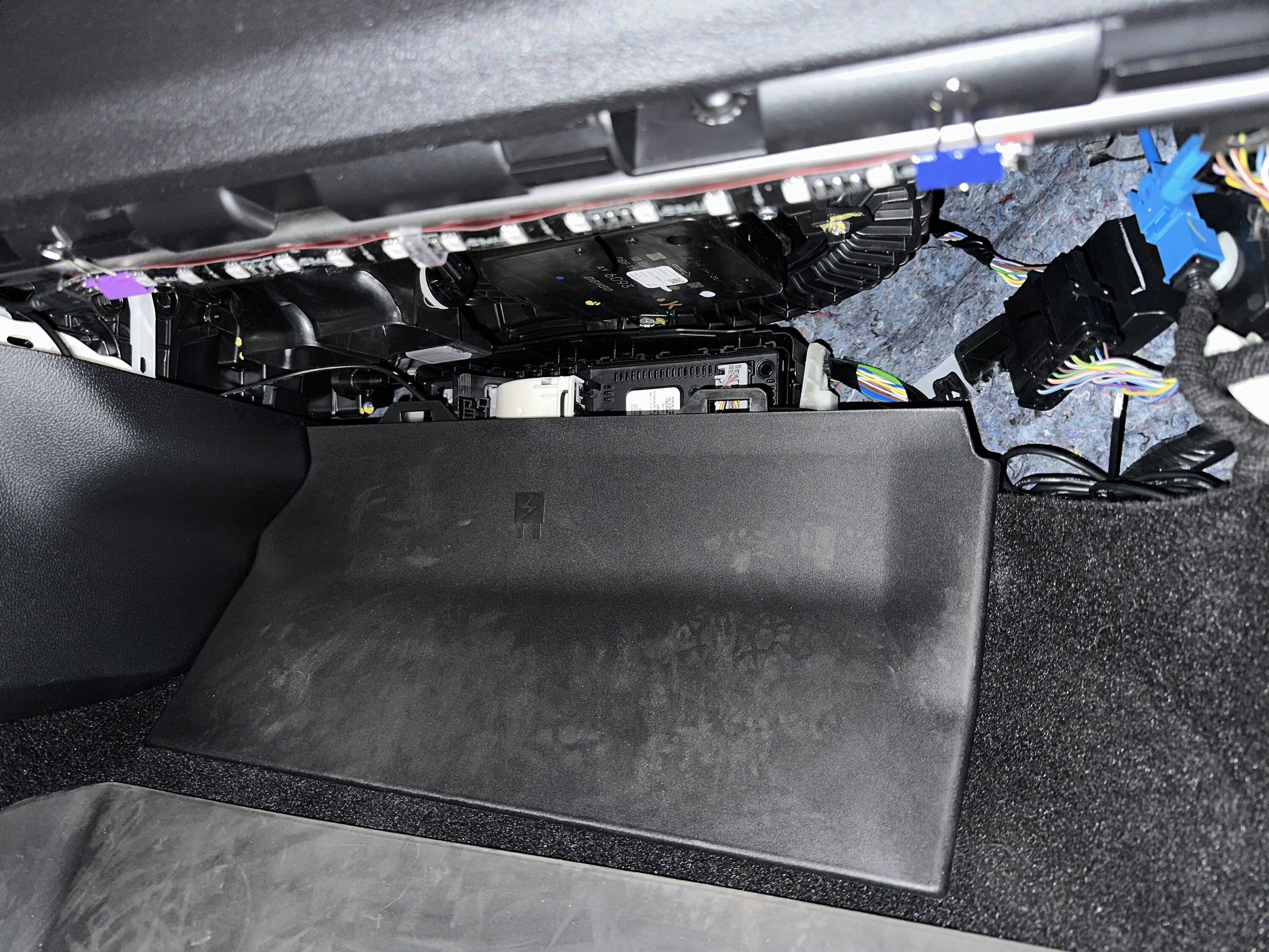

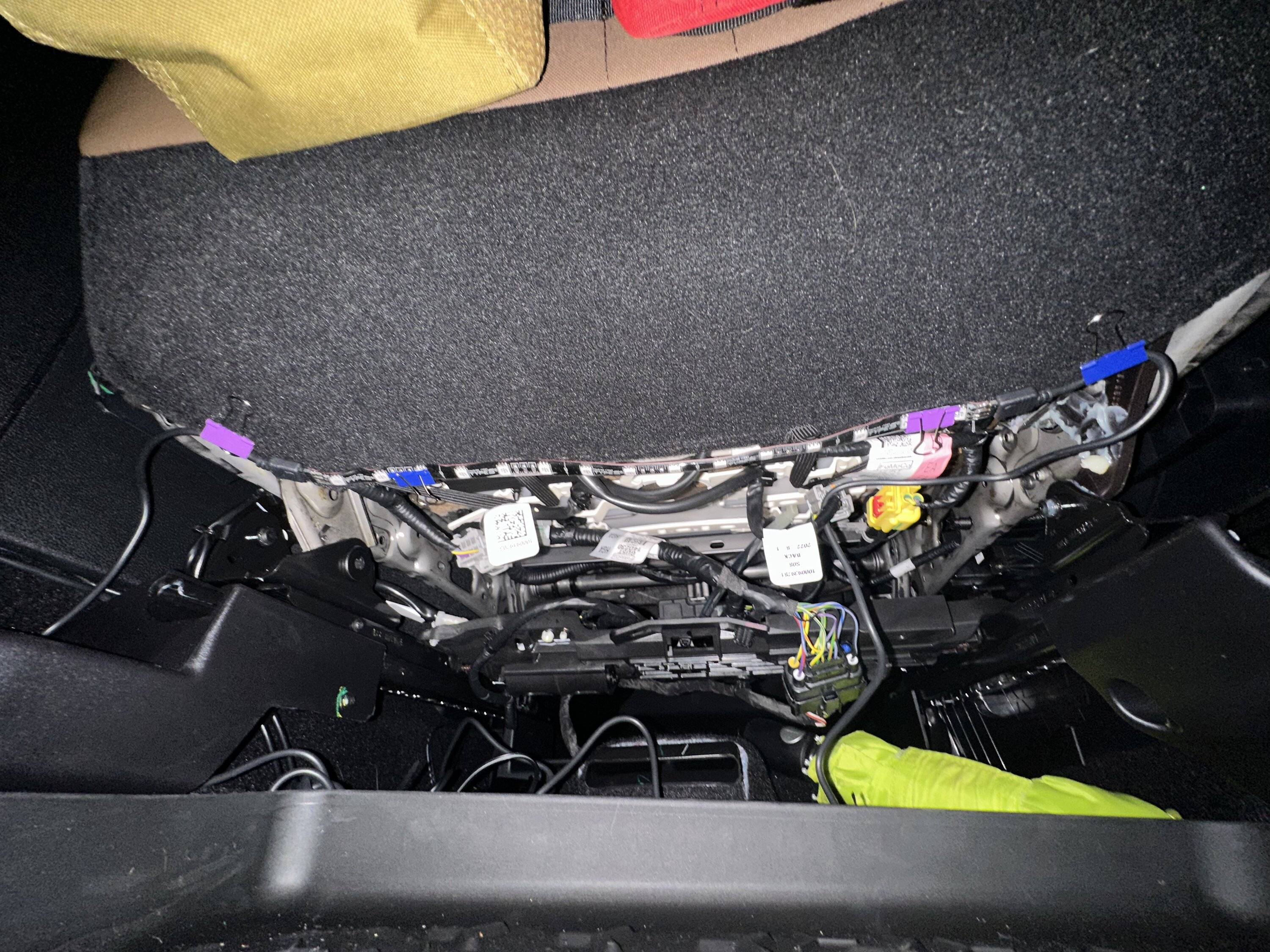

The light strips have an adhesive backing so I used that for the drivers footwell and for the passenger footwell (under glove box) and under the the front seats (to light up the rear footwell) I used binder clips to hold them in place. The wires I just tucked under the center console where it meets the floor, it was pretty easy to push the wire up under there I used a little flat head screwdriver to help push the wire. I put the control box under the passenger seat so the wires just run from the front footwells along the center console to under the passenger seat.
