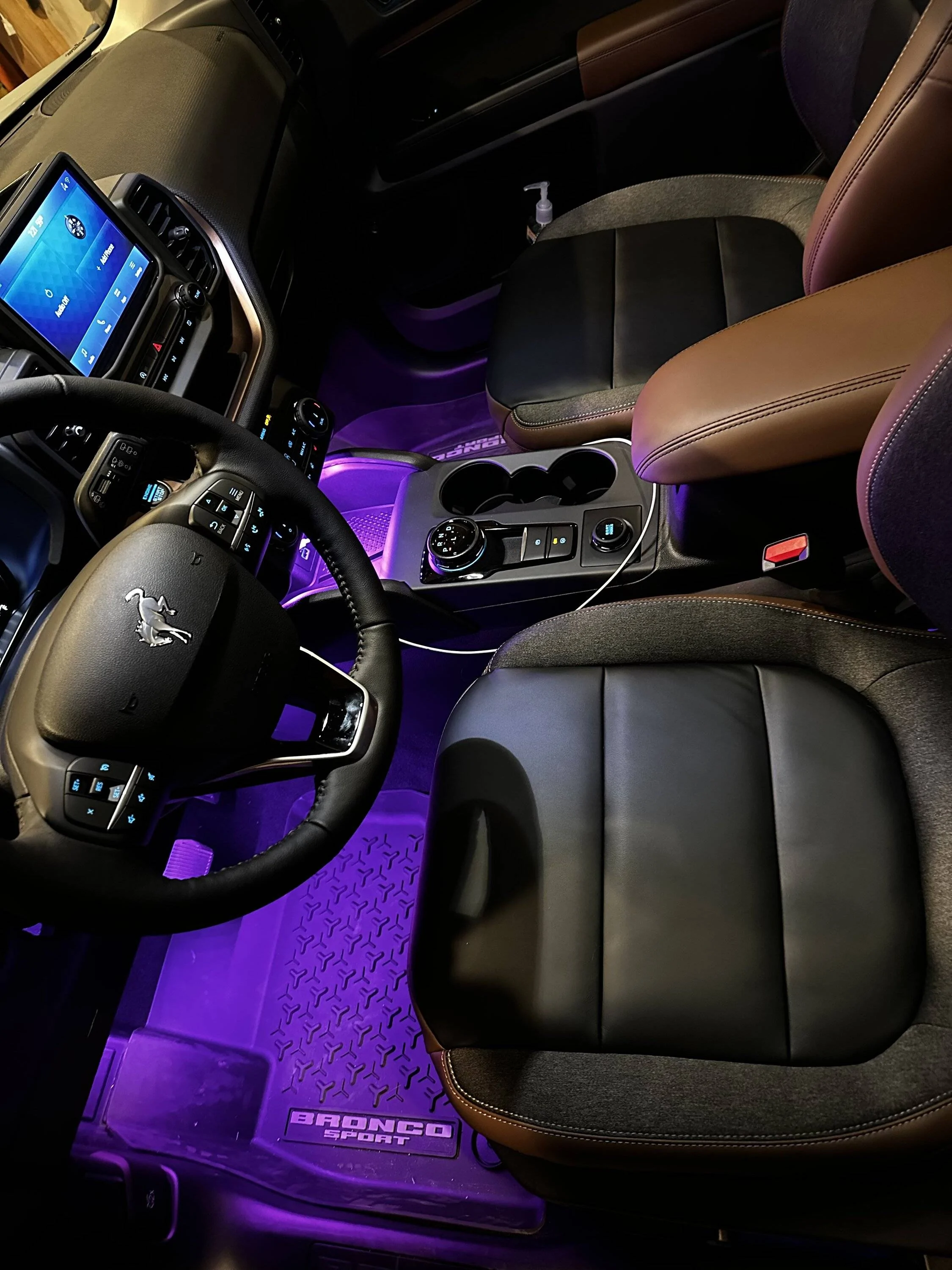

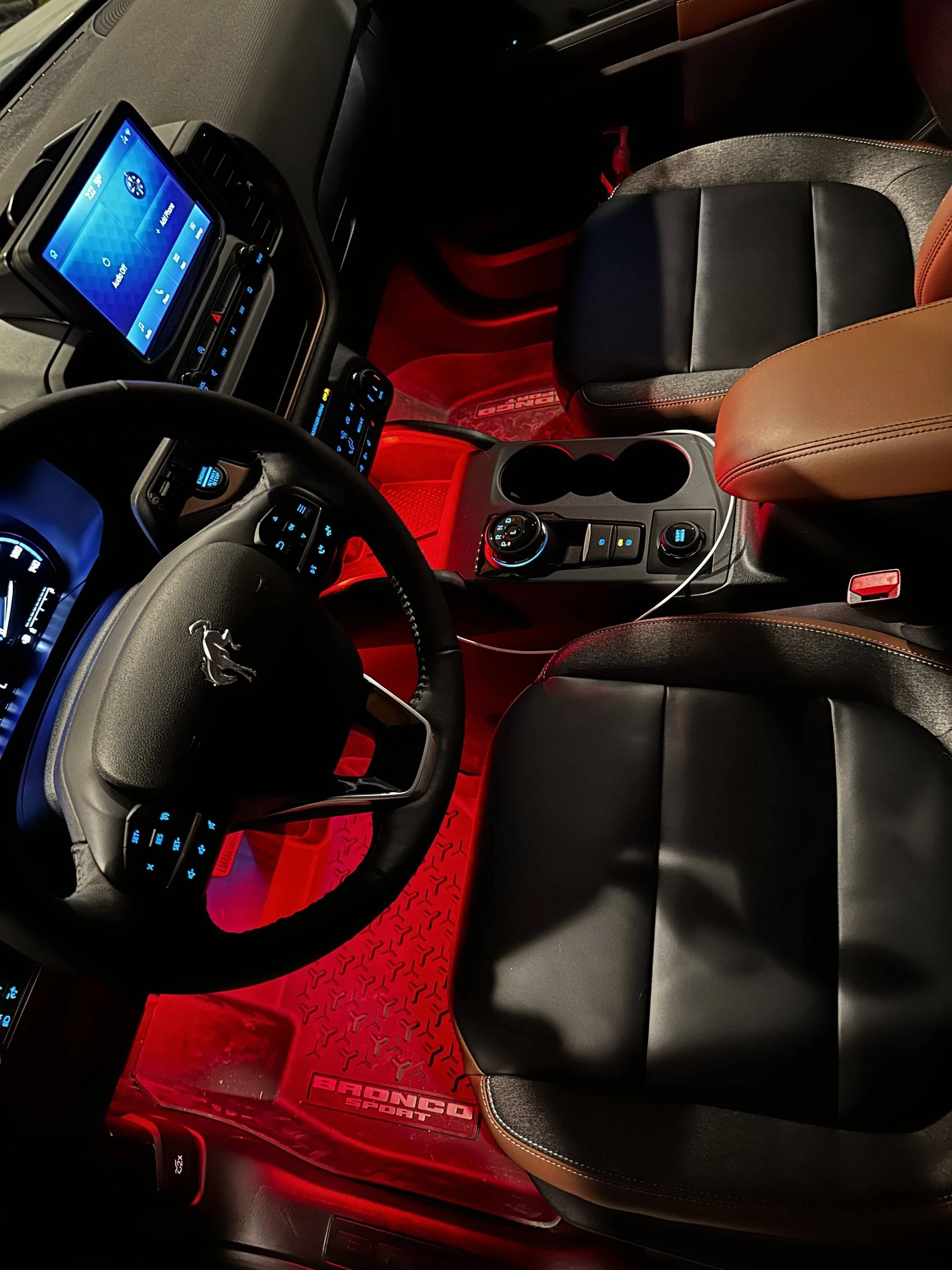

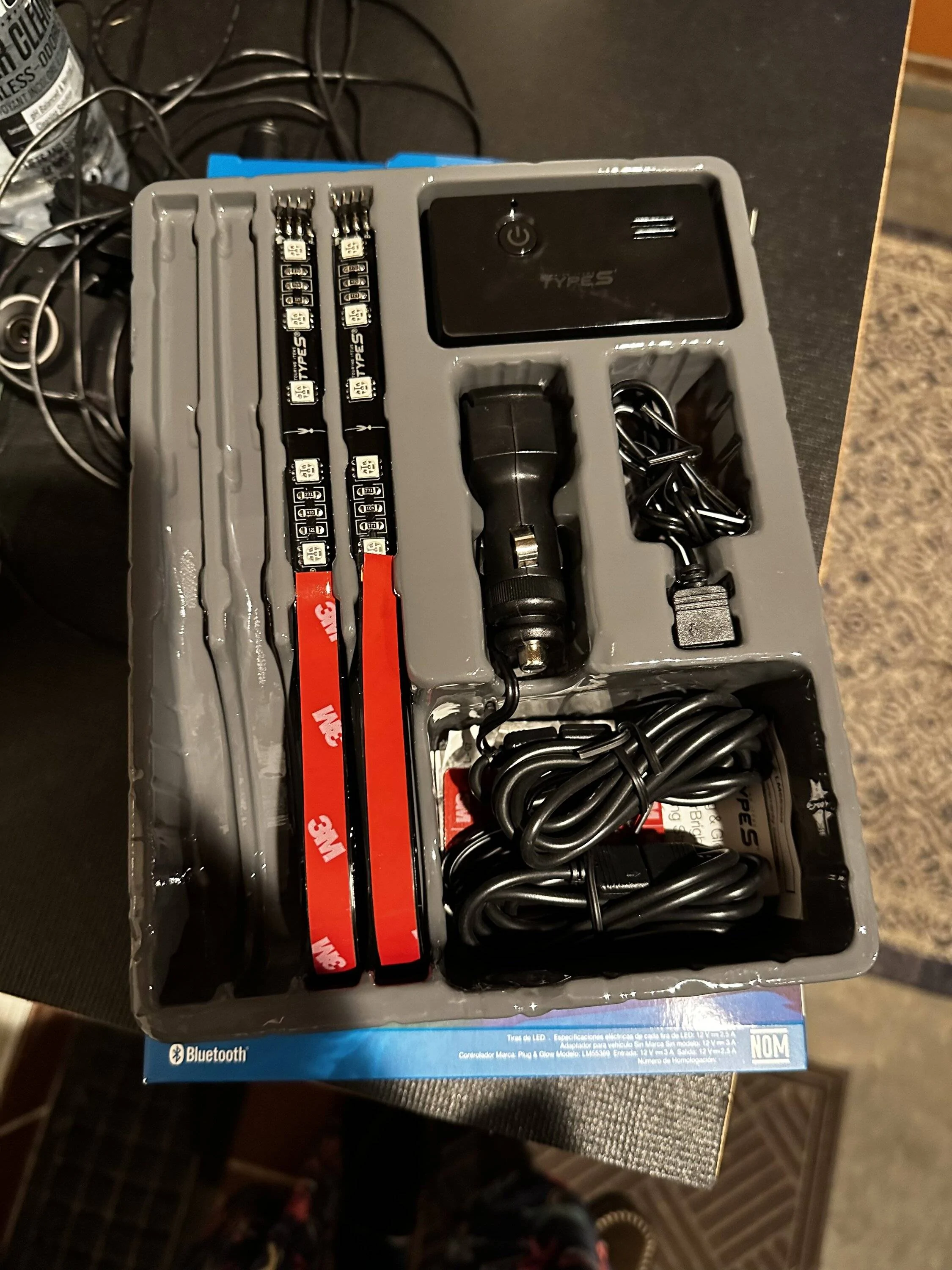

The ambient lighting that comes on the outer banks is very underwhelming and I find this interior to be very dark at night so I decided to add some light and style. You can customize the colors and modes and they come with a 12V connector and hardwire connector, I hardwired them to the fuse box using a fuse tap on fuse 3. I found these lights at auto zone and I had them in my last car.

Looks Good! I just may have to try this!
I say it’s totally worth it really adds a nice feel to the cabin and install wasnt too bad and it’s much easier if you just plug them into the 12V instead of the fuse box. If you want more pics of how I attached the light strips and hid the wires let me know.

I am curious how dim can it gets. I don’t want to really light up the interior all the time. Can each light have different color and brightness?
Thanks
Wings76
Wings76
Ryan
Jun 22, 2022
33
2022 Bronco Sport Outer Banks
Thanks
yeah the kit comes with a little control box that you plug the light strips into (then the control box plugs into the 12V) there are 4 different ports on the control box for 4 different zones, you can control them all together or separately to adjust brightness or color, my pics show max brightness but the minimum brightness is very dim that you can’t really even see the light. Here’s a screenshot of the app and the 4 different zones.

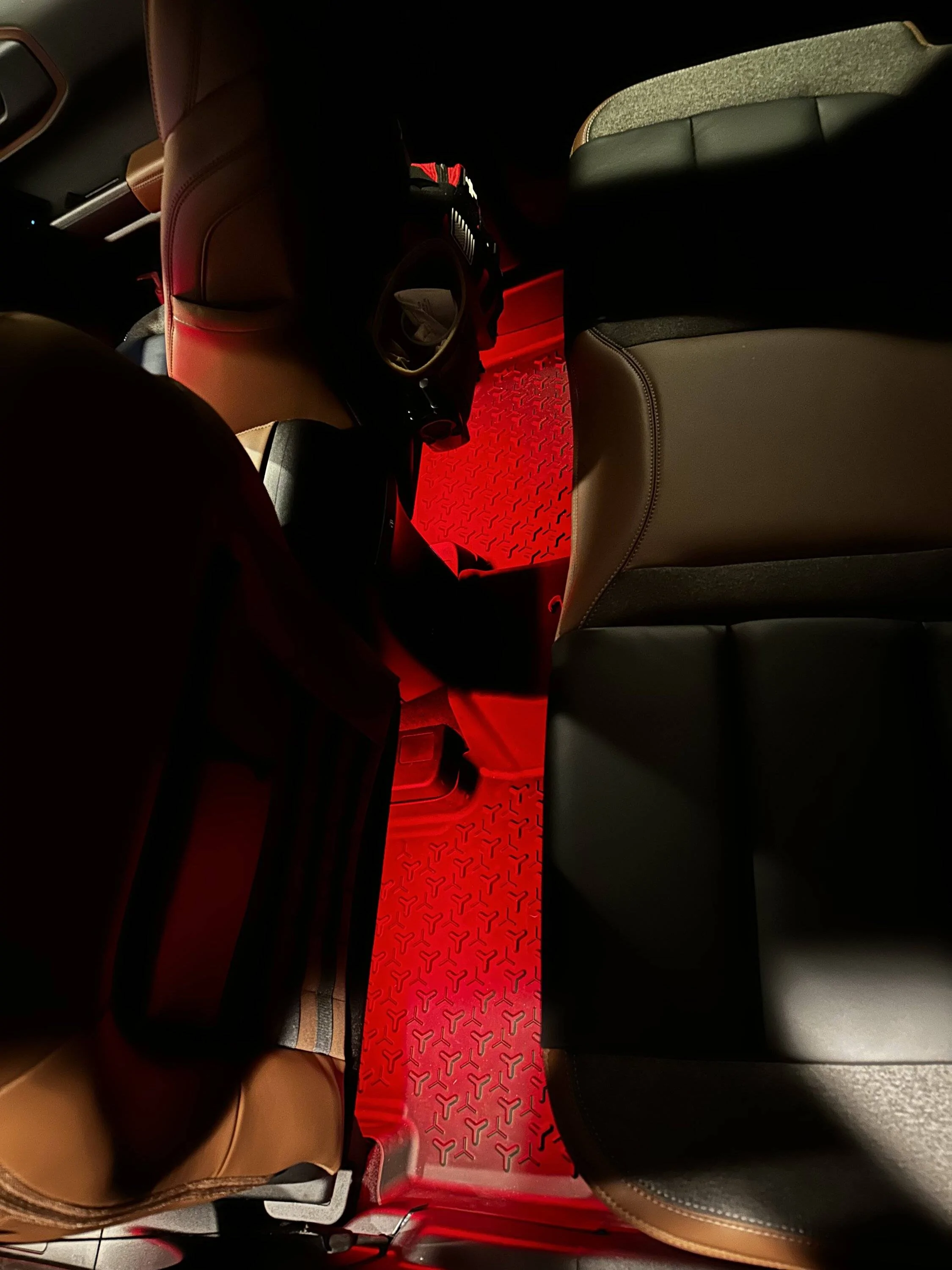

How did you apply lights and hide the wires? Ty
Wings76
Wings76
Ryan
Jun 22, 2022
33
The light strips have an adhesive backing so I used that for the drivers footwell and for the passenger footwell (under glove box) and under the the front seats (to light up the rear footwell) I used binder clips to hold them in place. The wires I just tucked under the center console where it meets the floor, it was pretty easy to push the wire up under there I used a little flat head screwdriver to help push the wire. I put the control box under the passenger seat so the wires just run from the front footwells along the center console to under the passenger seat.
