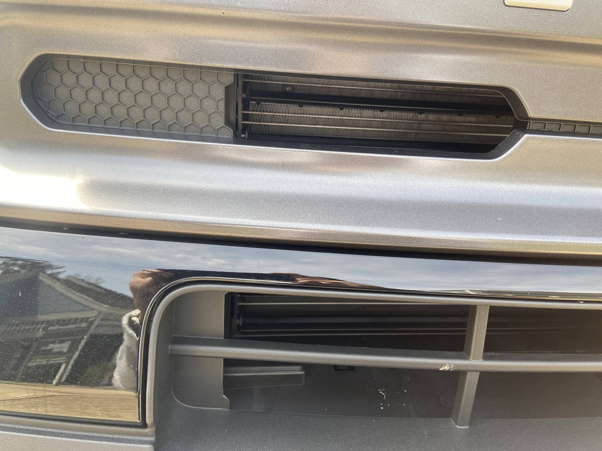

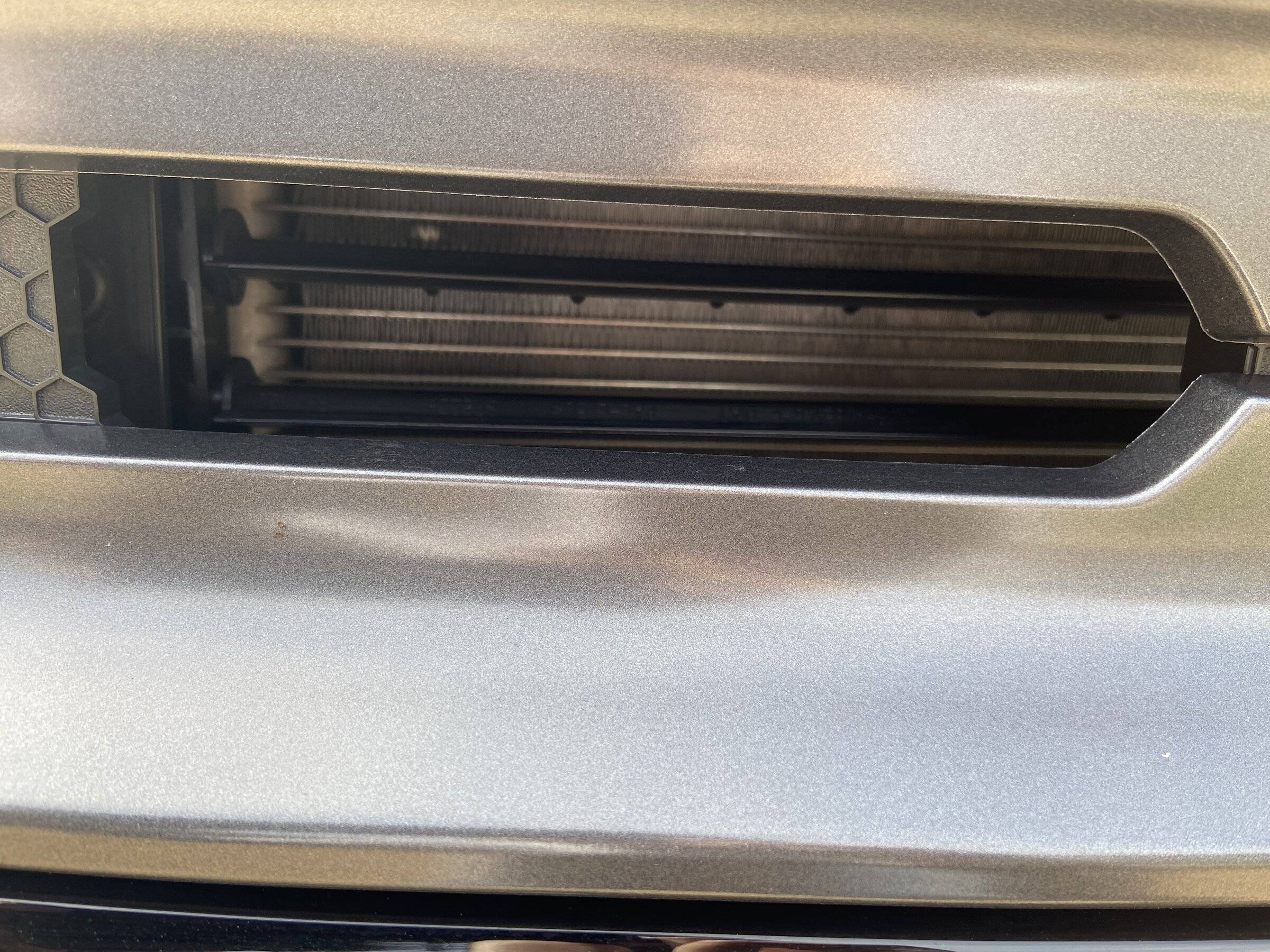

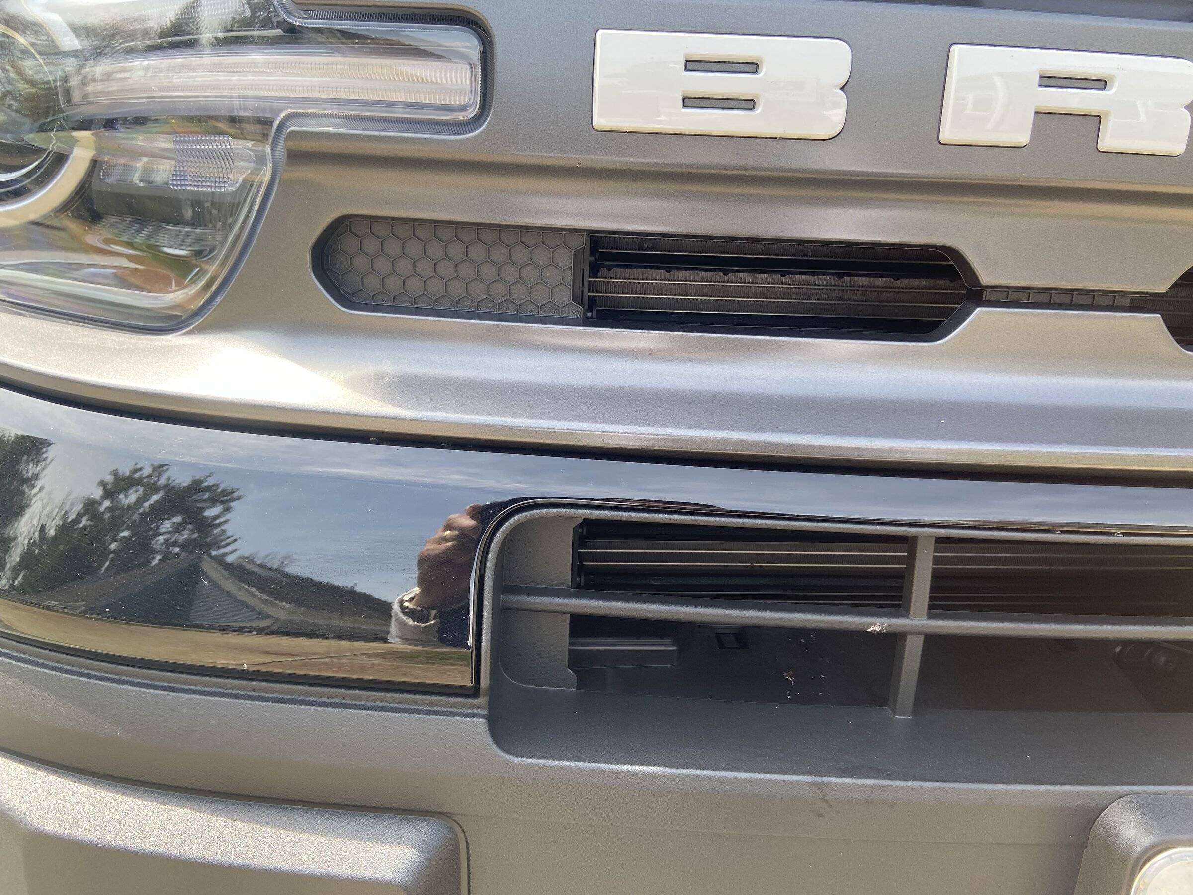

Thank you the explanation Mark S. I went out to the OB and saw the shutters. Thanks JAD67428 for the pics. Very interesting feature.

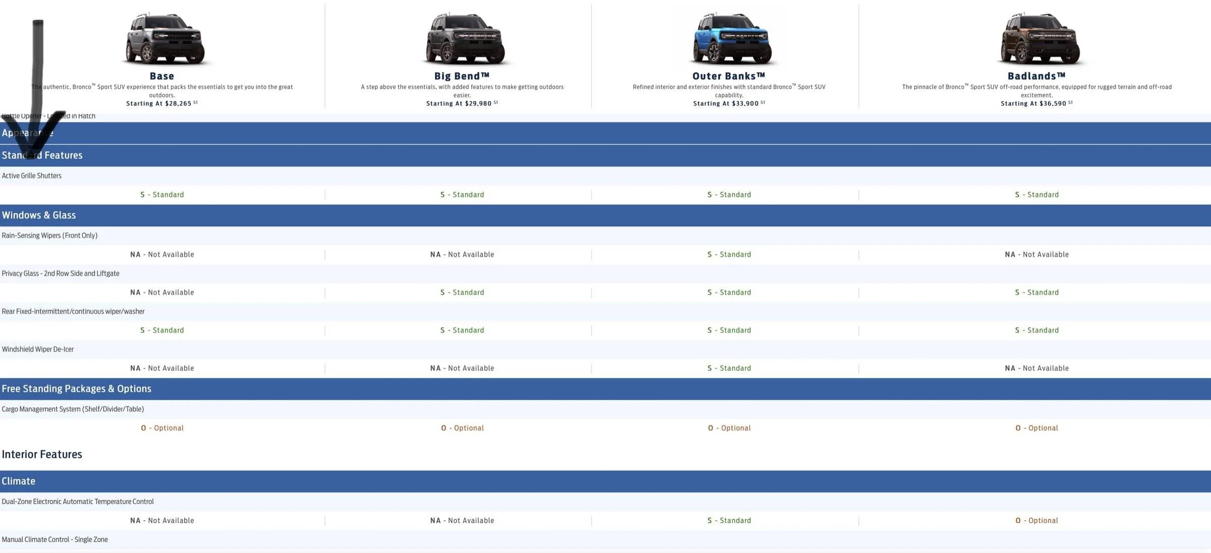

From what I could find online, "Active Grille Shutters open and close automatically to control airflow, reducing aerodynamic drag and improve fuel efficiency." How can one tell if they have this system on their BS?

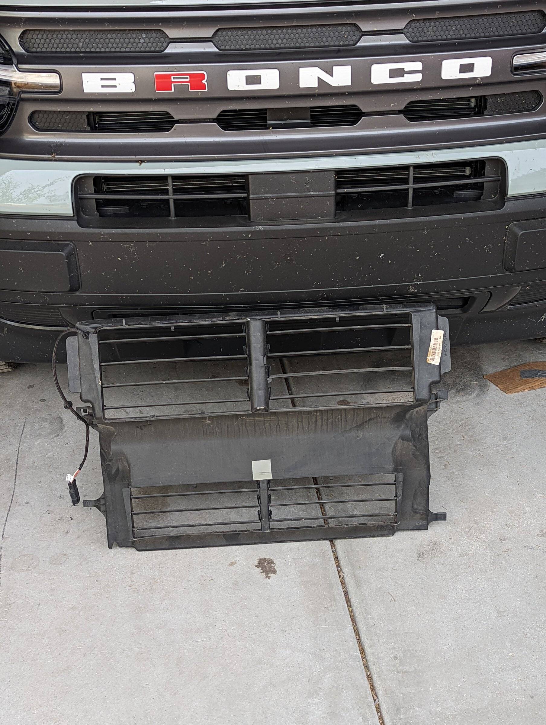

Here's a pic of a setup off a ST. They can fail and if there closed you will overheat. If there open your ok.
