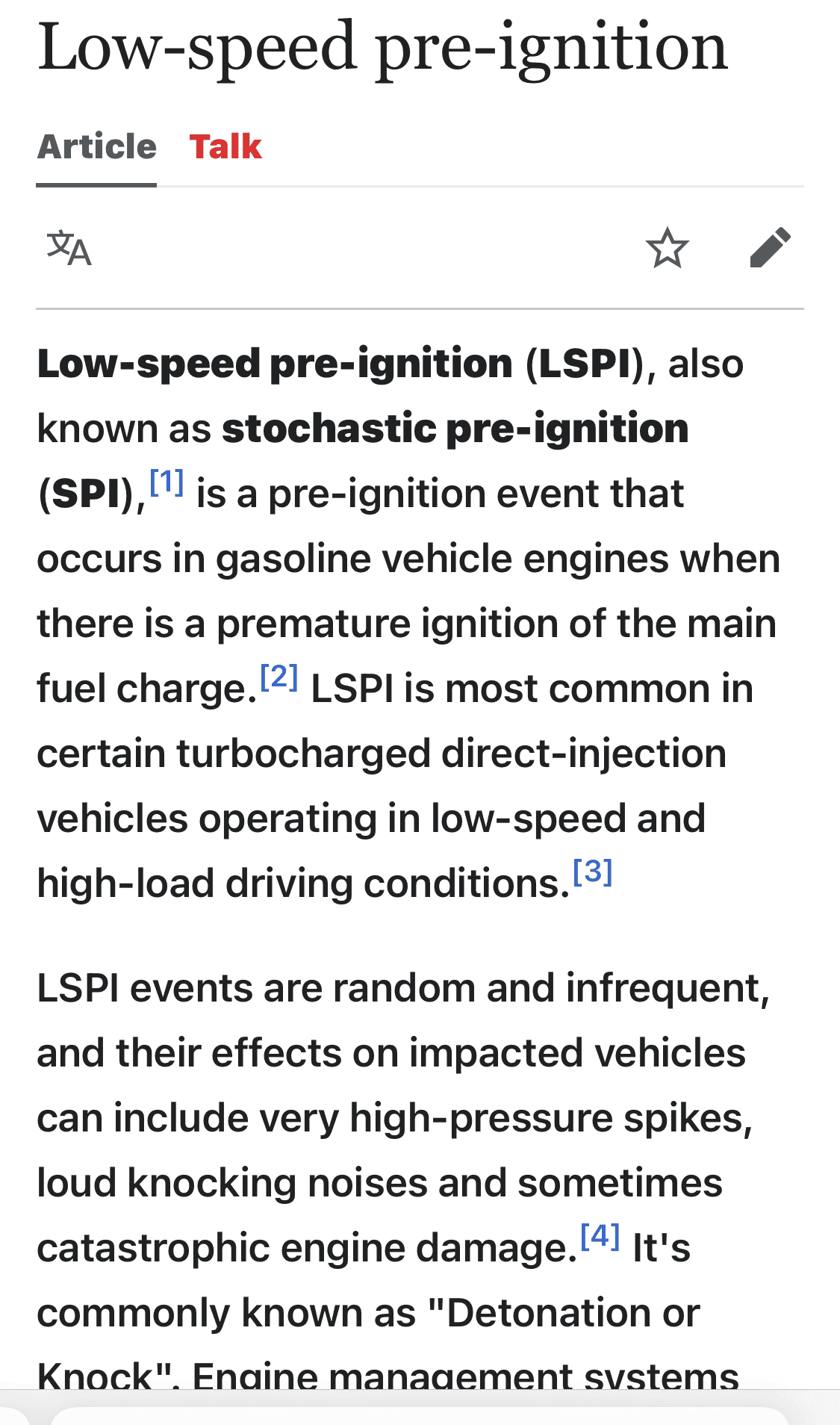

Wow, man... This plays into the definition of being pedantic and could be the lab exercise for a class on the subject.
https://en.m.wikipedia.org/wiki/Low-speed_pre-ignition
There are a wide variety and severity of pre-ignition events that are commonly called knock or detonation. It is flatly misinformation to contest my use of pre-ignition here.
Here’s an excerpt:

You continue to insist I'm being pedantic. That may well be true, but that's not evidence my argument is in error. This is a logical fallacy called ad hominem.
Your link to Wikipedia contains no new information. It merely reiterates that pre-ignition and detonation are commonly used interchangeably, which is something we've already established. All this proves is that you're not the only person confused about the difference between these two events. It's also dead wrong in at least one area:
Wikipedia said:
[Pre-ignition is] commonly known as "Detonation or Knock". Engine management systems can overcome pre ignition by the means of a knock or detonation sensor. The sensor will detect pre ignition and retard the engines timing to protect the engine from damage.
Pre-ignition does not generate the distinctive noise made by detonation. The noise made by a detonation event, often called ping, is the sound made when two flame fronts collide. In a pre-ignition event there is only a single flame front, and therefore no ping. Since there is no ping to trigger the knock sensor the PCM will not react to it in any way. This another reason why pre-ignition is so much more damaging to an engine than detonation.
You are free to believe whatever you like, but the difference between these two events is right there in the name: "Pre" ignition. Pre means before; the fuel/air mixture ignites BEFORE the spark plug fires. Detonation occurs AFTER the spark fires. These concepts are clearly illustrated in the video I posted. I encourage you to take a look at it.
