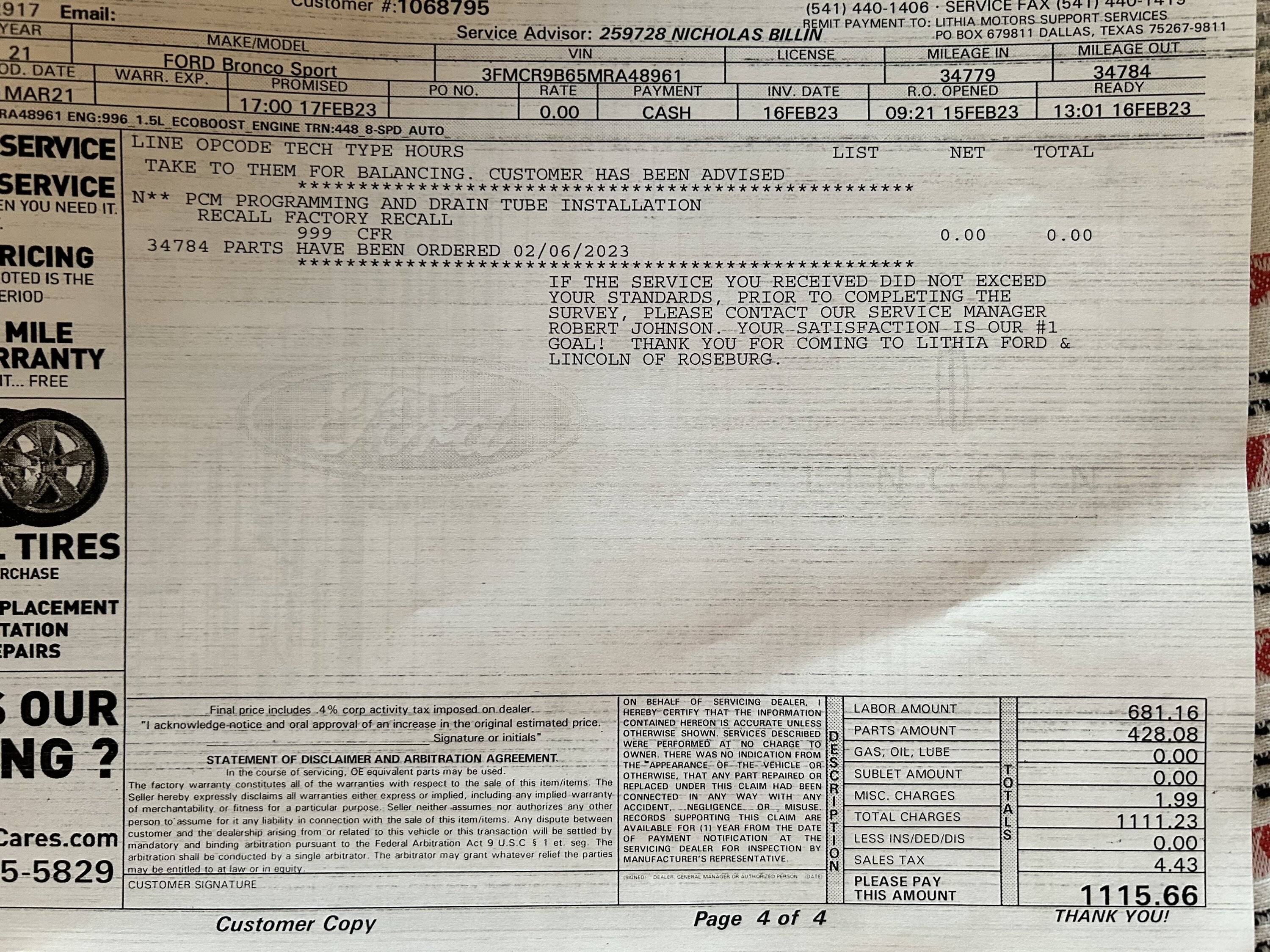

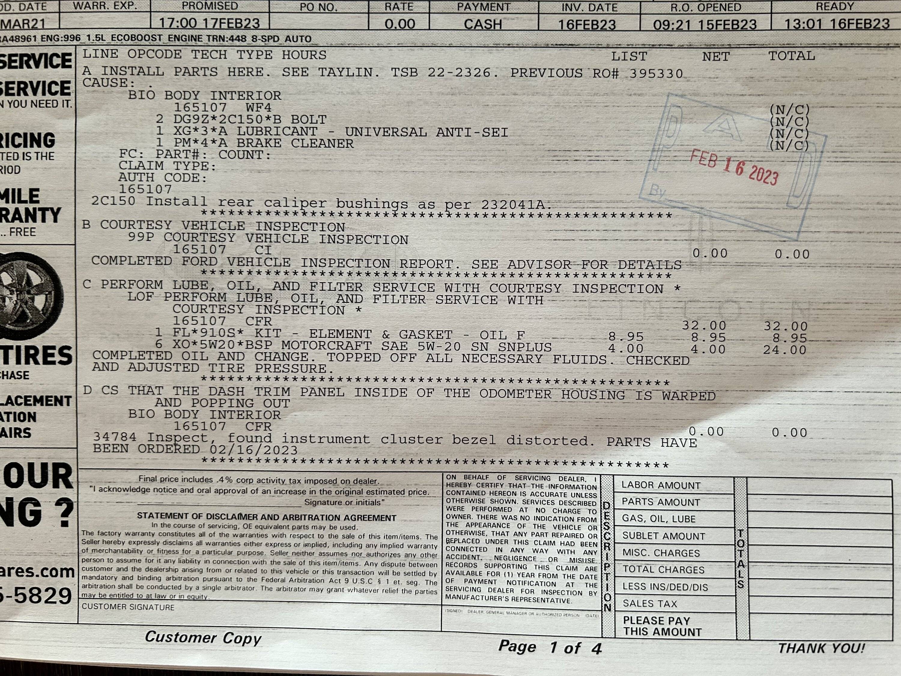

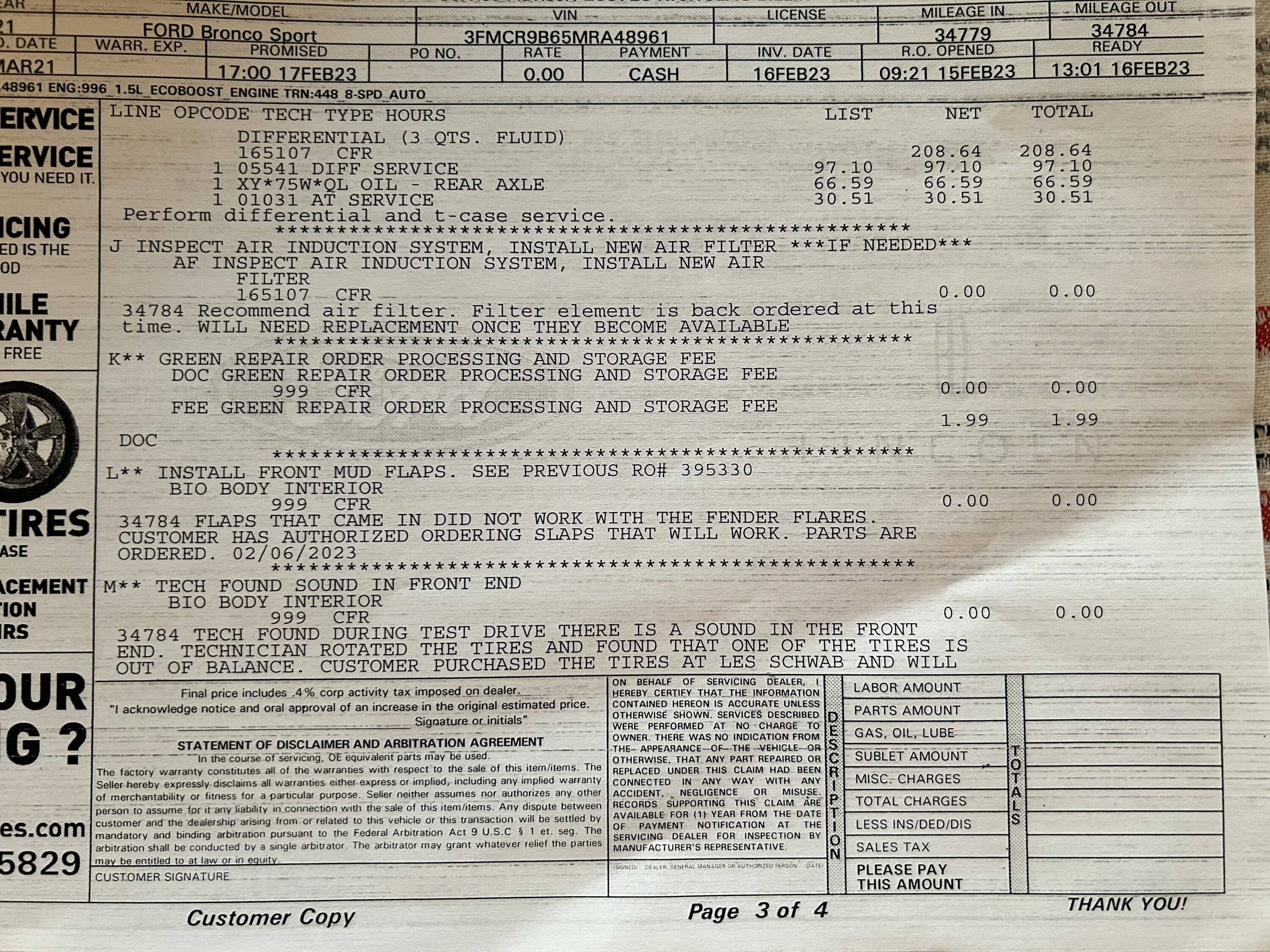

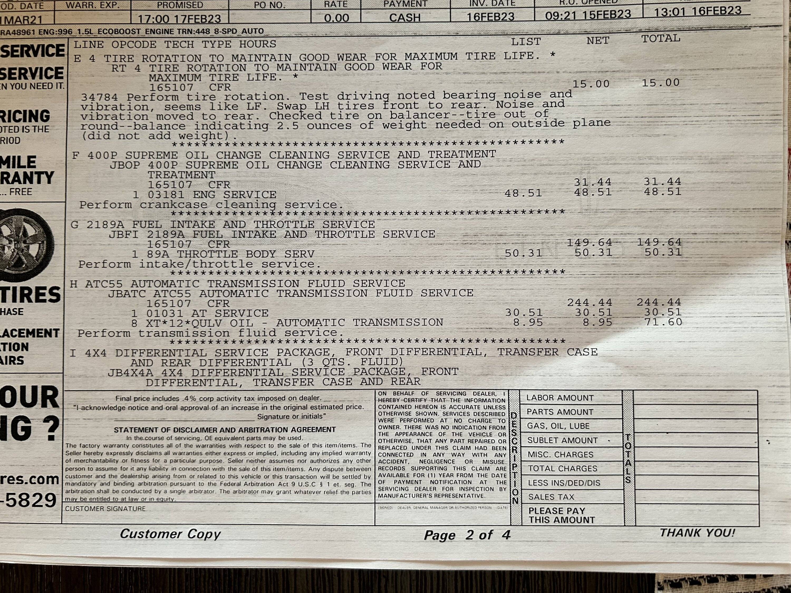

Sorry if I missed an earlier thread on this…but just picked up my 21 Big Bend from dealer. Finally got my parts in for the brake recall and some other minor issues like warped console cluster thingy, faulty mud flaps. While there they reminded me I was due for 30,000 mile maintenance service so I ok’d it. Can’t believe the cost on that service was $1,100 dollars. Is that what you all have experienced as far as cost? Trying to decipher all shop paperwork, but dang that price stings a bit.

Your dealer did quite a bit of additional work that isn't necessarily part of the normal 30k service unless the vehicle was used in severe duty or towing type service conditions.
It's not unusual for dealers to recommend or perform additional service items. I would think the service writer would have explained what their 30k service includes.
I wouldn't say you were ripped off, just some services were performed earlier in the service cycle than usual.
It's unfortunate the dealer didn't have the air filter instock, then at least you wouldn't of had to go back for awhile.
Assuming the services were actually performed, she got what she paid for. Only in that respect was she not ripped off. Replacing fluids in the transmission, front/rear diffs, and power transfer unit at 30K miles is not Ford's recommended service interval, and Ford NEVER recommends the "Fuel Intake and Throttle Service," so in that respect I would say she WAS ripped off. Performing services sooner that required is wasteful. Unless the inspection showed otherwise, the fluid removed from these components was still perfectly serviceable at 30K, yet it will go into the recycle barrel to be processed. If the inspection DID show these fluids required replacement then something is amiss with the components or @Inlandgirl's driving habits, yet I don't see that noted anywhere on this invoice.
This is a cautionary tale: Do not give your service department carte blanche to do whatever they want during "scheduled" service visits. Ask to see Ford's recommended service requirements and compare it with what they propose to do. I would question ANY service items not recommended by Ford. Remember that "inspect" does not necessarily mean "replace," but it may. For example, if they inspect the transmission fluid the tech may determine it needs replacing. Make sure you instruct your service writer to contact you BEFORE performing any maintenance they deem necessary based on an inspection. You should understand WHY the fluid needs to be replaced earlier than recommended. You may even want to have a look at the fluid yourself.

30k transmission fluid change is actually in the Special Operating Conditions section of Scheduled Maintenance in the owner's manual. Saw that last night.
That should not be assumed, however, by the shop. I didn't see anything on the invoice suggesting the shop was using the Special Operating Conditions schedule, and I think @Inlandgirl would've told us she requested that schedule if she had.
That's a pretty bold statement.
I would say the dealer should have been more transparent in what their version of the 30k service entailed. I also think the OP, could have been more inquisitive and or had more of an idea of the service expected.
Unfortunately the experience ended up leaving a bad taste because of the sticker shock of the service bill.
I'm not defending the dealer or the OP, their were errors on both sides.
Taking it as as a learning experience, the OP can choose other options for future service's or even perform some of them on their own.
