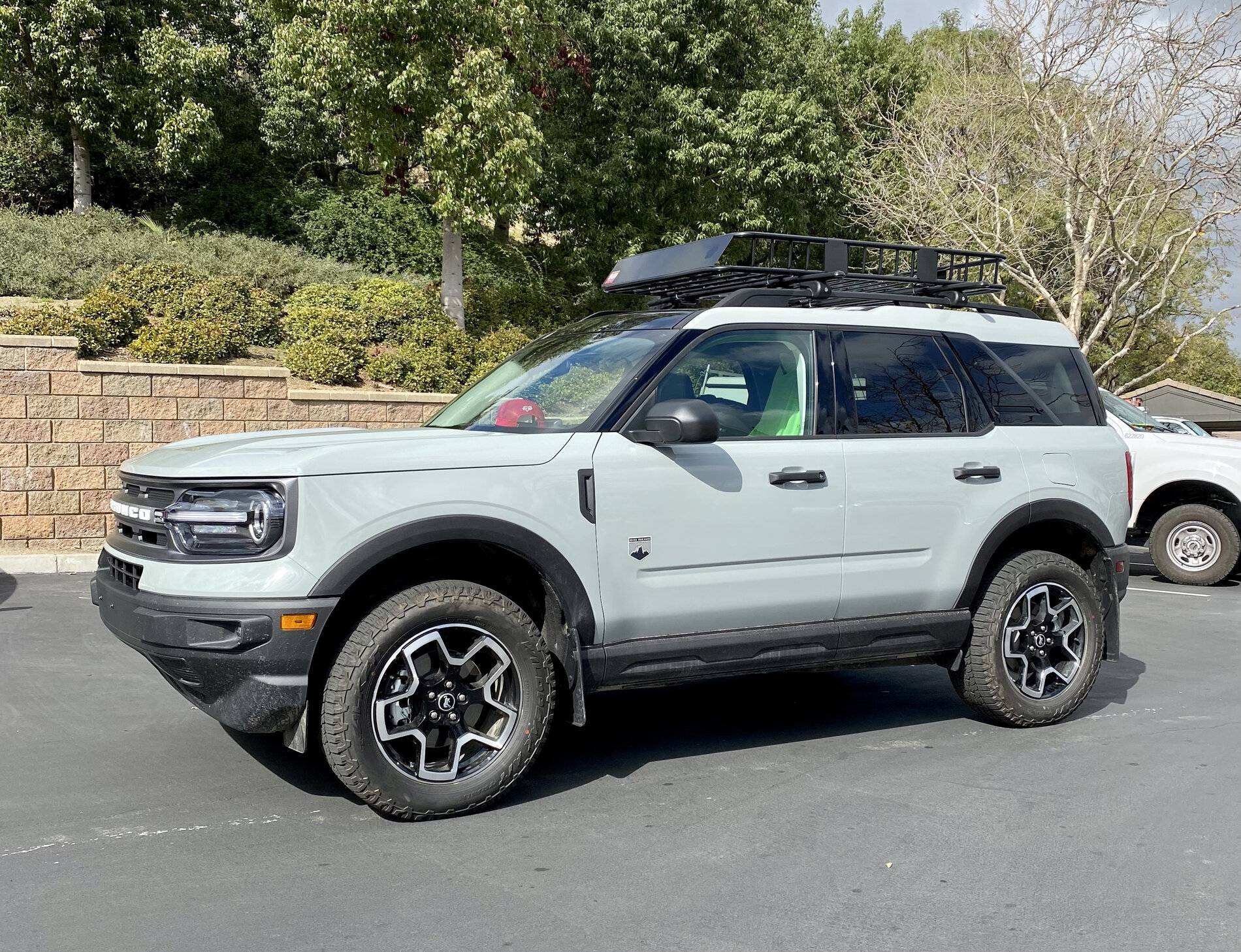

Correct, no lift in this picture. I do have a 1.5” lift on the car now though. See below
Ford Bronco Sport 245/60R18 tires fit no rub on Bronco Sport! 6213B481-199E-47A6-8DDF-D329E6A62CBA
Please please please take off the sway bar end links from the rough country kit. Both mine and another forum members have snapped. One of my brackets fully snapped off and the other bent.
you can put the oem ford links back in safely and the car handles better. If you don’t take them off make sure you are on road or have a good off ride recovery/tow truck.
do you notice a very stiff ride and rattling/bouncing over bumps now?

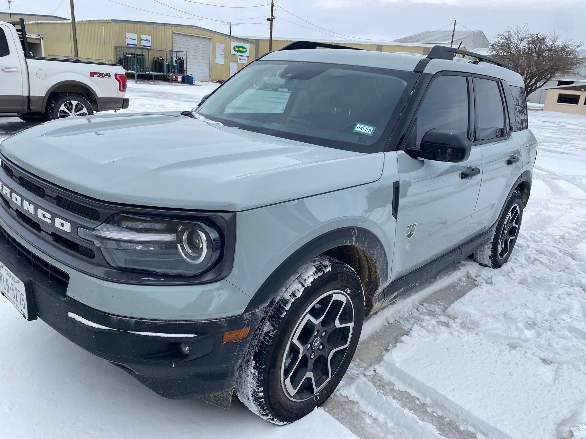

We're about to be twins! I have mine installed 2/19. Thank you for your post! It helped me decide what i wanted!
Ford Bronco Sport 245/60R18 tires fit no rub on Bronco Sport! 272835999_977488159794042_4434789288411287036_n
