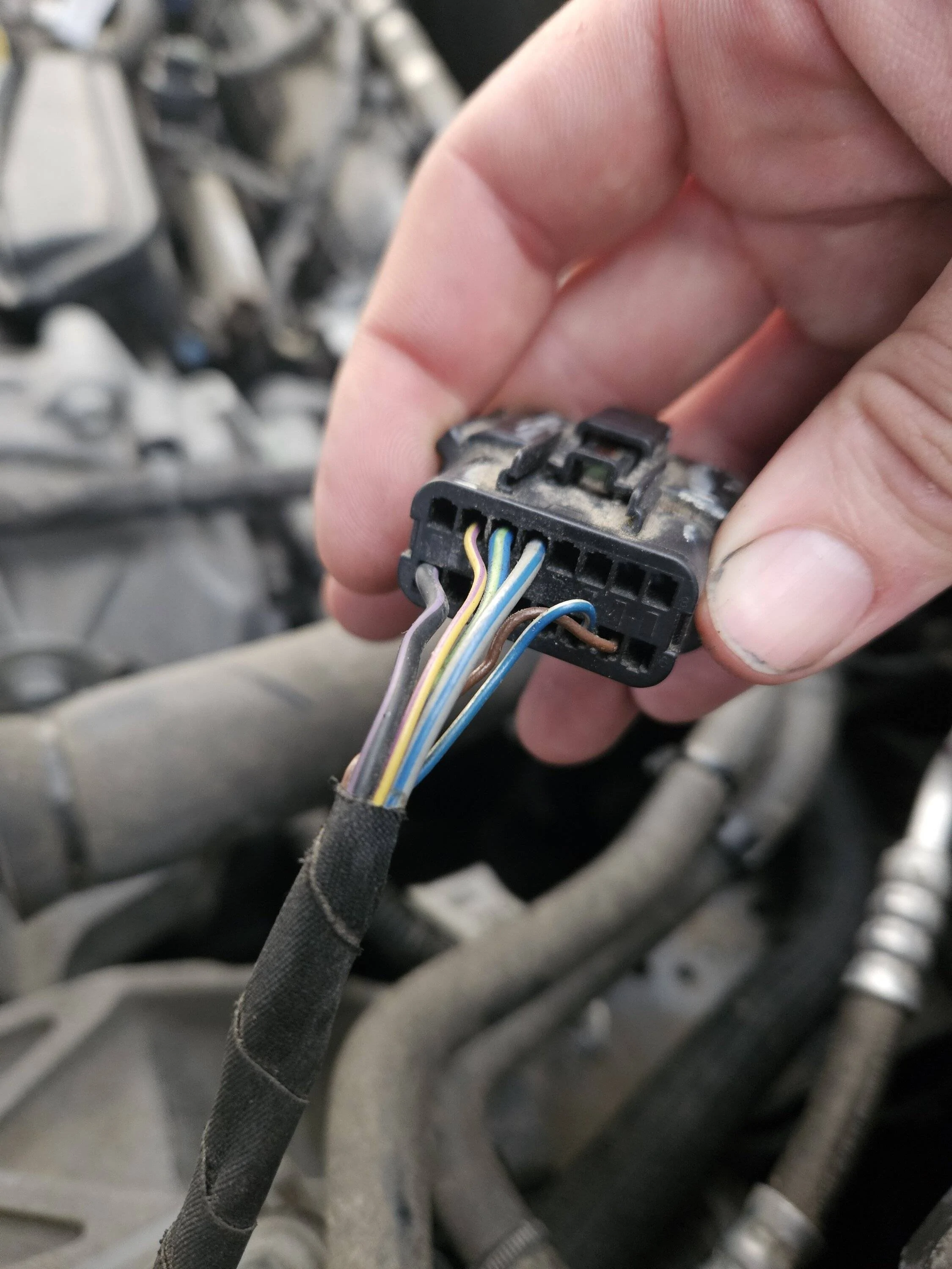

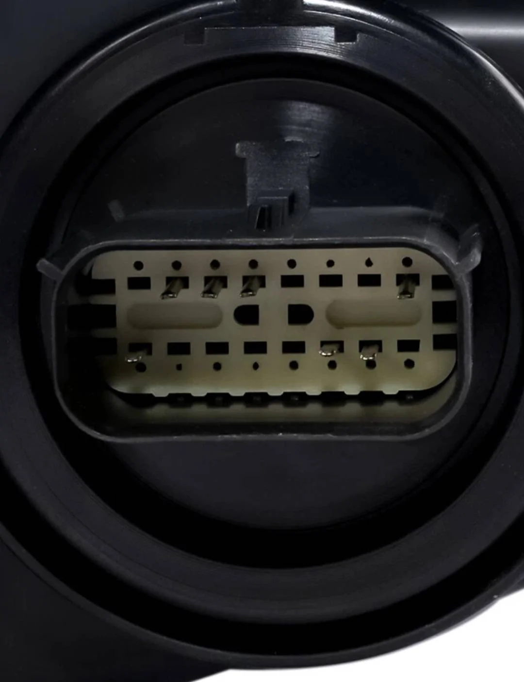

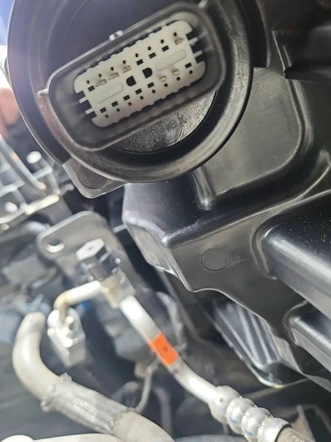

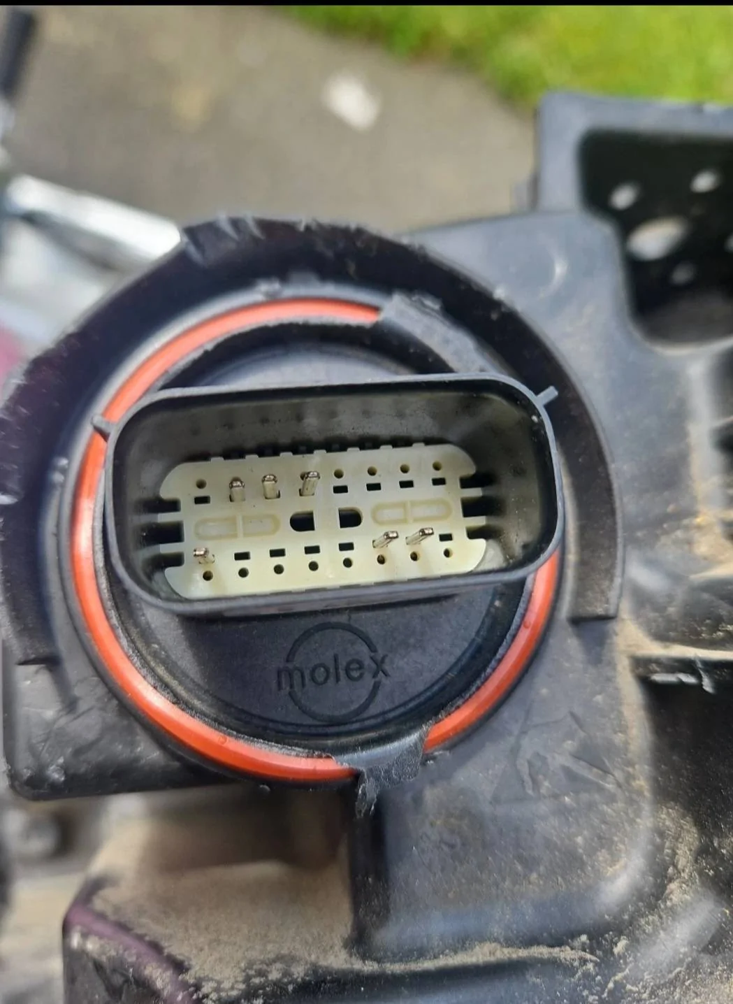

A deer ran into my bronco a month or so ago, broke the plastic for my passenger headlight and dented up the side panels. Drove it around with tape until 2 weeks ago the entire headlight went out.
Thinking there was only one headlight assembly for the bronco sport, I purchased one off ebay. After swapping the headlight out and testing it...it did not light up. Looking at the headlight pins, turns out the pins on the headlight do not line up with my harness.
Photo #1 is my original headlight
Photo #2 is the headlight I bought off ebay
Photo #3 is another headlight I found after finding out headlight #2 did not work
Photo #4 is my harness
So my questions are... why are there different headlight pin patterns? Is there any way i can get headlight #2 to work with my harness? I've done small electronic and solder work, so I am a little familiar with replacing connectors and headers. I just have no idea which wire would associate with the pins on the new headlight.
If i can't get headlight #2 to work I have the possibility of sending it back for a refund. If I purchase headlight #3 I am hoping it would work?? I'm just confused why there are 7 pins instead of 6. There is an extra pin on the top right of headlight #3 that my harness has no wire associated with it. Would it still work?
I've searched google for an hour and couldn't find any diagram for the harness wires. Does anyone have experience with this?

So would it be possible to move the lower left pin to the top right to match the headlight? Or are all the pins connected to the wrong wires in my harness? For the 3rd headlight, why does it have 7 pins?

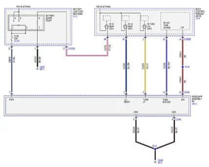

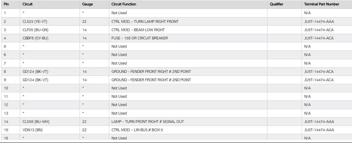

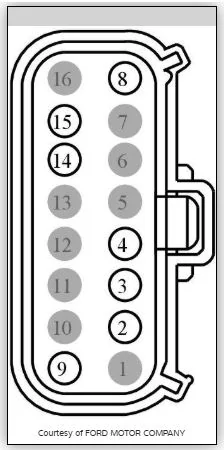

Attached are pics of the RH headlamp connector and pin out info. Hope this helps.
Ford Bronco Sport '21 Sport Big Bend headlight harness pin layout? 1000016903
Ford Bronco Sport '21 Sport Big Bend headlight harness pin layout? 1000016904
Ford Bronco Sport '21 Sport Big Bend headlight harness pin layout? 1000016902
Ford Bronco Sport '21 Sport Big Bend headlight harness pin layout? 1000016905
Ford Bronco Sport '21 Sport Big Bend headlight harness pin layout? BS C1041 Pin Out
Ford Bronco Sport '21 Sport Big Bend headlight harness pin layout? BS RH headlamp diagram

Thanks so much for the images! Will swap the ground location after work. Will update when done :)
Snooter
Jun 17, 2025
NY
Just moved the ground wire over to the corresponding pin during lunch break. The light turns on! Thanks everyone for the help!

The BCM wiring diagrams shows the BCM has Field Effect Transistors (FETs) which drive the signals you are referring to
worst case is you blew out one or more of these transistors and best case the lines are fused so only a fuse (or possibly is a circuit breaker) needs to be corrected (I don’t recall exactly)
however you did say you already tried swapping fuses but you also may want to separately verify the fuses are good by removing from the vehicle and testing the fuses
Do you have access to the wiring diagrams? Others on this Forum have purchased the wiring diagrams (and may respond to you) or you can search on this Forum for the recommended vendor (Internet website) to purchase this
And I do see Post #6 shows fuse on some of the wires but I didn’t study the diagram carefully to match up with the signals you referred to above and also shows the transistors but the posted diagram isn’t very clear
( I don’t see pins 4 and 14 shown in the schematic diagram in post #6 and in the table pin 4 shows as CBBF8 (GY-BU) not blue/white as you stated above )

Pin 14 is a lamp outage circuit which may not indicate on a multimeter. However pin 4 gets its power from a 25a fuse, # 158 in the battery junction box. I would check there.
beaudointl
Sep 17, 2023
54
Ontario, Canada
Also, pins 8&9 are your grounds. When checking for power it is always advisable to do it with a test light vice meter to ensure the circuit can actually carry a load. A meter will work in a pinch, especially since you are showing 0v.
