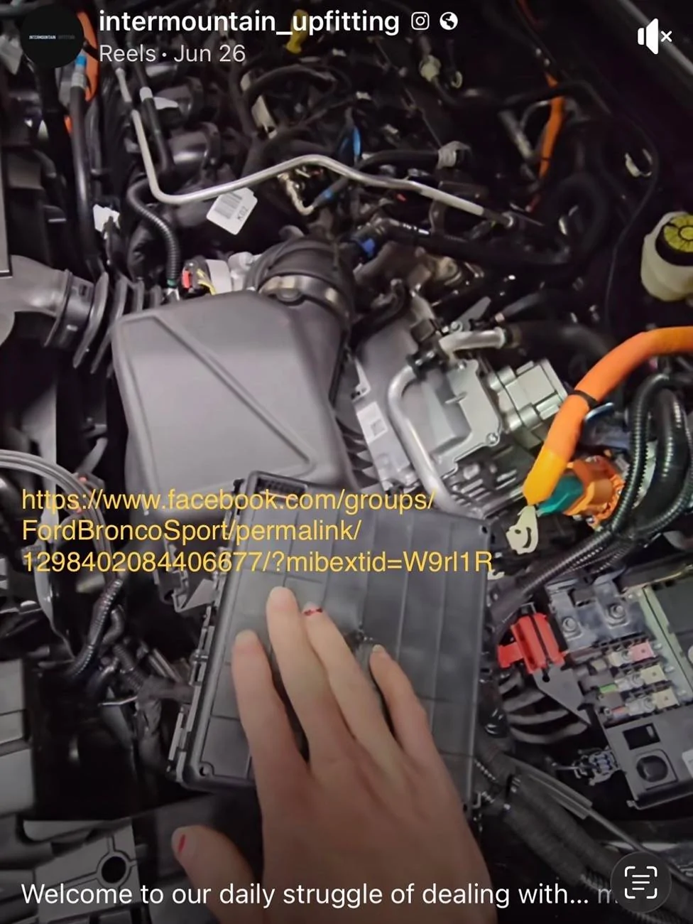

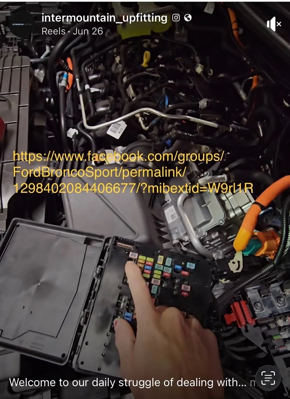

Look in the engine compartment- the big fuses (maybe a circuit breaker too IDK) is in the engine compartment

I'll try and get you a BJB pic and location.

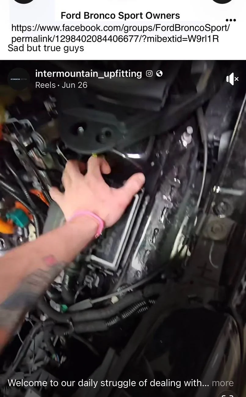

Pics for reference to the engine compartment fuses and diagram is there too
Ford Bronco Sport '21 Sport Big Bend headlight harness pin layout? IMG_7707
Ford Bronco Sport '21 Sport Big Bend headlight harness pin layout? IMG_7708
Ford Bronco Sport '21 Sport Big Bend headlight harness pin layout? IMG_7709

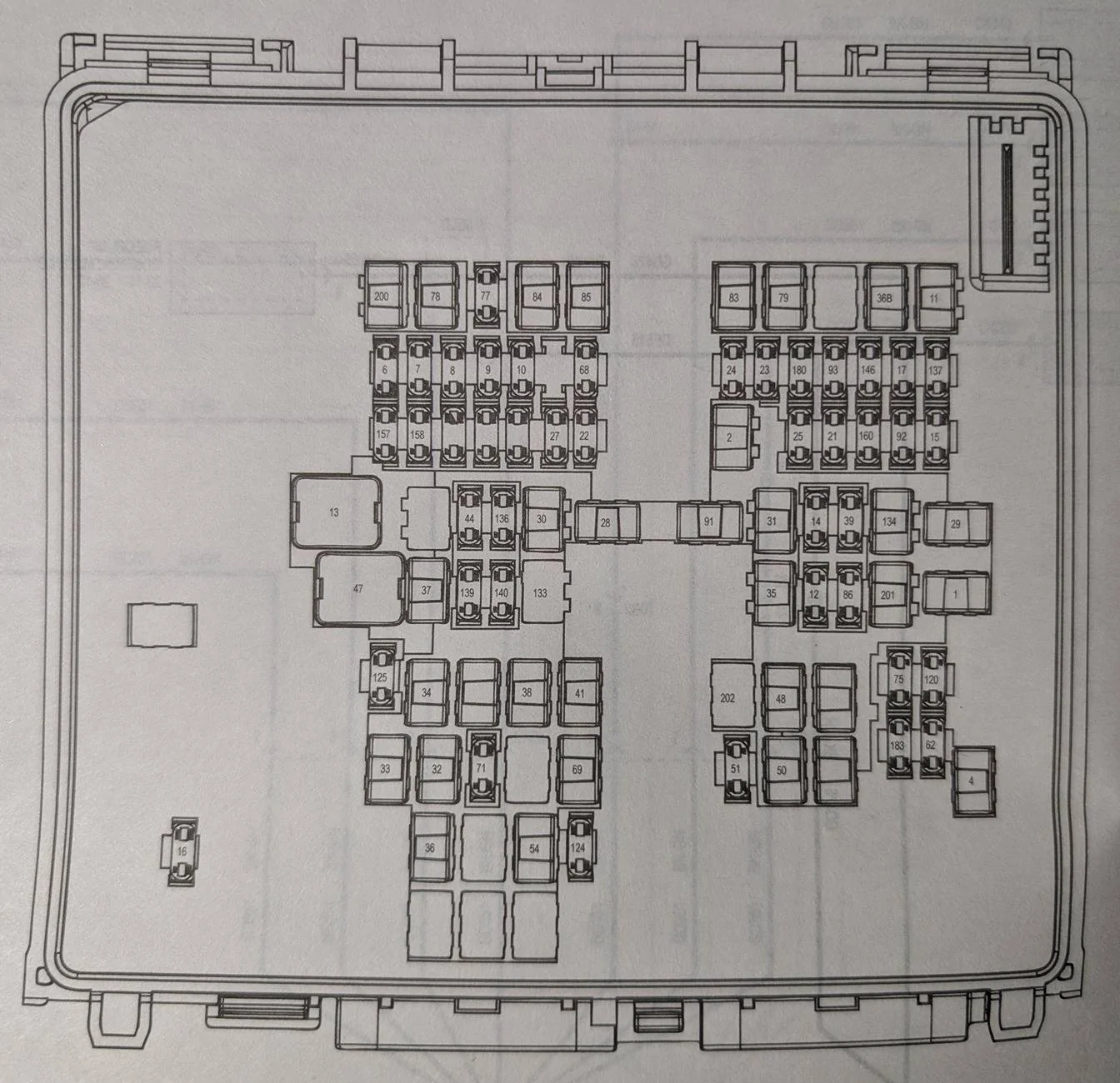

Fuse 158 powers the RH headlamp. In the pic, it is in the top left, second row of the smaller fuses. Hopefully you can zoom in to see it.
Ford Bronco Sport '21 Sport Big Bend headlight harness pin layout? PXL_20250630_220413523~2
Okay yeah in my owner's manual that is #25. Thats the one that's giving an issue reading 0v even with a new fuse. Thank you for helping me though.
