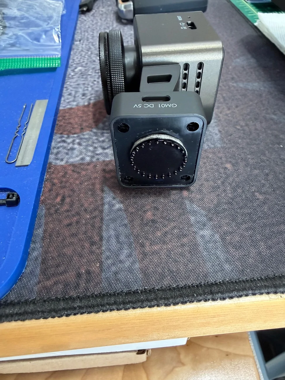

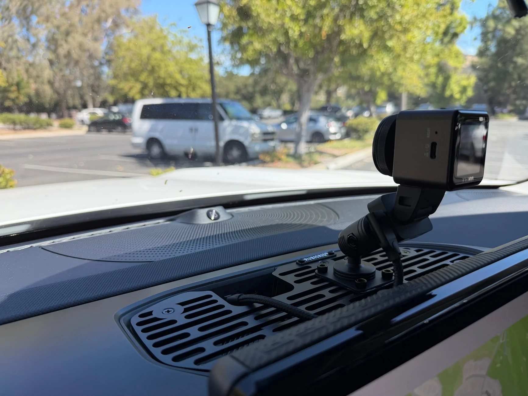

Well I solved it myself!
Bulletpoint Rubigrid with ball mount
Bulletpoint dashcam arm and magnetic attachment
Vantru E1 Pro
Short right angle USB cable
Works perfectly and shuts off when I turn the car off when connected in the left USB slot.
No issues with heat.

Mine still gets pretty hot, more than I would like.
Maybe more vent holes would help.

It does if parked in the sun. I put a UVS100 sun shield up if parked.. I don’t use parking mode. I am still playing with positioning to make putting the sun shield up easier.
