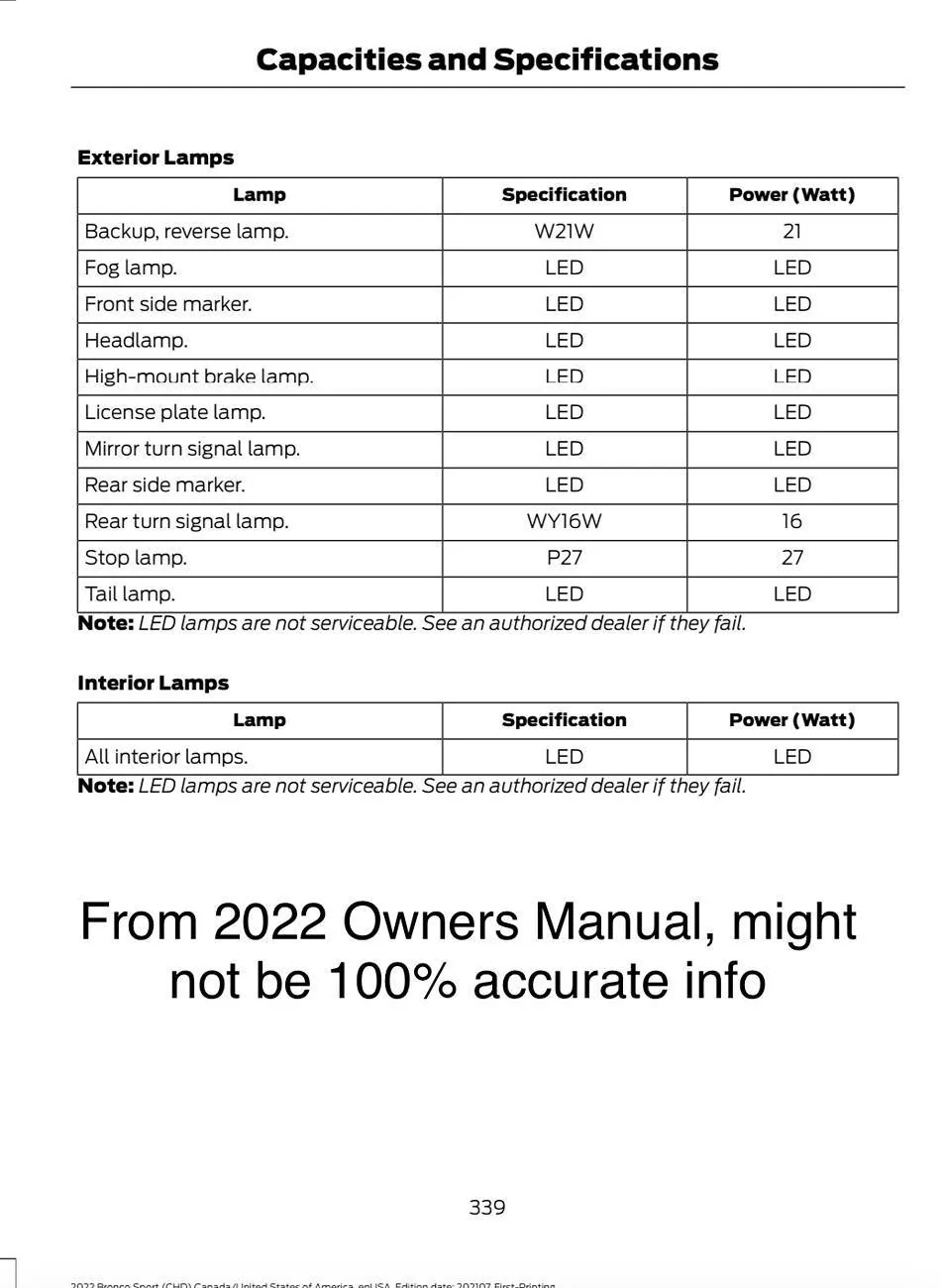

Headlamps are not serviceable and if failed have to be replaced as a unit. Other owners had this done for around $1,500 which while about half the cost of your quote is still far too much.
