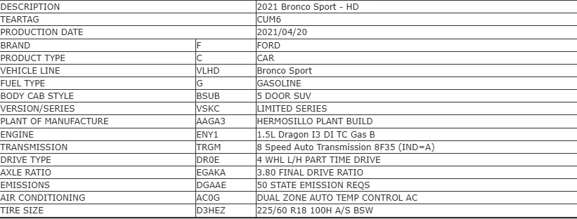

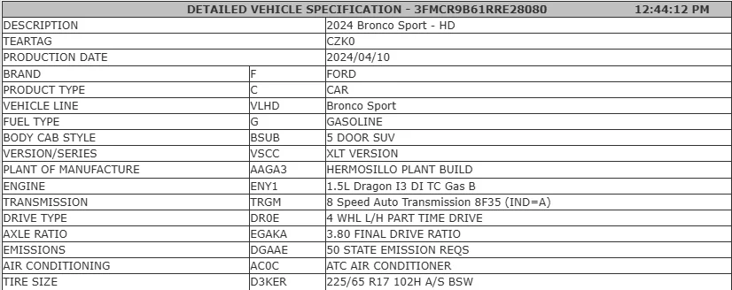

Below is the response from a veteran heavy line Ford tech:
I honestly don't know. There were some changes, but I'm not sure if it's anything significant enough to not make the swap work.
The big changes didn't happen until 25MY. After build date 11/11/24, they changed a lot including the block.
So it should work. If the engine is coming off of a 2024, chances are that is was built before that date. If you can get me the VIN of the BS the engine came out of, I can check to confirm.

VIN for the 24 3FMCR9B61RRE28080

My vin is 3FMC
Not sure why it doesn't show the engine calibration for yours, but also not sure how relevant that is. Engine type is the same.
Ford Bronco Sport 2021 BS 1.5L engine options 1788541318564-58
Ford Bronco Sport 2021 BS 1.5L engine options 1788541343805-87
I just looked through the ab data and it does not seem like the VIN is stored in the PCM. You should be able to use the same one in your current vehicle.
I still can't say it will 100% work without a shadow of a doubt, but on the surface, it looks like it will.

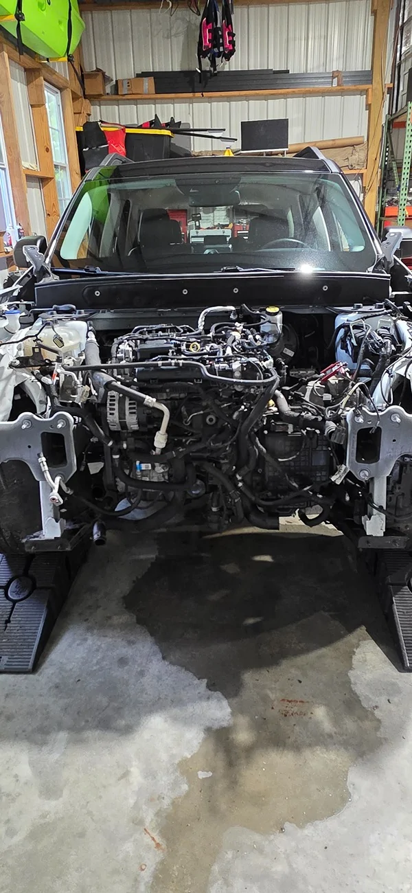

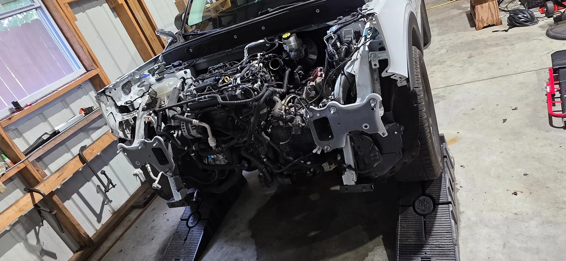

Here is today's progress I got about 3 hours of work in. Decided to go out the front as i dont have a lift. is the unhealthy sound current engine is making.

I miss the days of swapping engines in my driveway.
Who am I kidding? I just miss being in my 20's. 😂🤣
Good luck!
