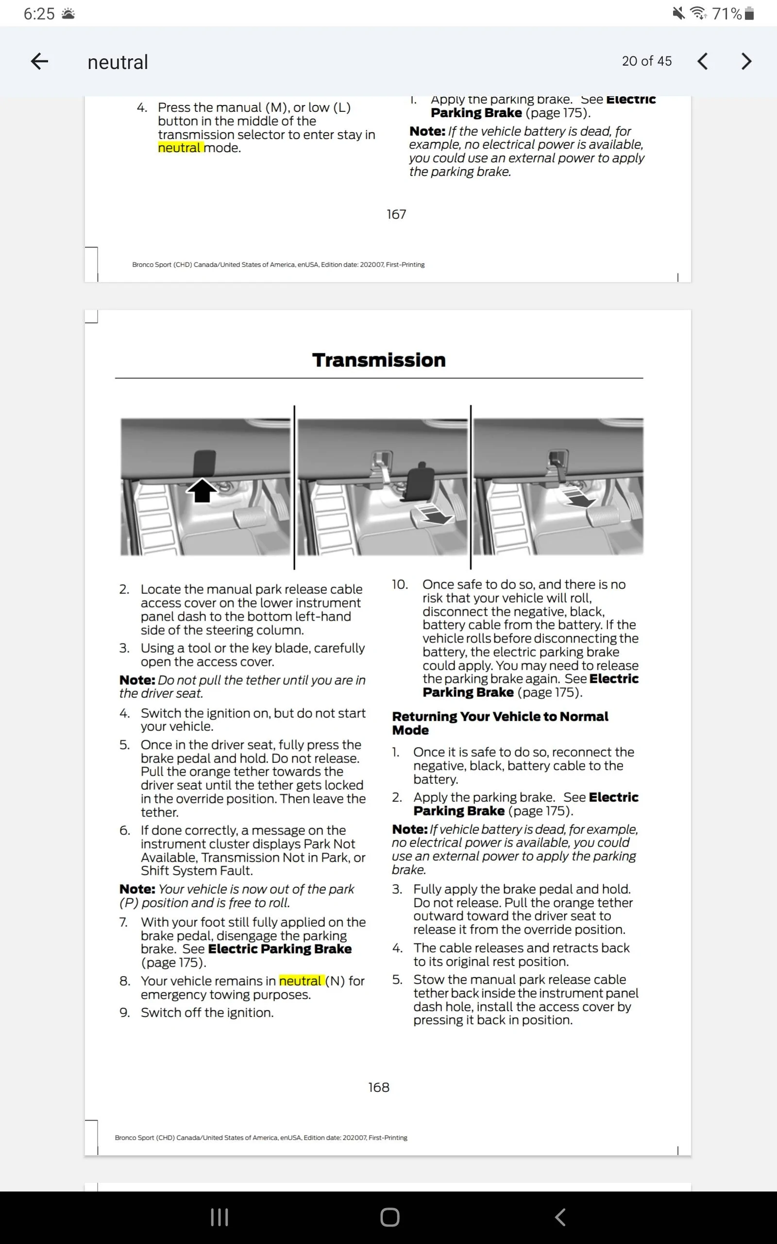

Ford Bronco Sport 2021 Big Bend just quit suddenly Screenshot_20230819-182518_Drive
