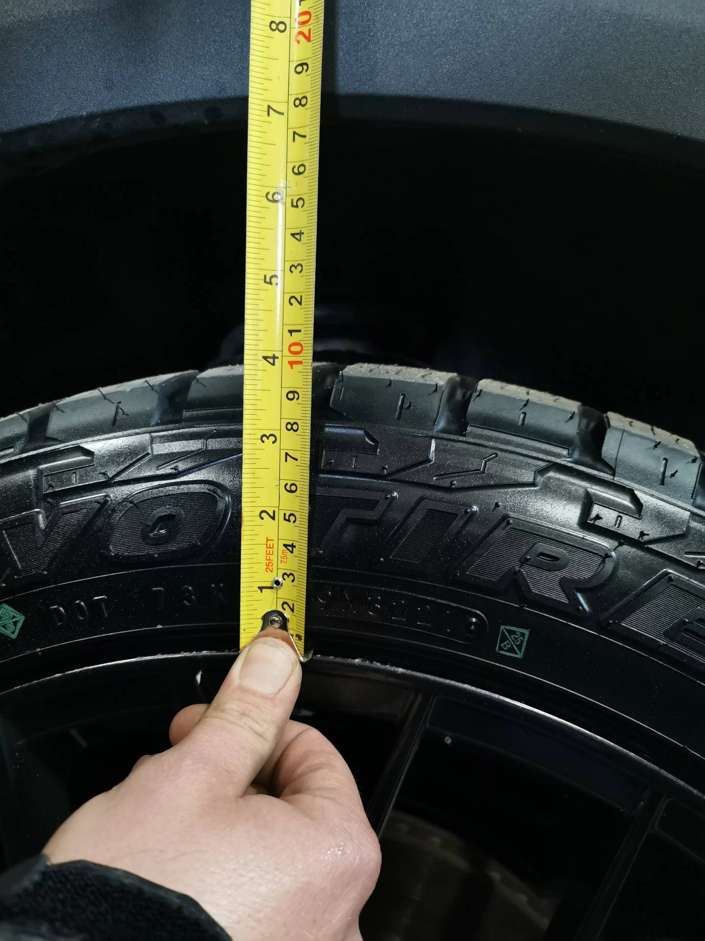

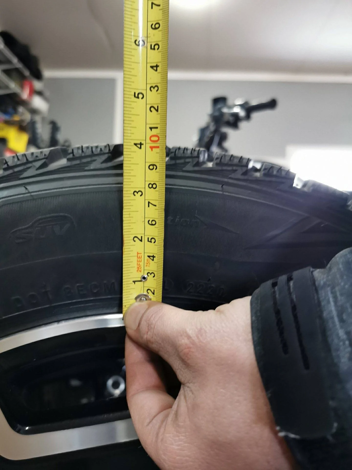

Just got home to measure.
Stock tires ( my winters but stock size )
Ford Bronco Sport 20" Do fit ! IMG_20220405_190217
New rims and tires :
Ford Bronco Sport 20" Do fit ! IMG_20220405_190212
So almost no loss of sidewall 4" stock and 4"on the 20"

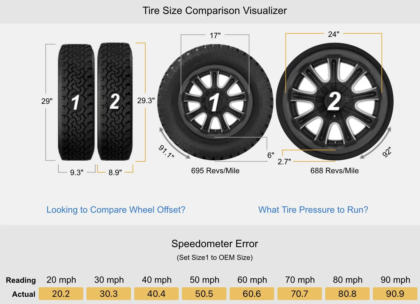

Why is this even a question? You can probably fit 24’s on the BS. The issue will be finding tires low profile enough to fit. It is not the size of the wheels that matter (until they are too small to fit over the brakes). The real issue is the diameter of the tire and the width of both.

Your absolutely correct. I chose a bigger rim and a bigger tire so I still had same sidewall as stock... I just chose 20" instead of 17" or 18". But chose the same bigger tire diameter as most people on this form The form is amazing and helped me make my decisions.
