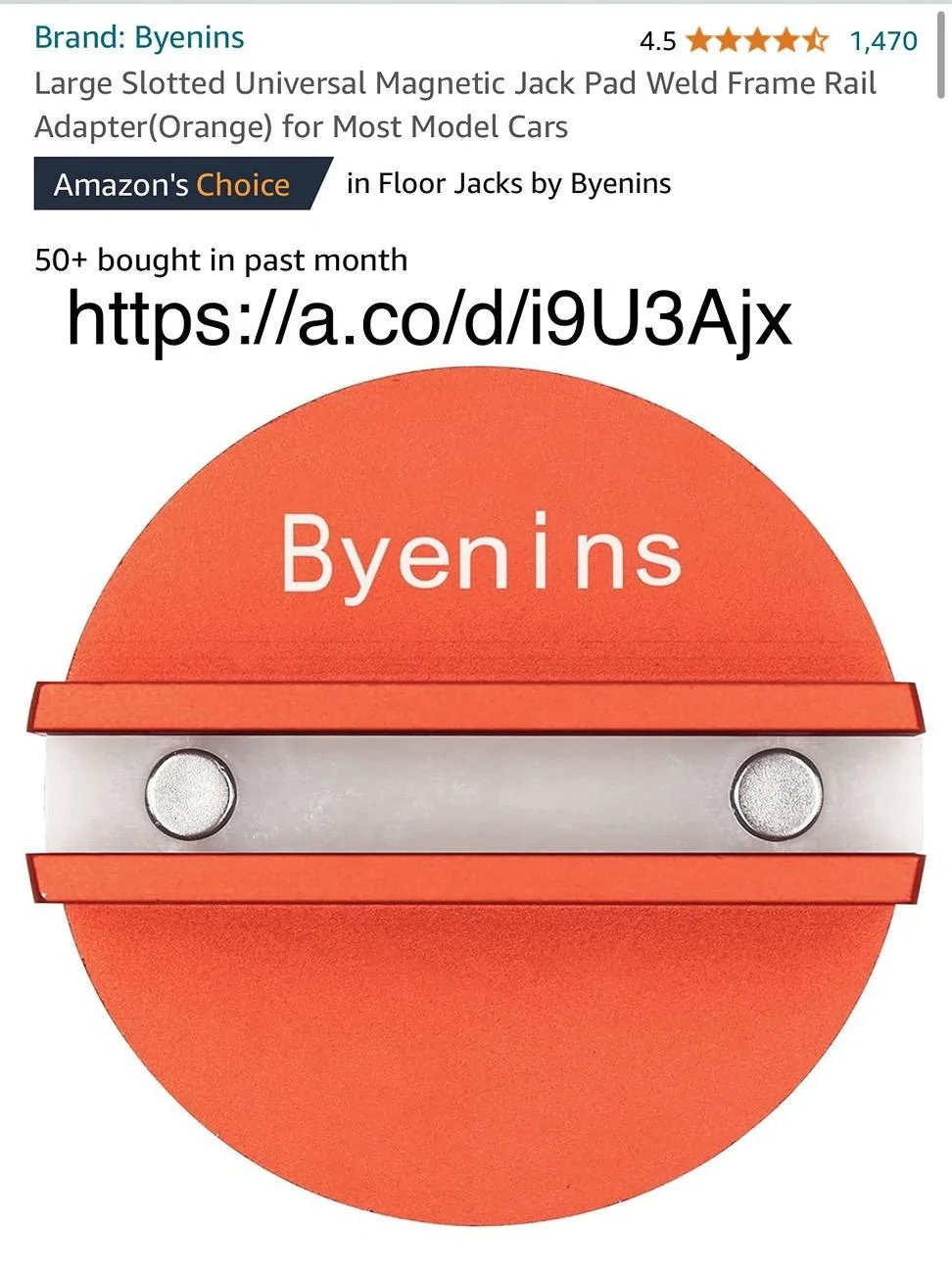

Like this device?
Ford Bronco Sport 2-post lift points IMG_7060
Yes those are the adapters. I use those other vehicles, but was hoping the bronco would have an additional lift point for hoists. Pinch welds can be different heights for different vehicles, but I guess it’s possible the dealer service changes out lift pads for each vehicle. They of course do not use adapters.

Yes my lift has rubber pads as well , with grooves. If the pinch weld is short enough, slotted hockey pucks are a great “adapter/ protector”. It worked out fine and oil and trans fluid successfully changed.
6,733
13,154
I don't believe these adapters are meant to prevent folding a pinch weld, they are meant to prevent the vehicle sliding off the lift pads. My floor jack has a tough rubber pad on top of the lift pad that I believe provides adequate friction to prevent the car sliding off the jack.
