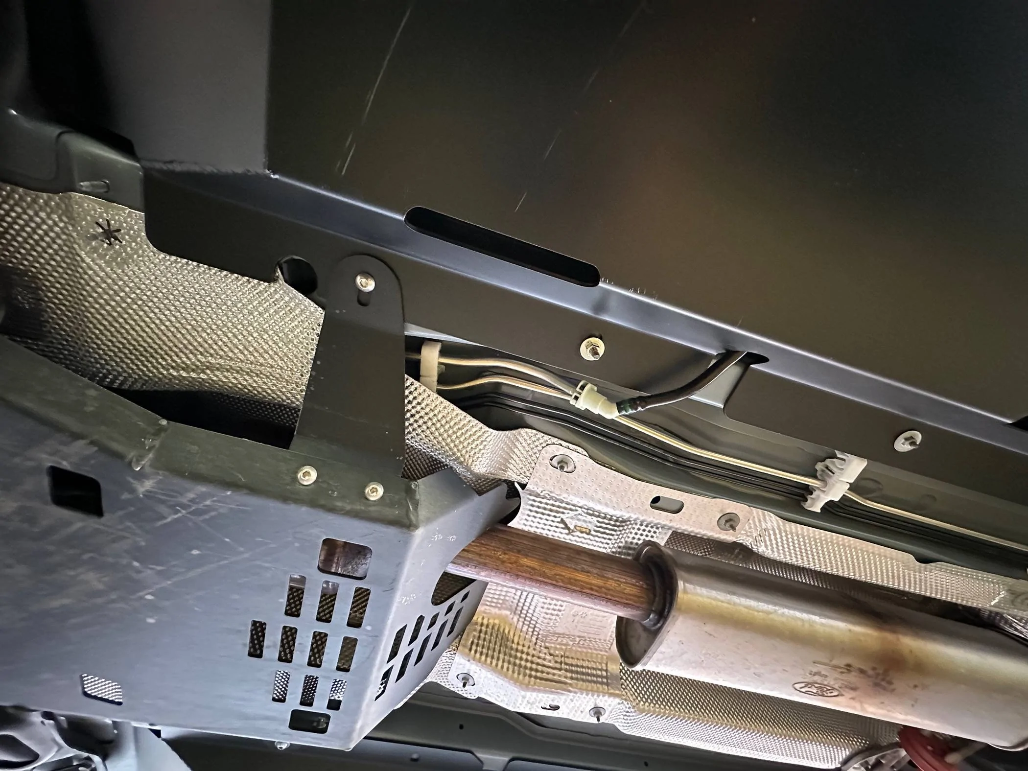

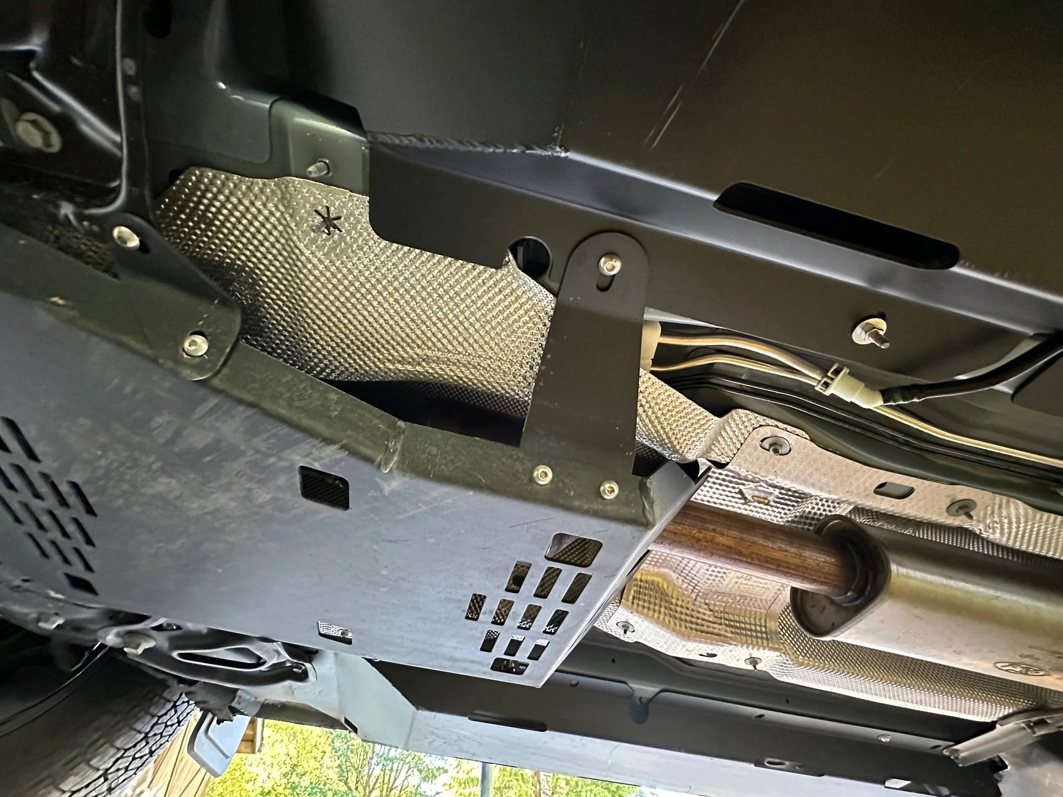

Installed the cat guard last month very easy, the skid plates this past weekend Took more time. Both the Cat Guard and skids were bought from JCR OffRoad. Drilling through the pinch seem took some work. Ended up buying some center drill bits making short work. Looks great as well as the extra protection they provide from rocks or any cat thief’.

No need. I just called a muffler shop across the street from me (yeah I know, no one wants that) and he’s is getting prices but he confirmed there are 2 cats for the ā€˜22 Badlands with 2.0L engine.
I can see why you didn’t know .. it’s almost 5 hours labor to replace the primary cat (maybe was total for both cats). probably not done too often.
The primary cat is on the turbo downtube protected by the factory skid plate and the secondary cat is located below the front seat area as shown in the pic earlier in this post (the one protected by the JCR CAT GUARD).
Caveat: The info above might not be 100% accurate and may not apply equally to the 1.5L Engine and 2.0L Engine Bronco Sports for all model years.
