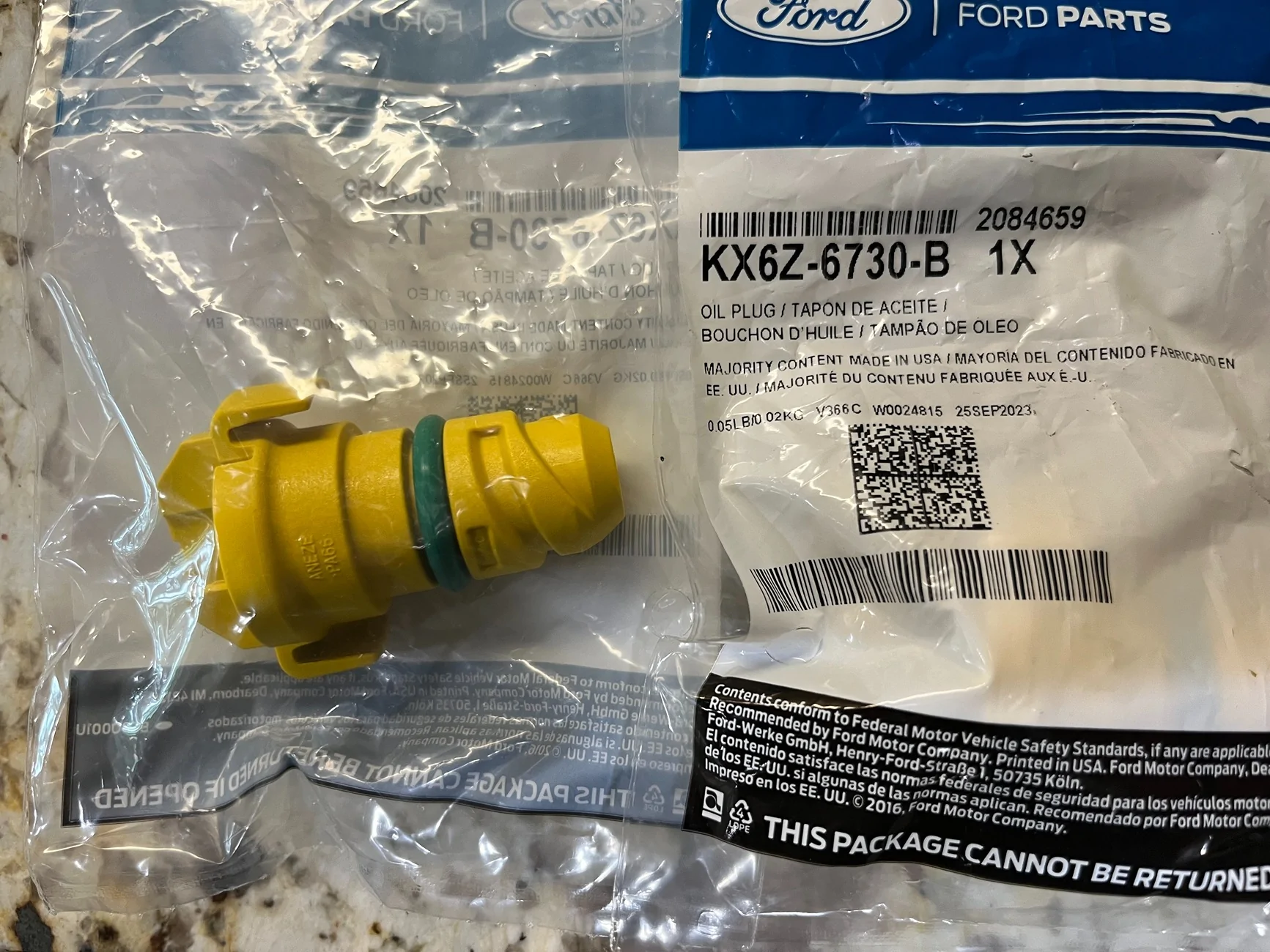

I just got my 23’ Bronco Sport Outer Banks Edition. Bought it from my son who got it new. Had the the oil changed at the Ford dealer. I do all this myself. Had not seen this oil plug set up before. Is this silly little plastics thing supposed to be replaced every time you change the oil? There is no way this is less expensive than a metal bolt.
I changed the oil yesterday. Do I need to worry about this?
No need to worry for a one-time reuse. Over time the o-ring could harden or be damaged causing leakage. Cheers!

Can anyone tell me if my 2025 Outer Banks would have a plastic plug thank you
In case you haven't found an answer yet, yes the 2025 with the 1.5 L definitely has the yellow plastic drain plug. I confirm this yesterday on my 2025 Big Bend

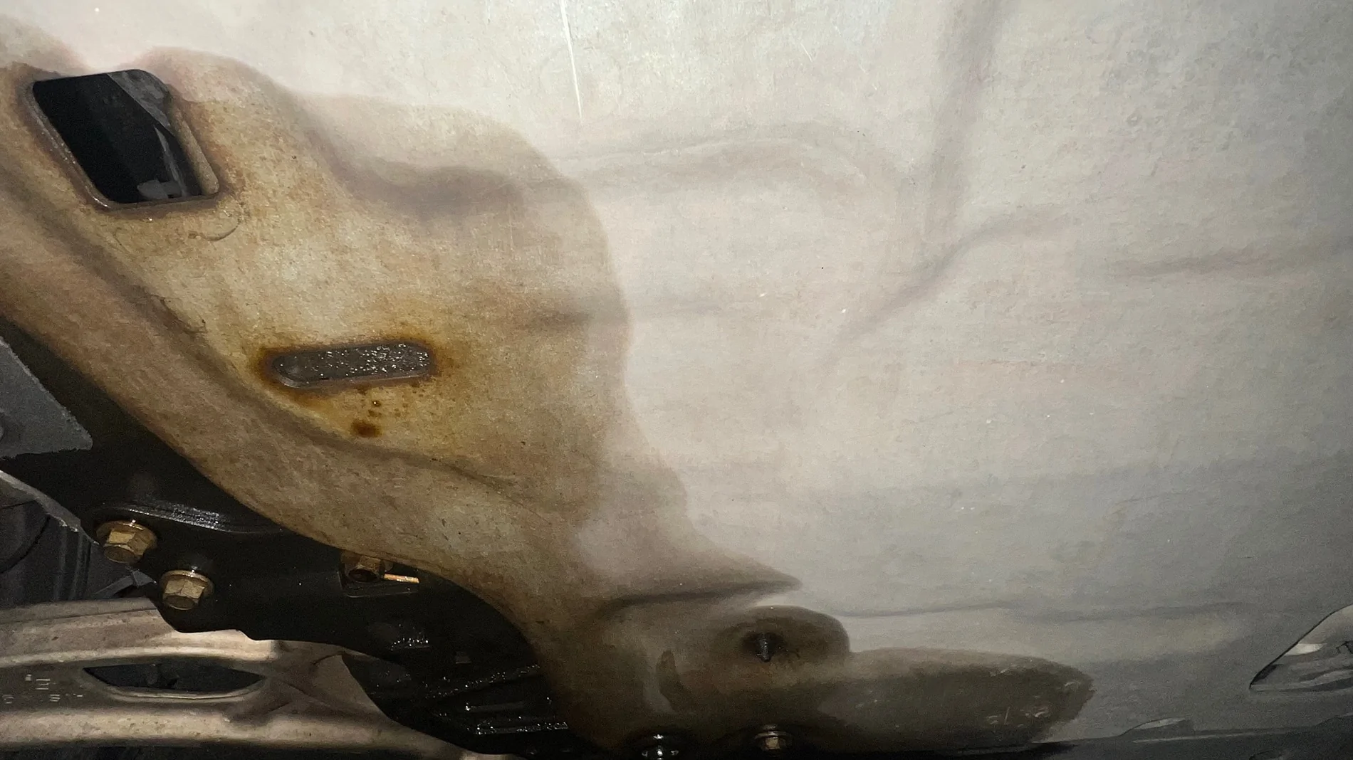

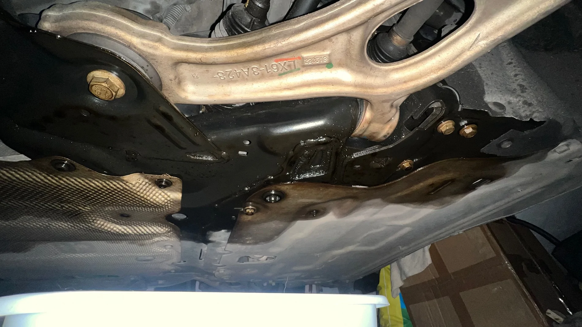

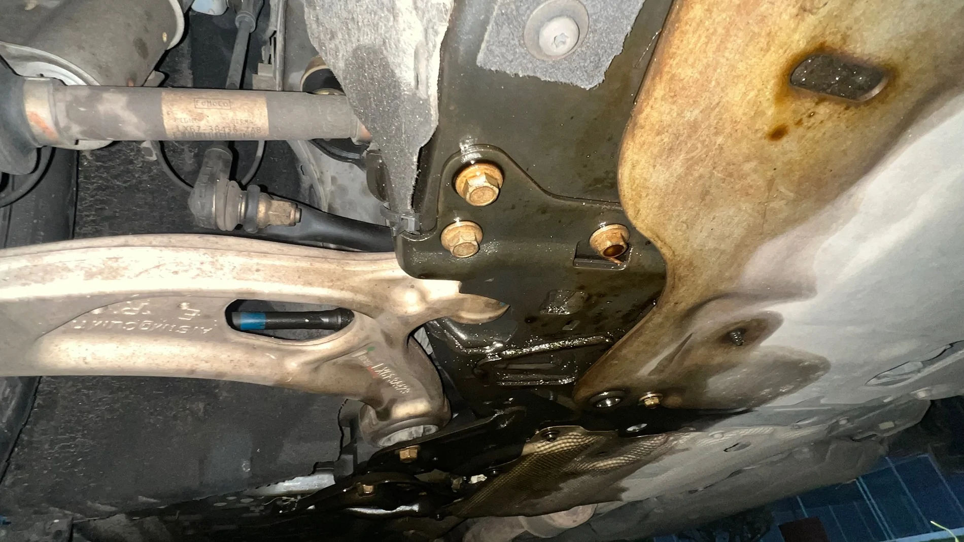

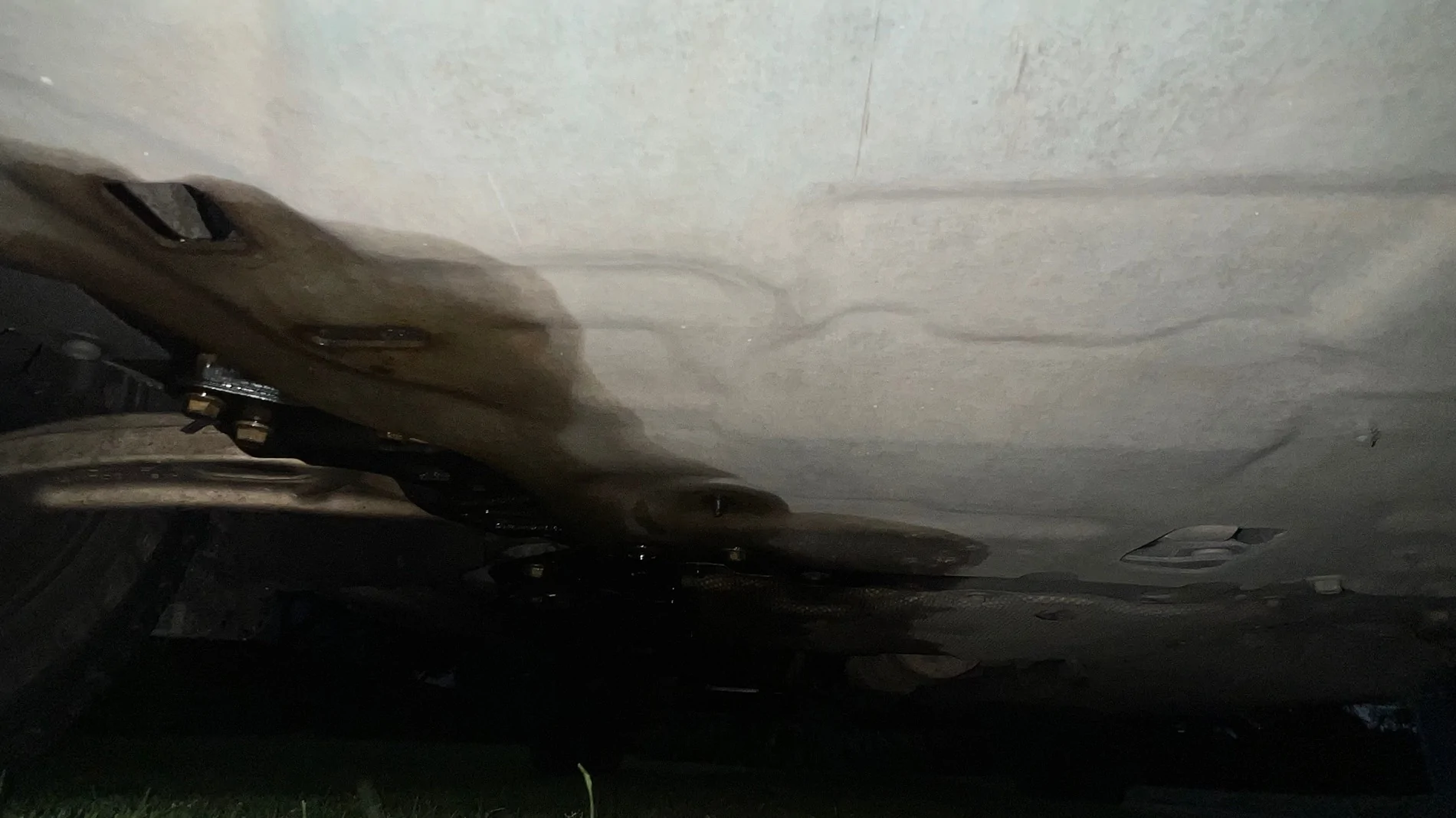

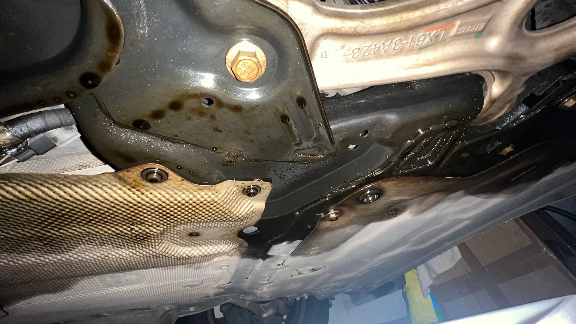

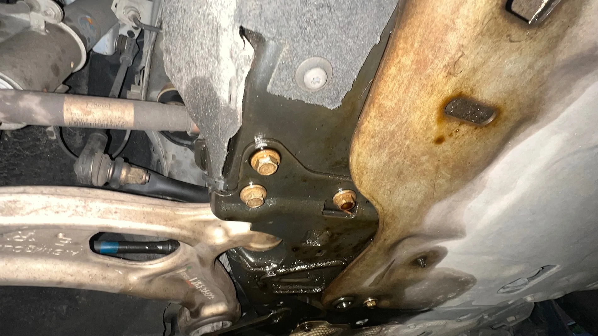

Bronco sport wildtrak ( badlands 2022 here in Argentina ) so … the service needs to change that every oil service ? I have this problem now
