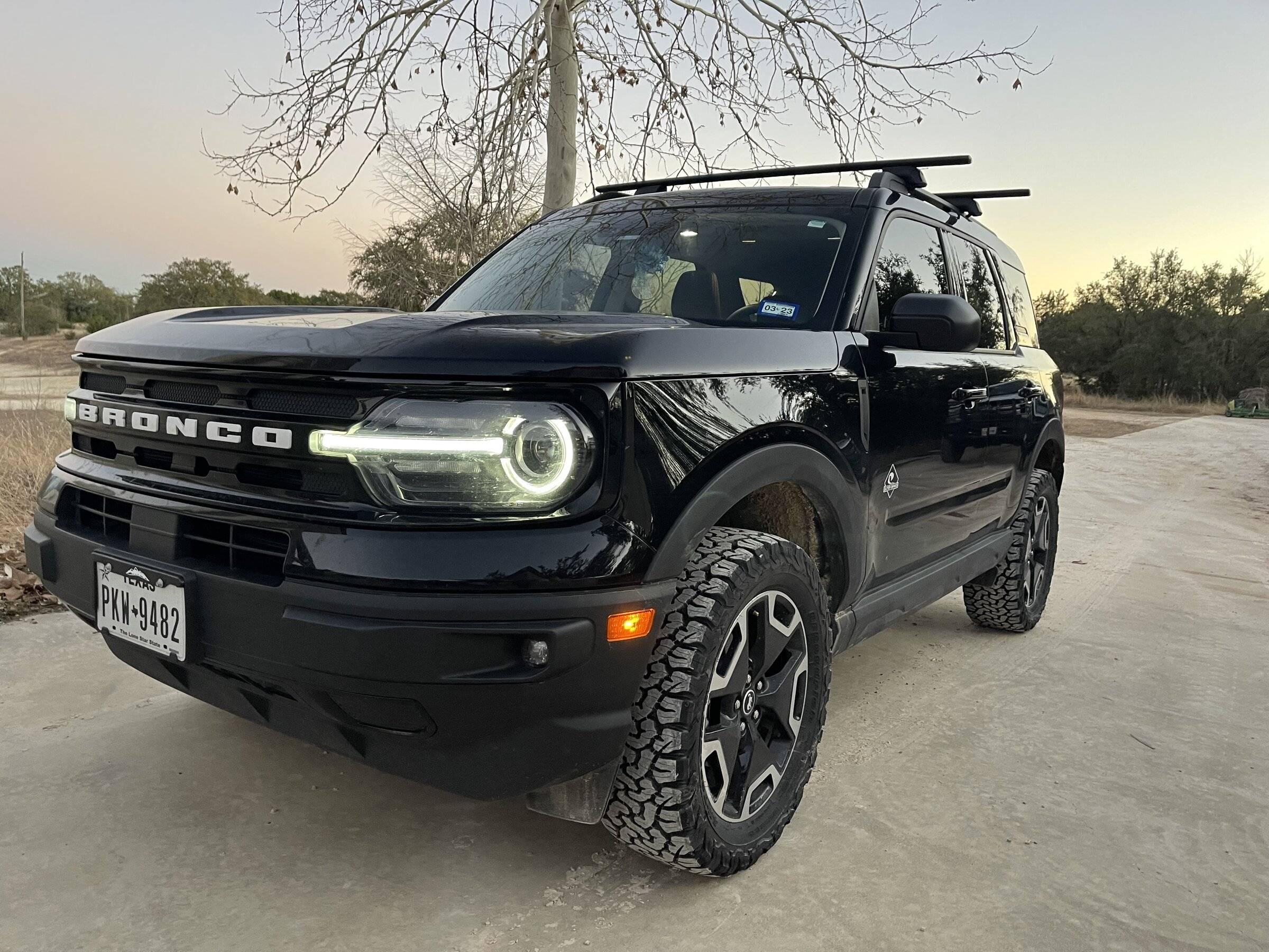

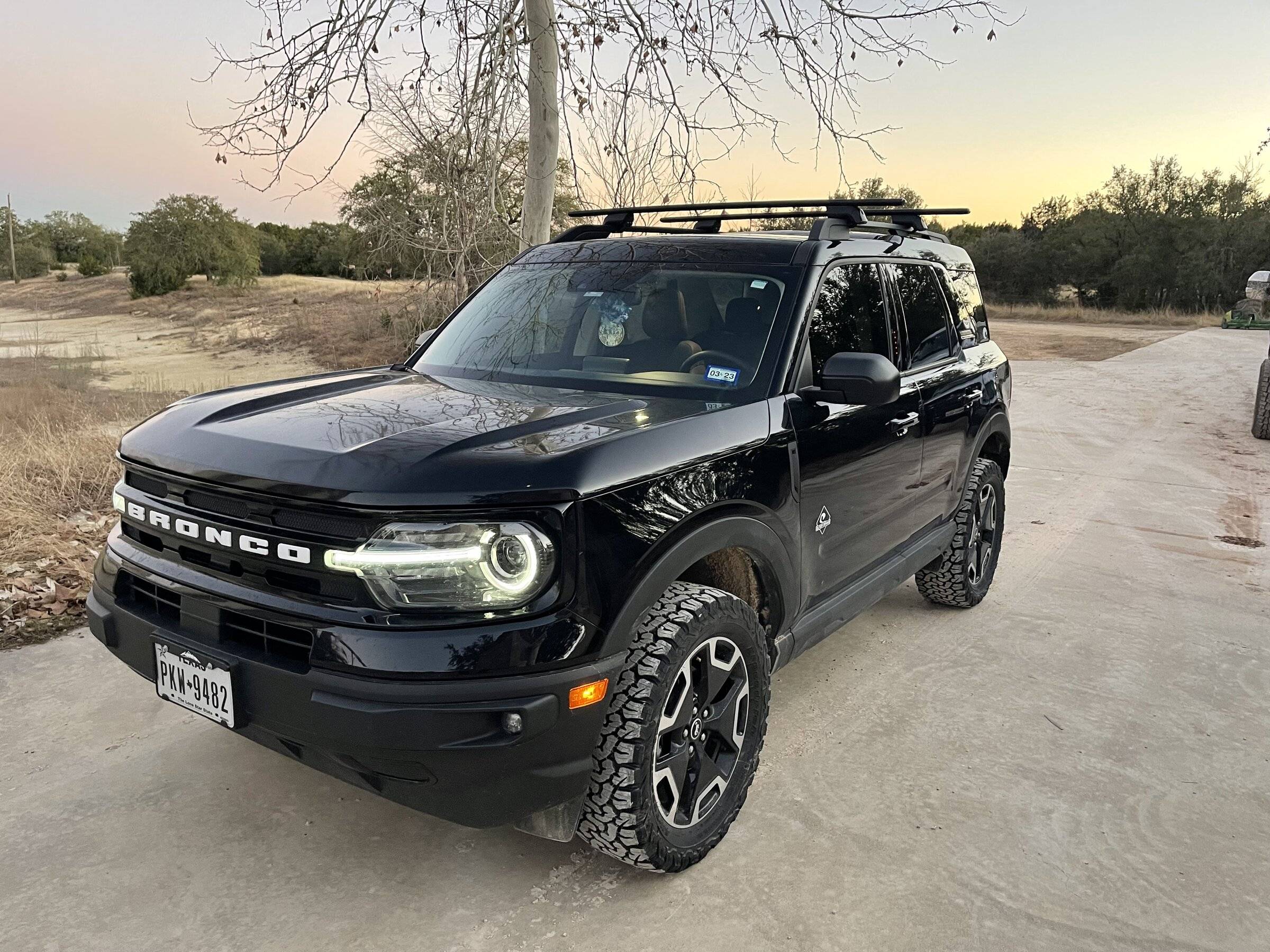

Nice, what size of tires are those? Are they 18” rims ? I’m looking at replacing my toyos with the ko2
They are 255/55R18. They ride well and I'm looking to change fewer flat tires on the wife's ride with these rather than the factory Michelins that were on there.
Thanks that was the size I was going with
