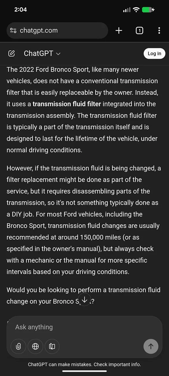

Would really like to see the part number for the 8F35 transmission pan filter
does "8F35" transmission have a pan filter
This is an AI response and AI isn’t always accurate …
No, the Ford 8F35 transmission does not have a conventional pan filter that is accessible by dropping the pan; instead, it uses an internal filter that requires a complete disassembly of the transmission to service. However, some parts listings refer to it as a "screen assembly" or a "cartridge" filter, indicating it is an integrated component within the transmission.
https://parts.lakelandford.com/p/Ford__Bronco-Sport/Transmission-Oil-Filter/75837325/JM5Z7A098A.html
No 8F35 transmission pan filter is mentioned
The internal filter is mentioned several times

IDK man. They changed the fluid and filter.

Here's a disassembly video of a 22 Transit Connect 8F35 transmission. Notice that there is no "pan filter" (because there is no pan). There is a vertically-oriented valve body cover that has no filter behind it. The high pressure canister filter is internal (approximately 9:35 of the video). If they say they changed the filter, they're BS'ing. Cheers!

That cheap pos filter (9:35) is the transmission fluid filter? Is that a joke?

I just assumed I was talking to educated folks (no snark) who knew the internal filter is only serviceable by taking apart the transmission, as you said.
If you have to change the internal, you don't have a transmission.
Genuinely sorry we were talking about different things when I thought we were talking about the same.
Now you talk about an external ATF filter. Where is this filter located? I have changed my ATF several times and never located any external filter. Because it does not exist.
Where is the receipt?
