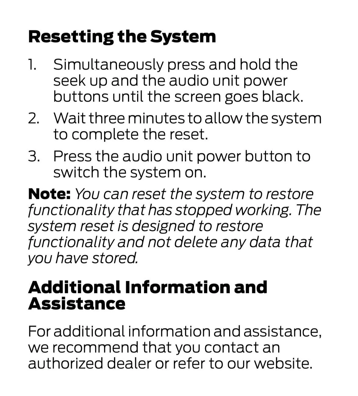

Please check the Build version by doing the following.
On the center screen:
Tab Settings
Scroll left or right to General
Tab General
Scroll down to About SYNC
Tab About SYNC
I would perform a reset.

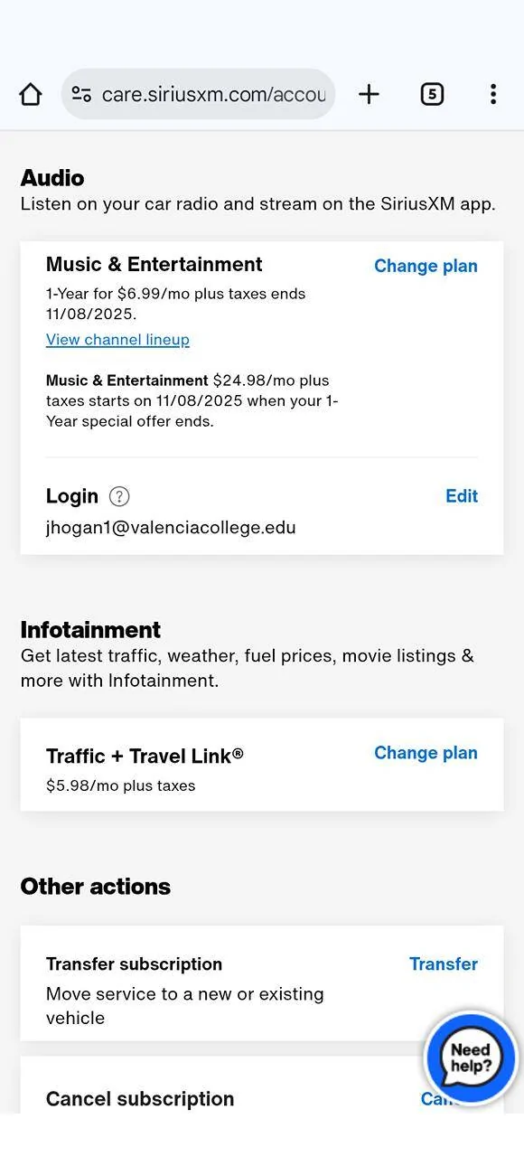

@DSB Snag Lets establish what Sirius services you are paying vs the complimentary service provided by Ford
Earlier you said you are paying for SiriusXM with everything
Does your SiriusXM account show the Traffic Plus / Travel Link? That’s either going to show you are paying for this or have the Complimentary 5yr Trial with Co-Pilot360 Assist+:
SiriusXM Traffic Plus
SiriusXM Travel Link
regarding who to elevate to, I’ll have to check when I get home if I have a record of who I talked to
might help if you posted a screenshot of your SiriusXM account page showing your services (black out personal info like names, account numbers, phone #s)
Yes. Paying for traffic and travel at 5.98 a month. Also music and entertainment at 6.98 a month.
Ford Bronco Sport 2022 Bronco Sport Sirius XM Traffic Screenshot_20250629-165035

But if we click on subscriptions in the sport it says traffic is not subscribed.

Your traffic and travel may have been disconnected when the Ford 3 month siriusXM subscription ended but since you are paying for both siriusXM and traffic/travel (instead of using the free 5 year traffic/travel if that was applicable to your vehicle) it’s very odd that customer service cannot get it to work
I know they did the signal reset many times but have you checked in your vehicle where you are getting the “says not subscribed”… to see if there is a scan that can be done?
