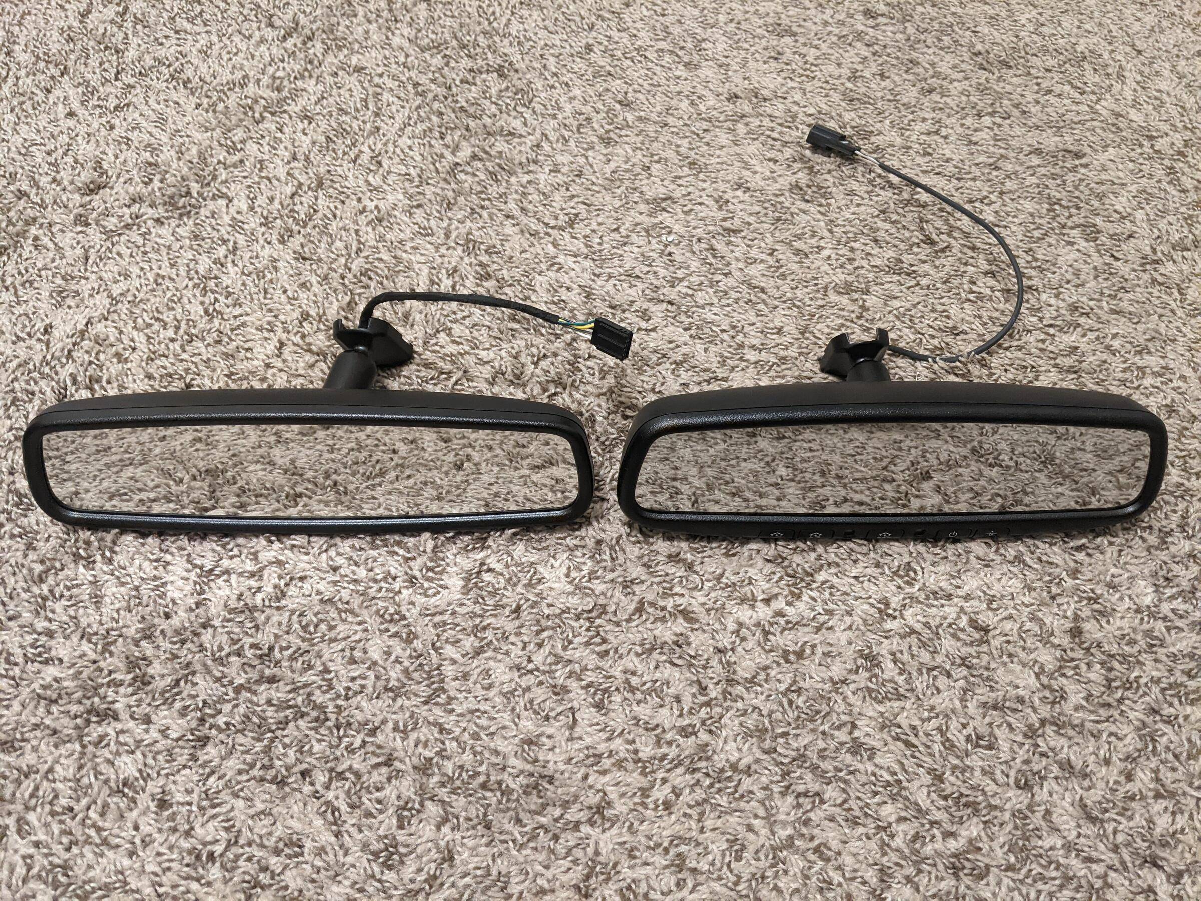

They appear to be the same size, with same length neck, except the Homelink mirror is deeper. It will clear the black plastic shroud thing but just barely. You'll need the GENMM5 neck extender. You can find them on eBay for around $15 including shipping and tax.

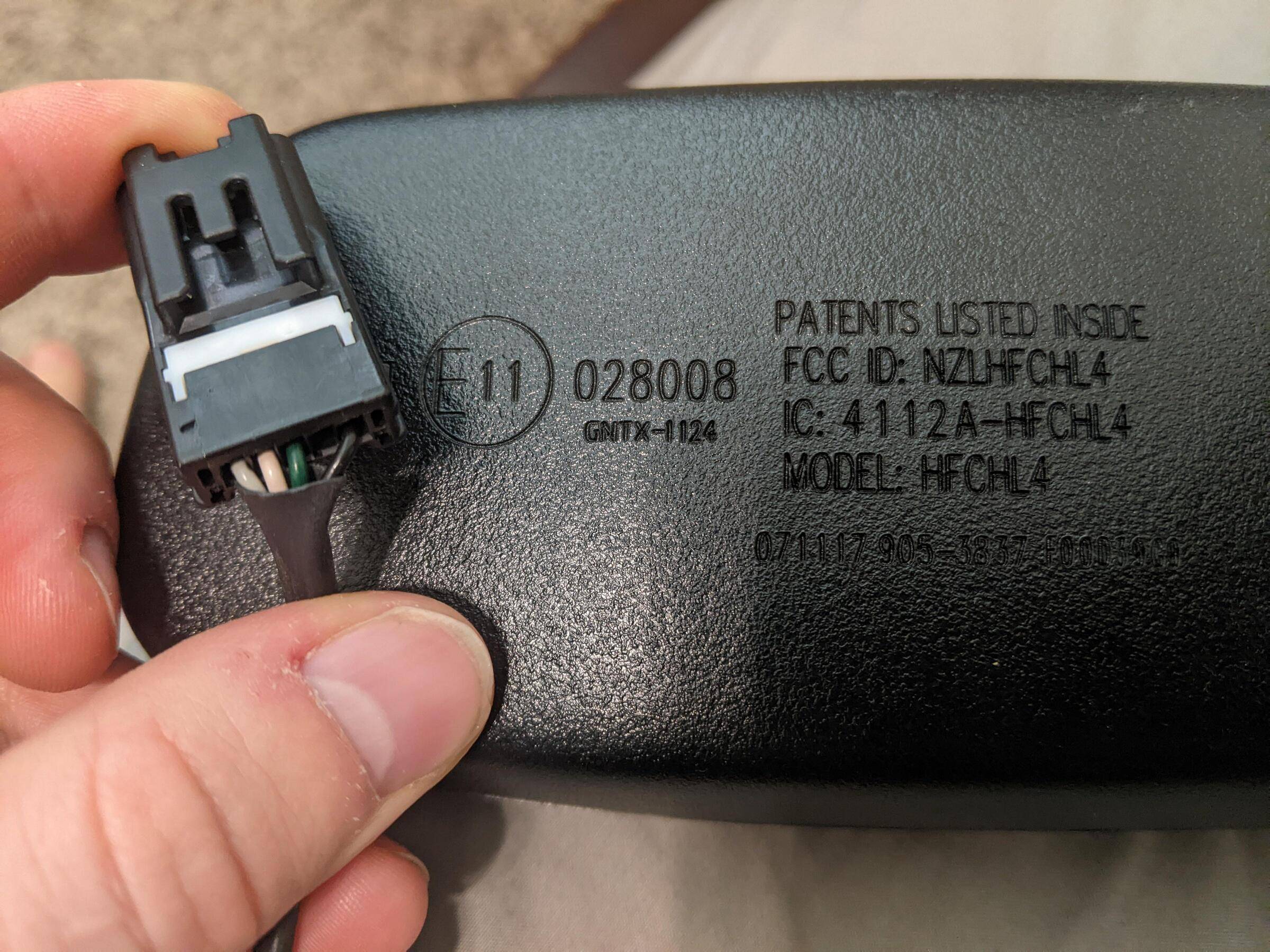

Gentex makes the mirror. They also make the mirror in the BS. And basically every automotive mirror. The Gentex PN for this Kia mirror is GNTX-1124.

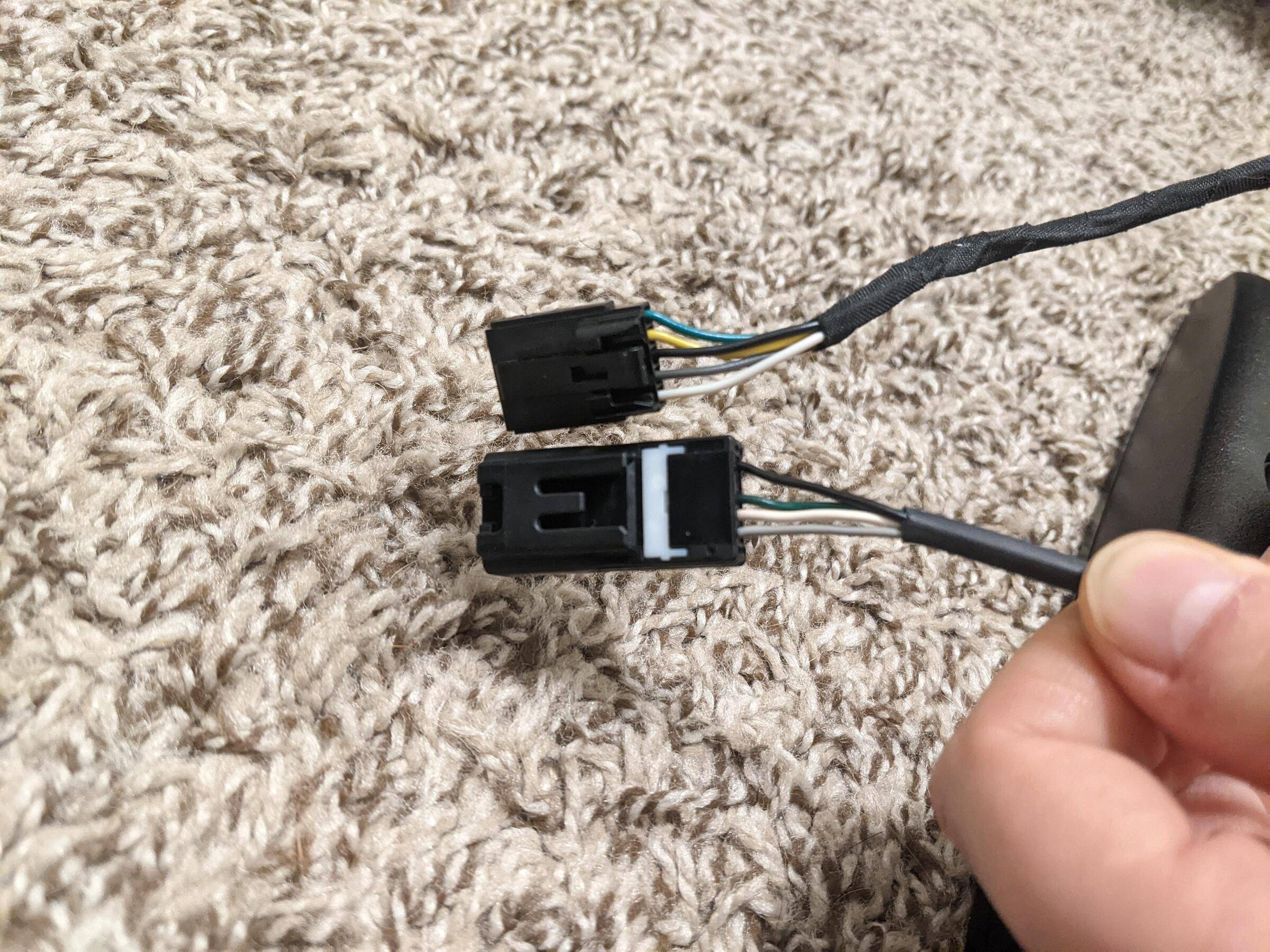

To install, all I had to do was snip the connector off my Ford mirror and solder it into the Kia wires. Then it was plug n play. I couldn't depin/repin because the BS mirror connector contains sockets while the Kia connector contains pins.
On the Ford mirror connector, there are five wires: green, yellow, black, gray, and white. The green and yellow wires go to empty pins. They do nothing. The black wire is ground. The gray wire is the reverse indicator circuit. When you put the BS in reverse, it sends a 12V signal to that wire. That tells the mirror to not dim. The white wire is a switched 12V source.
On the Kia mirror connector, there were four wires: gray, white, green, and black. Gray is the reverse indicator. White powers the hidden compass. Green powers the Homelink buttons. Black is ground. Either white or green also powers the auto-dimming.

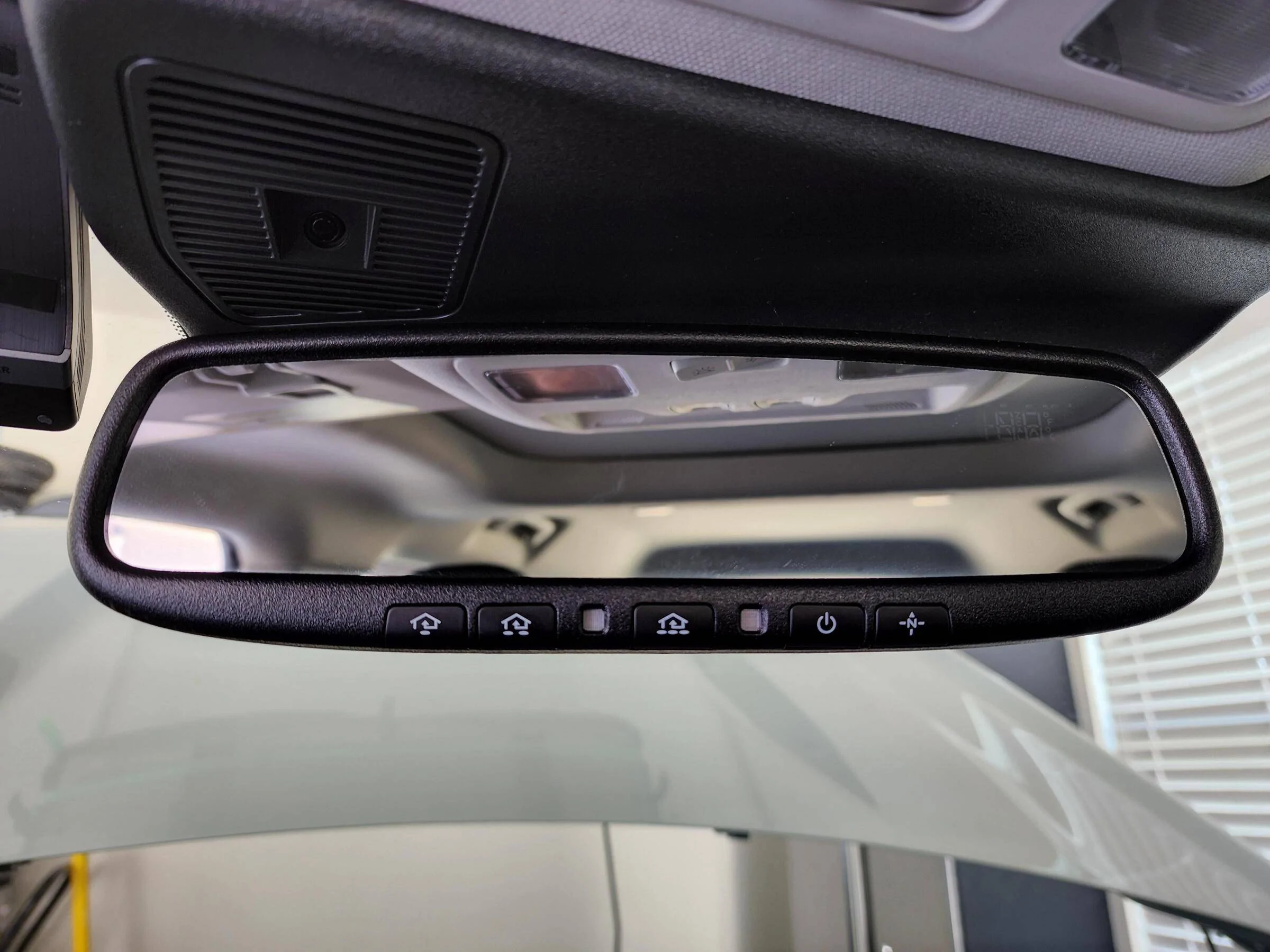

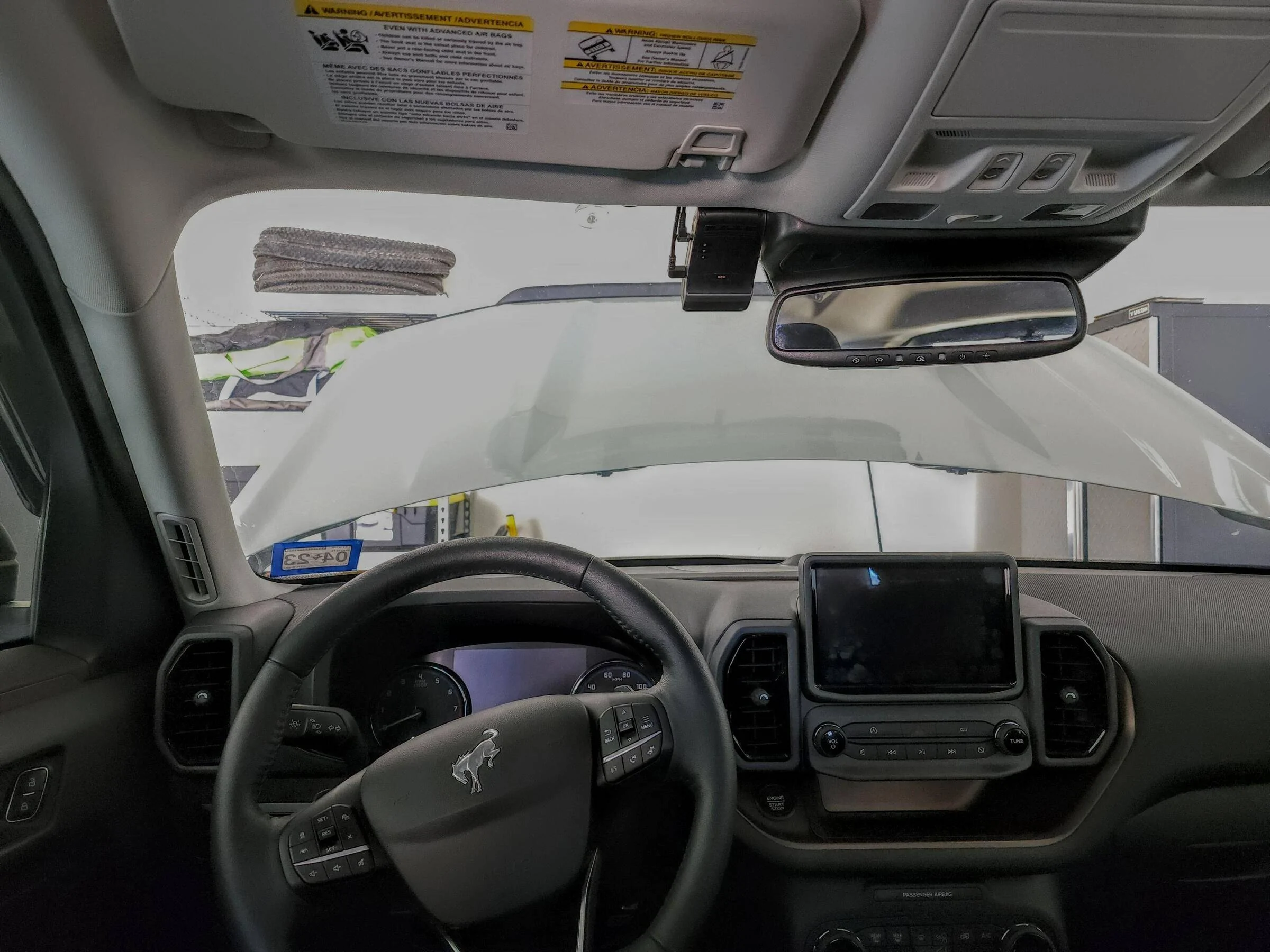

Thanks, I'm pleased with it. While it's not in the Ford parts catalog it is manufactured by a Ford OEM. I removed a Gentex mirror and replaced it with a Gentex mirror. Though all I really care about is that it works and doesn't look out of place. For that reason, had I not stumbled upon the Maverick thread, I would have taken your visor route. I'd been watching that thread since you wrote it, I just wasn't ready to swallow the price pill.
I also have an aversion to modifying factory wiring in modern cars. Splicing new loads into existing circuits can be pretty risky! Cutting leads and swapping connectors was pretty benign though. If all else failed, I'd just have to replace a mirror.
Final product:
