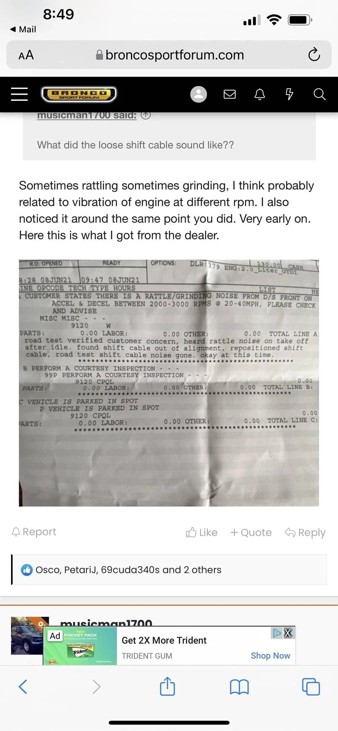

I have the same sound. Kinda sounds like a mixture of pebbles spinning in an empty tin can + a playing card taped to a bike frame to flap against tire spokes.
Saw in a recent post that the diagnosis was a “loose/misaligned shift cable”.
Trying to get mine it (BB/6k miles) to have it looked at.
I snapped a picture of the service/diagnostic receipt from the other post about the sound issue.
