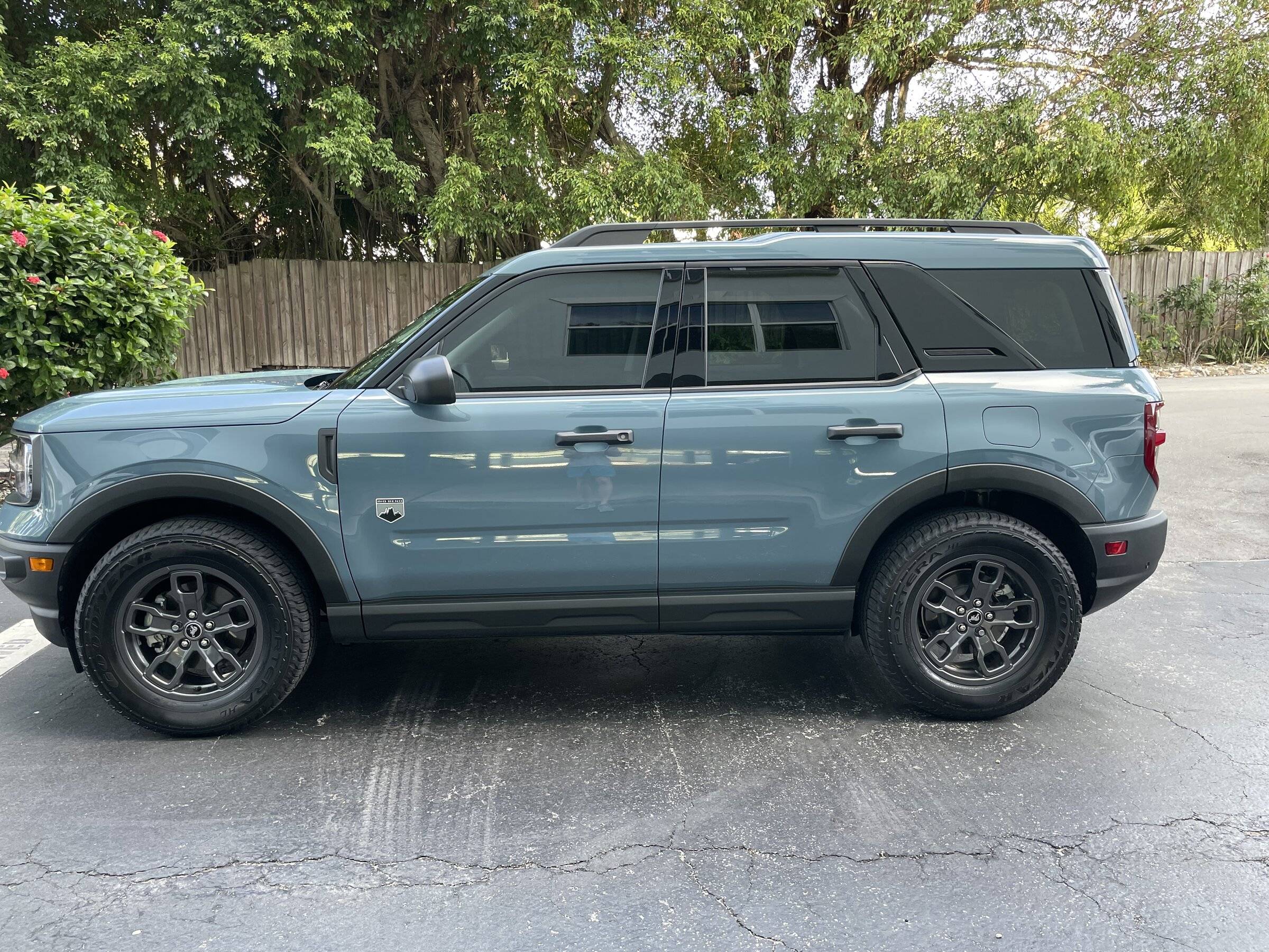

Has anyone noticed any handling issues with upsizing tires?
I just put 245/65/17 tires on my big bend with no lift and they look great. However, there’s a drastic difference in handling. I was expecting some difference but honestly I’m regretting going with the 245’s and thinking I should have gone 235. Obviously the steering is a bit more tight but the most noticeable difference is it seems less stable and more side to side ‘sway/rocking’ especially on the highway at higher speeds. Has anyone else experienced similar issues?
