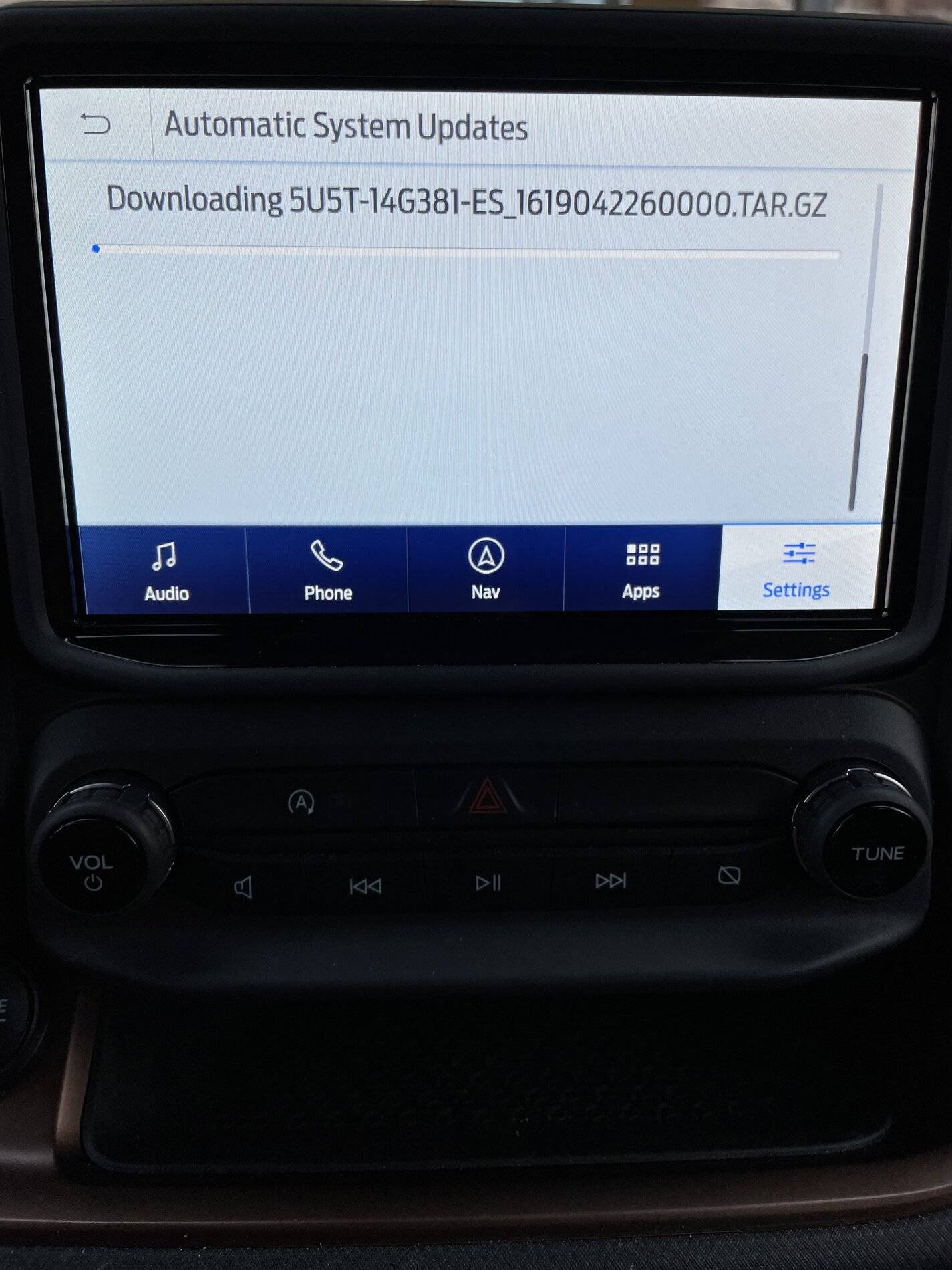

Downloaded from Ford website and prepped USB flash drive for install. Before inserting USB flash drive, I checked one last time for update using WiFi. The update is available now using Automatic System Updates.
I am downloading now.
Ford Bronco Sport Sync 3.4 Build 21098 27023490-332D-41CC-86F7-852AA8AB2ECB
