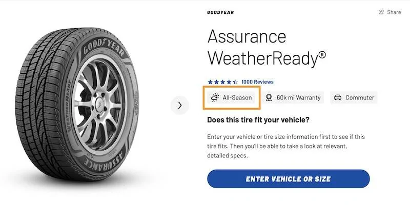

Interesting "real time"comparison (All Season vs Winter Tires)
Tire Siping
Ford Bronco Sport Rear tires slipping in snow/slush Goodyear Assurance Weather Ready
Update Dec 28: let's not forget about the different tire rubber compounds used, which can also be a noticeable factor.
