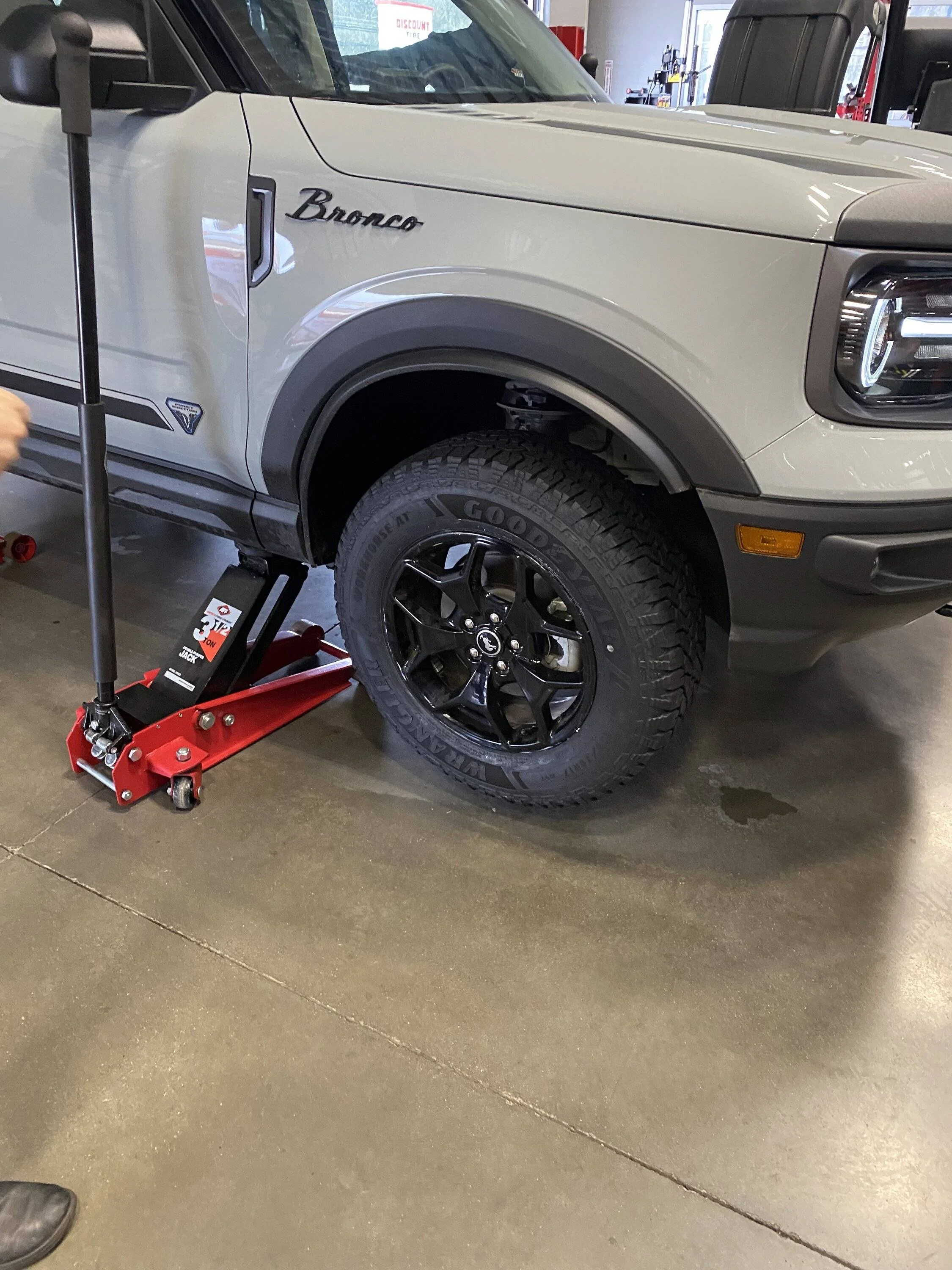

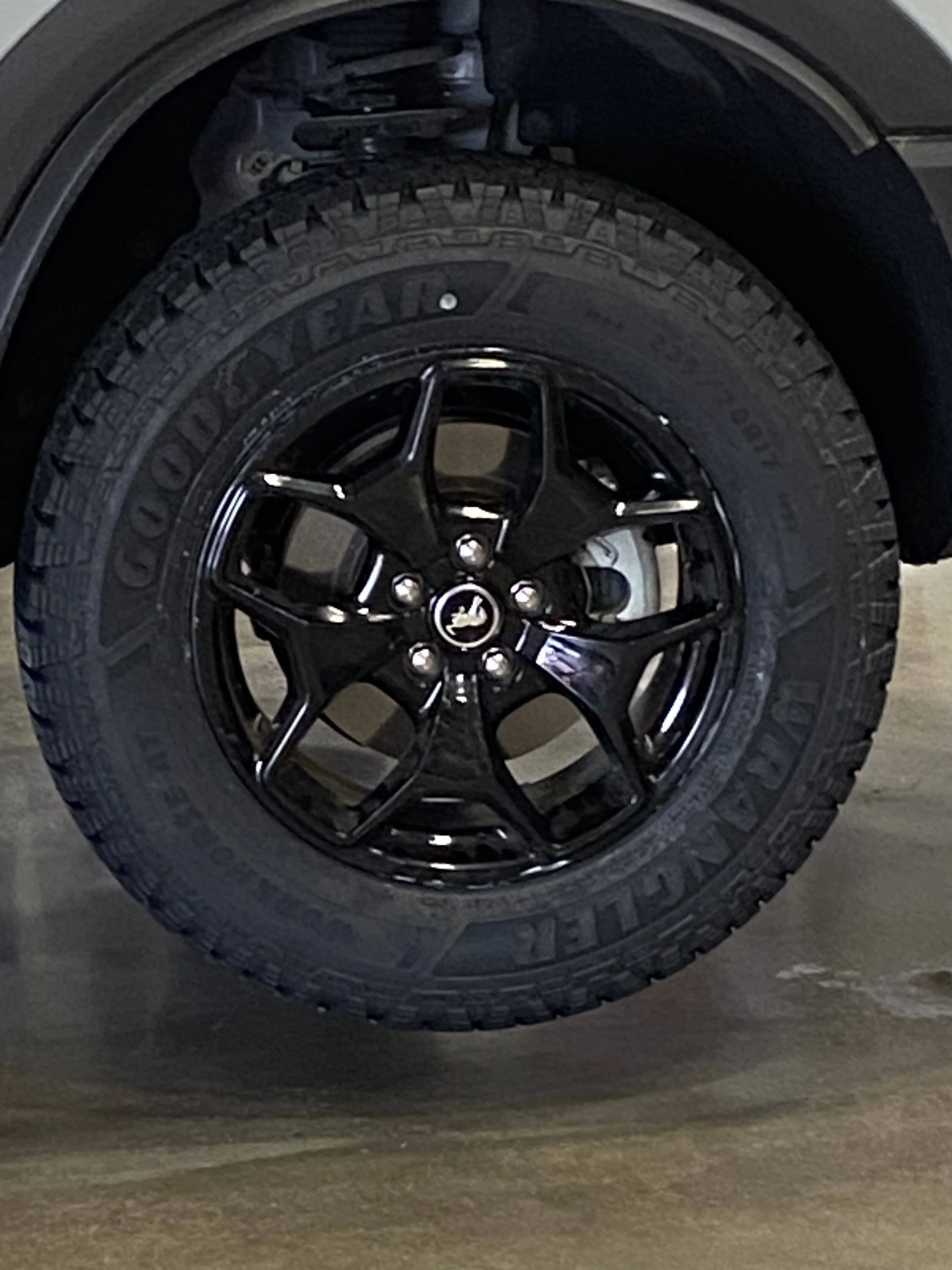

You can go to a 235/70/17 Goodyear wrangler workhorse,they stand at 30 inch and clear without issues. .

Got it. So that would be a full inch higher than the Falkens I think.
