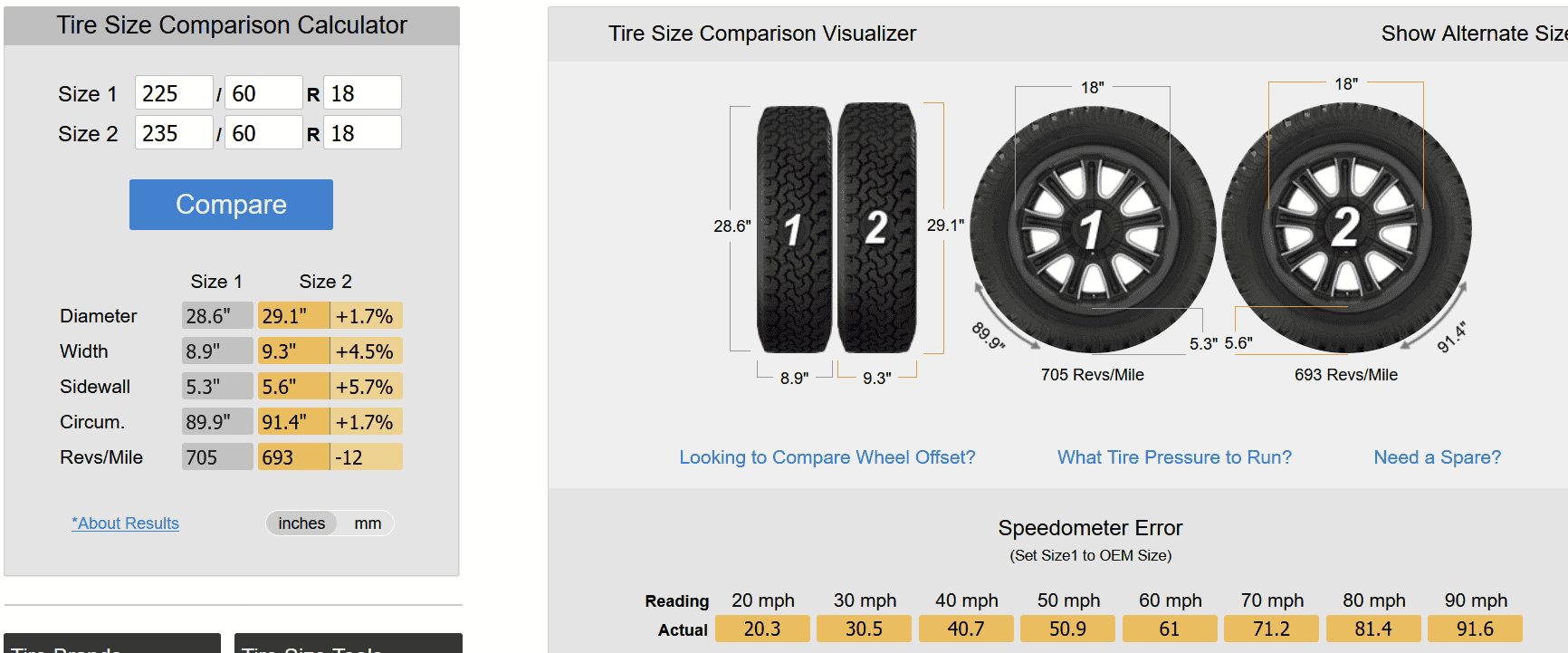

You could go as large as 245/60/18 which is 29.5" diameter. This is the same diameter as 245/65/17 and 245/70/16. I think you are trying to use the stock wheels, so the largest safe size is 245/60/18 for those wheels.
A lift does not fix the rubbing issue on the BS. The rub happens on the bottom/back side of the wheel well when the suspension is compressed and the steering wheel is turned all the way. A lift would only change how compressed the suspension would need to be for the rub to happen, not if it will happen. For the BS it's all about the diameter of the tire.

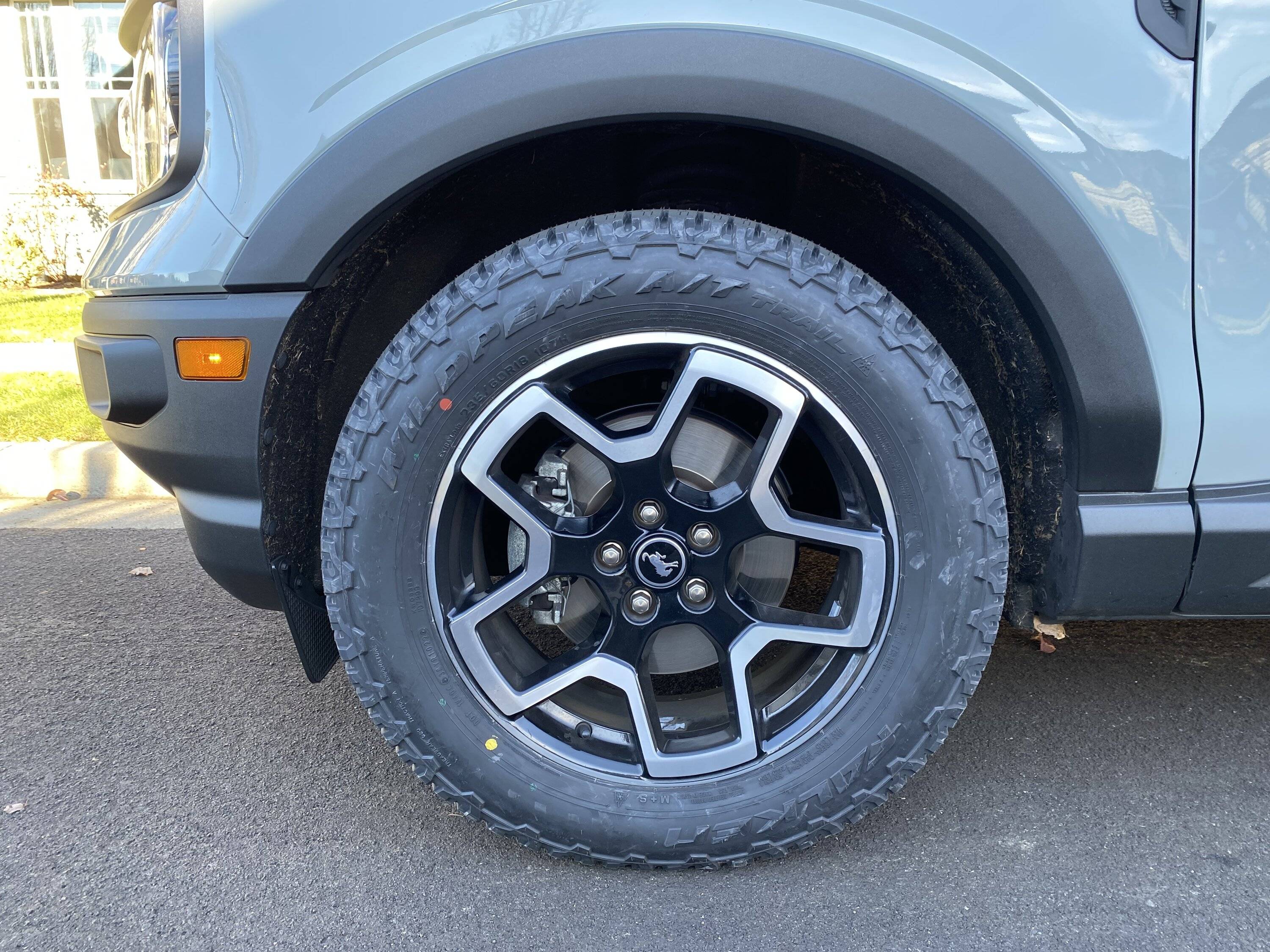

After using more thread on my BB’s old toyo tires and sliding on ice I finally changed to 235/60/18 falken this week! These sound more quiet over the highways than the toyo ats…me so happy wehehe
I promise i will shine it
