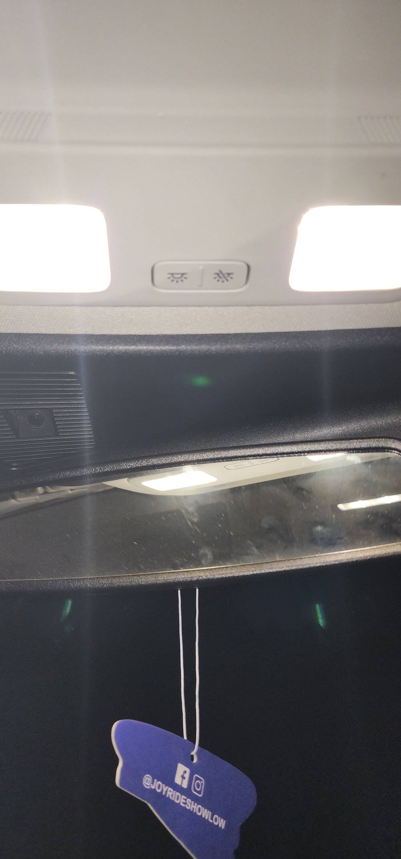

I've had my Bronco Sport BL for 13 months and my lights wouldn't go off at all. I found this light switch that I never knew I had.
Ford Bronco Sport Interior Light Issue 20230524_200528
