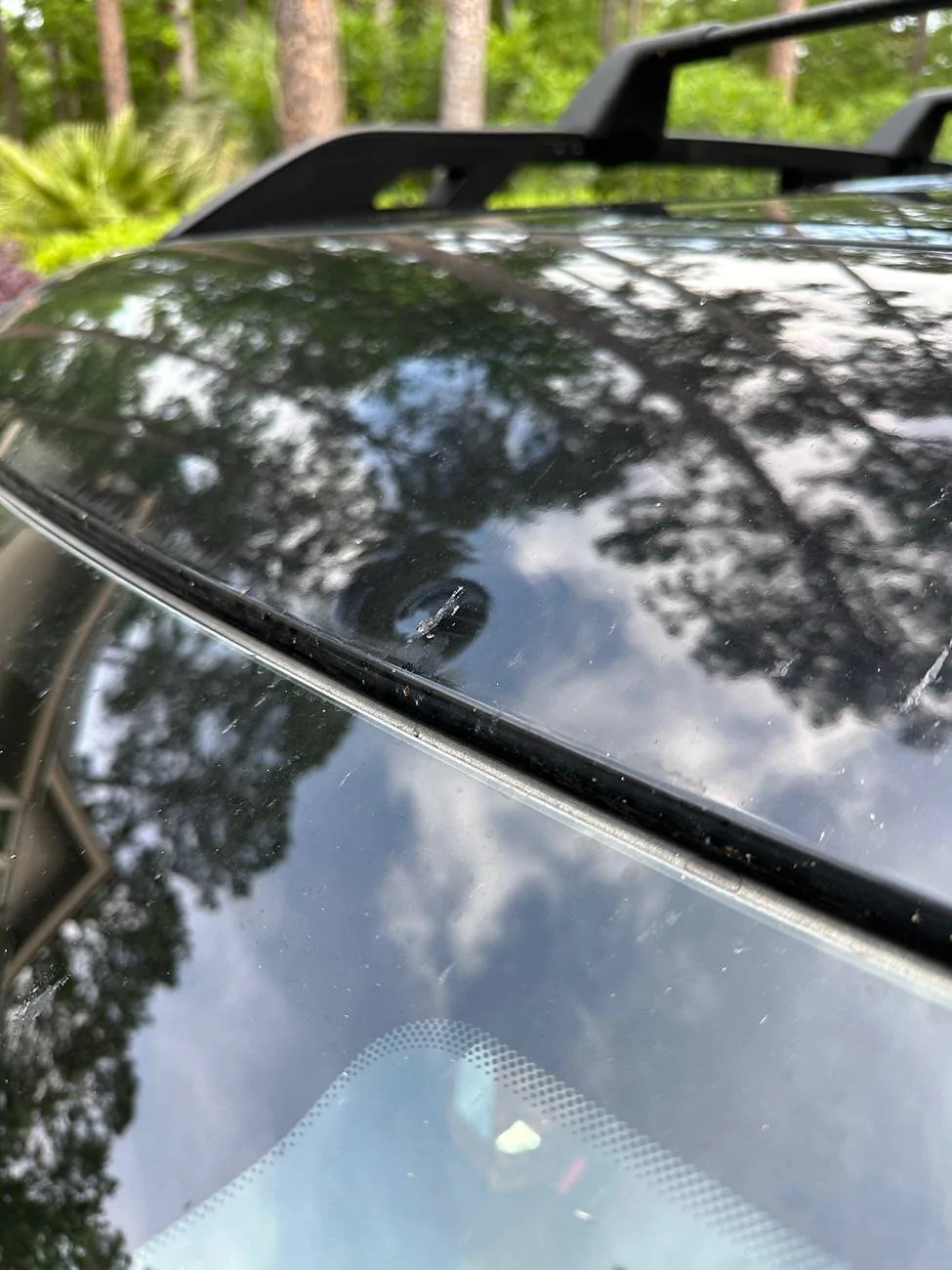

Hi all!
Anyone have any insight on replacing the roof front plate in front of the sunroof?
I’ve sourced a replacement part but want a plan before trimming to tear it apart.
Took a substantial rock hit and have a significant dent.
Appreciate it!

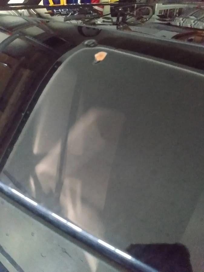

I caught a 4" chunk of concrete that flew off a dump truck going the opposite way. So relieved it somehow missed the windshield and the sunroof. Haven't repaired it. My understanding is that you have to remove the windshield in order to replace that panel. And that is a lot of factory-built seals to break loose. I'm not going to risk it despite the cosmetics. If I ever have to get a windshield replacement, I'll look at it again. If you figure out anything different, I'll check back and see how it went. GLWR.
This is today, this is 18 months ago when it happened. Just a little surface rust now.

Yikes! Stinks your car took that hit!
I’m surprised by the rust. The part on my car feels like plastic.

A little surface rust now will turn into a lot later, and then eat a hole. At the very least, I'd apply some rust converter such as this:

Should be easier to repair than replace. Grind out the paint down to bare metal and use the "key" system where keys are welded into the dent then pull on slowly with a key puller. I've been watching a lot of Robby Layton videos and that is what he uses to pull dents.

It is pretty soft/flexible. I swear mine improved itself with time. I bet even a hot glue stick might be able to pull it some.

Don't just apply black paint over it without sanding down first. Sand it, prime it, then paint.

Is it reachable from the inside? I would try to nudge it out from the inside.
