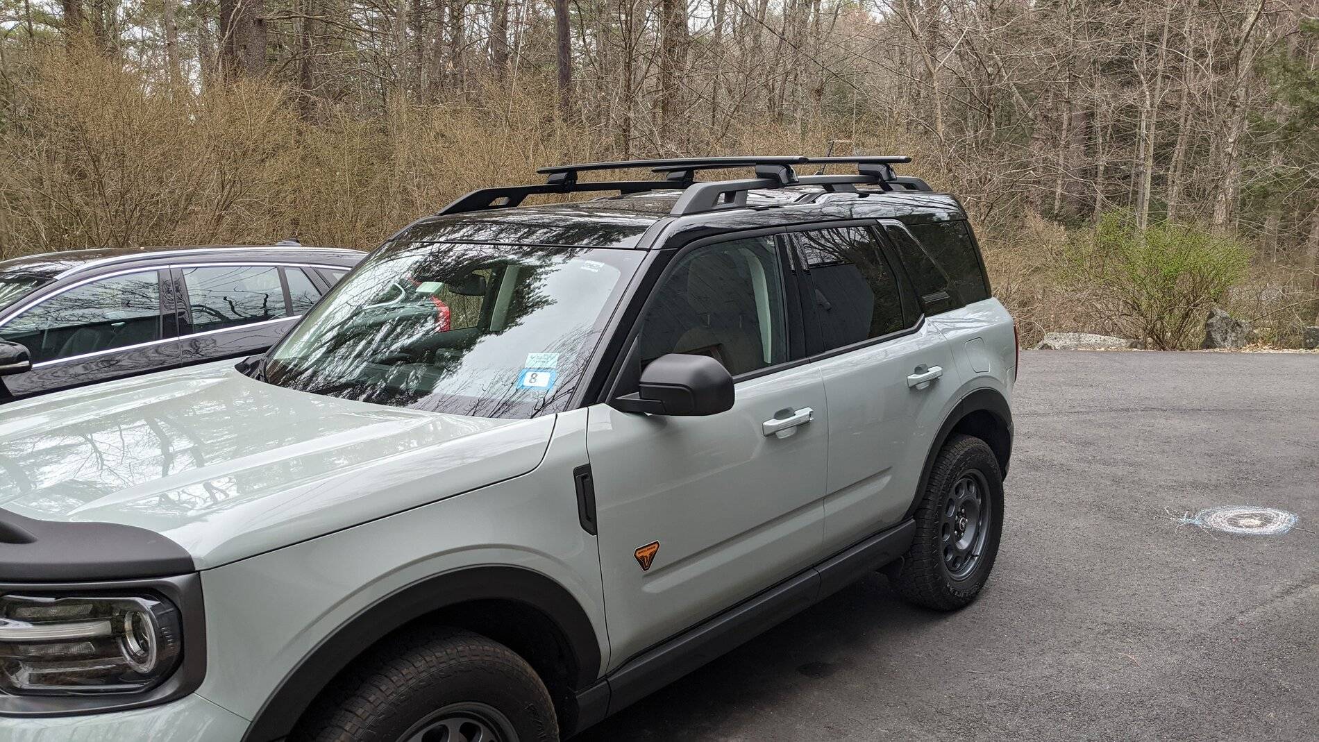

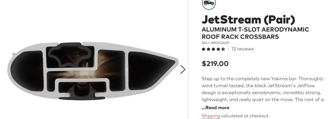

FWIW, those are jetstream crossbars, there are no timberline bars - that refers to the towers. Timberline towers use the strap to attach to raised side rails (which our sports have).
This is what I recently put on mine and oddly enough I don't notice any extra noise if the moon roof is closed. If open I can hear a little bit. Noise is subjective I suppose.
They're pretty easy to remove and put back on once you've determined where you want them and have them adjusted accordingly. Just remember that our rails aren't parallel - they're wider at the windshield and narrow as they go back, so one bar will have the towers spaced farther apart on the bar, and the rear will have them closer together.

Ford Bronco Sport Yakima Timberline Cross Bars PXL_20210415_193533166

Thanks. I did finally see the Jetstream/Timberline distinction.
I used the Yakima instructions and moved my front forward.
How long are your
How long are your crossbars?
They look shorter than mine.

I went with the small size (50") as I didn't think I wanted overhang. I fear I'd smack my head on them often otherwise haha. I don't have my basket yet and haven't hauled anything so it may turn out I want larger.
More overhang seems most useful for things like the road showers and awnings, which I'm not planning to get at this time so I think I'll be ok. First vehicle I've added these sort of accessories to so I'm learning as I go!

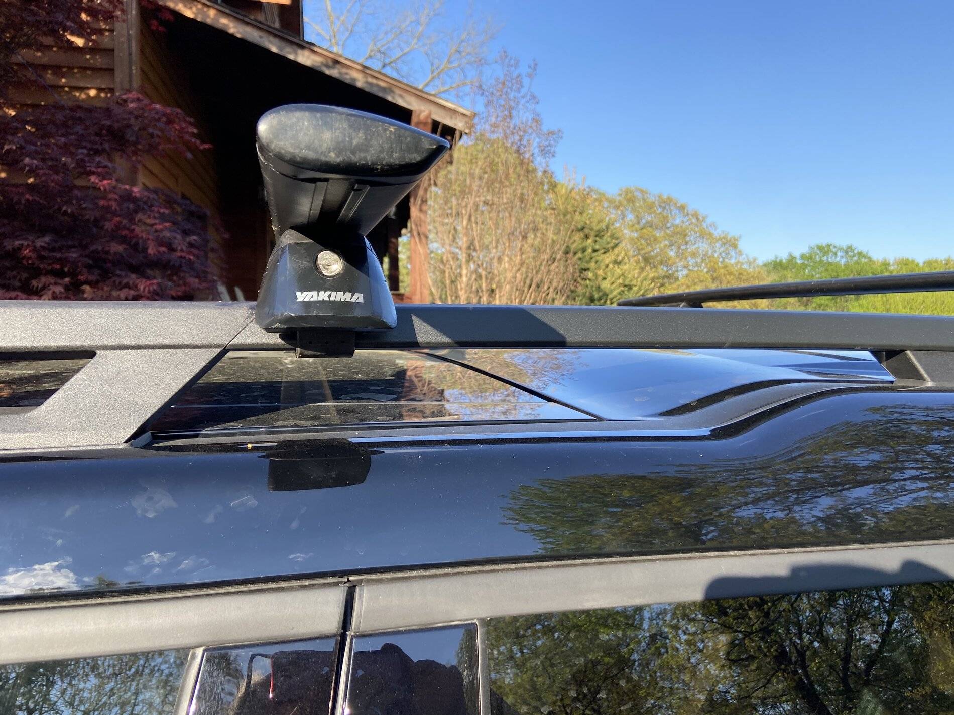

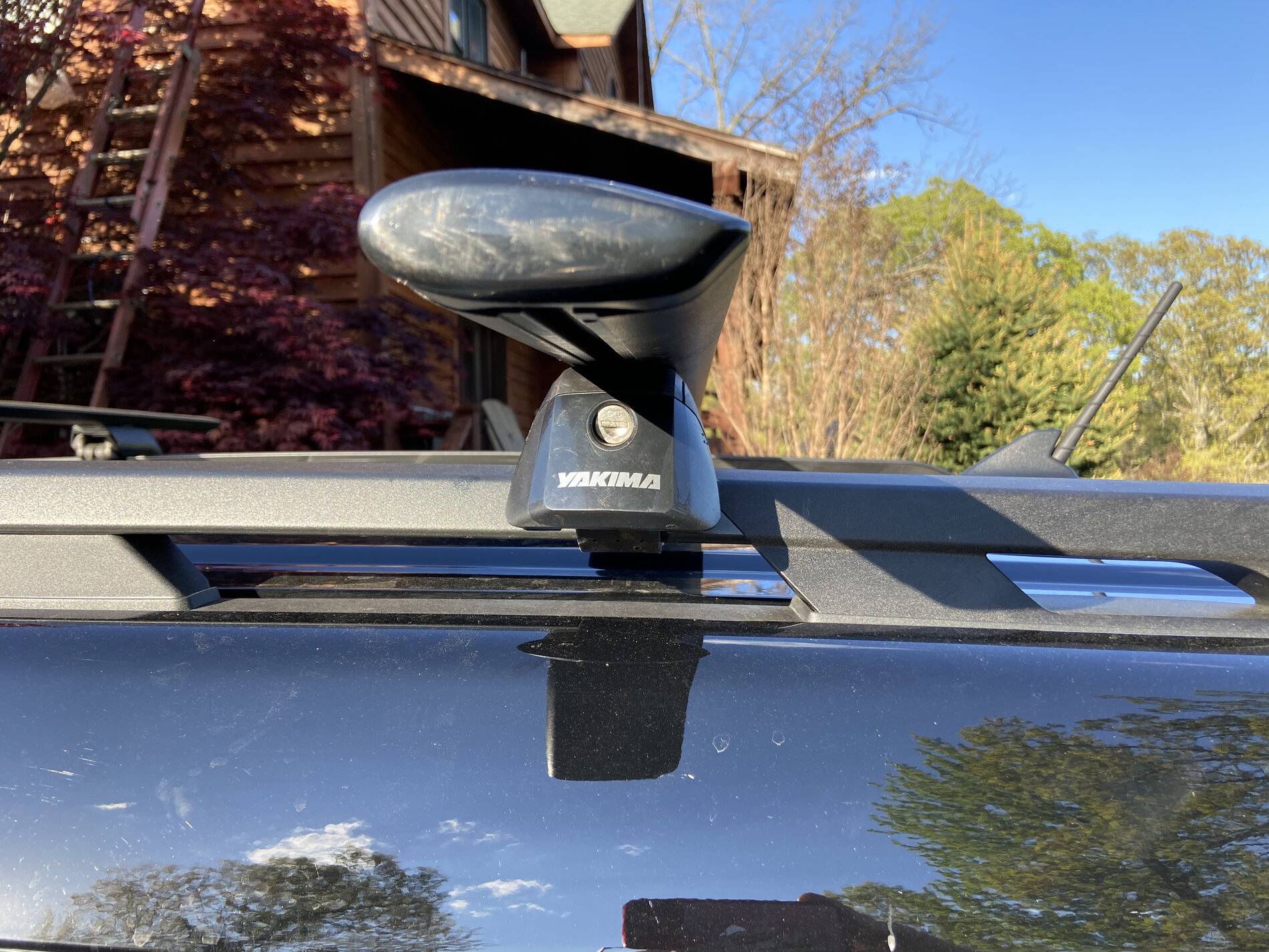

Oh! You commented about noise and looking at your closer-up picture it looks like you do NOT have the rubber gasket running the seam on the underside of the crossbar? Can't quite tell. You want that in there - or so eTrailer said in their video - otherwise it creates excessive noise.
I found this out the hard way today. I just picked up my BS from my dealer today. My salesman actually installed my window deflectors and Yakima crossbars himself. Once everything was done, I asked him what those "extra pieces" were. He didn't think they were necessary, but I asked to save them just in case. Driving home, the wind noise from the crossbars was very apparent. Not so much with the radio up, but definitely noticeable with the radio down and windows/sunroof open. I told myself that I would have to get over it and made a mental note to take a look at the instructions that I thankfully asked him to leave for me.
It turns out that the "extra pieces" I saw were the rubber gaskets you just referred to. The directions clearly show how you put the rubber gaskets back in during the installation process. I plan on doing that later this week and, hopefully, reduce my wind noise.

Oh wow - I hope it makes a difference. That's exactly why I won't have my dealer install any accessory. I just don't trust them with that kind of stuff. Although, if something goes wrong you can take it back to them so there's that.
I moved and readjusted my towers several times and didn't wait until I was certain before cutting that rubber piece, so mine isn't as clean as it could be - instead of 3 rubber pieces (one on the outside of each tower, one between them) mine is more like 5 or 6 pieces.
So to anyone that hasn't installed them yet and sees this - be certain of your placement before cutting it. And even after you are, save all of the leftover in case you need more later!

Great info. After reading the recent posts, I noticed that the dealer did not reinstall the rubber strips into the cross bars. Guess I will contact the dealer but probably just have to get a replacement strip. Thanks again for this info!!!

Posts like this are why I love online forums with a healthy community where everyone is happy to share their knowledge with the collective. Thanks again. I will definitely update everyone once I apply the fix.

Wow! That explains a lot. I carefully adjusted them and they are still pretty bad.
there were no gaskets when I got them. I am talking to the dealer to get that fixed. We bought a mannequin and had to take it with all accessories at their full price. So, I will make sure that they are complete.
