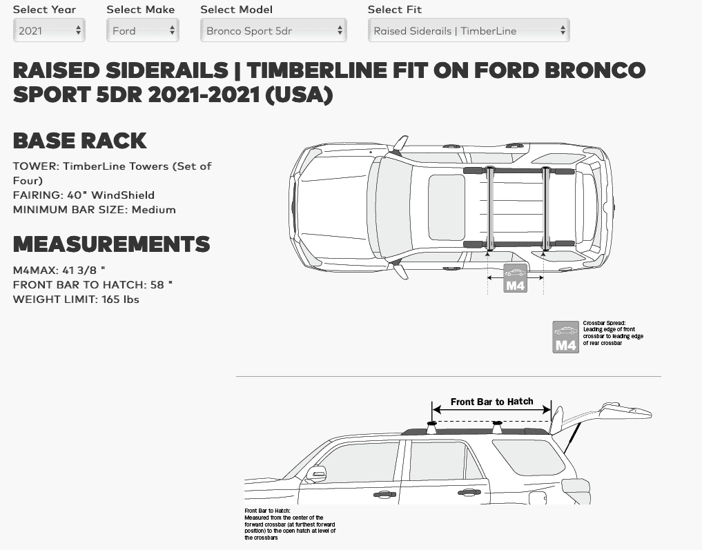

I would guess sliding them aft would help with noise, but there’s a wrinkle. The rails are not parallel, so you would have to adjust the towers on the front crossbar.

I am experimenting! I put them in close to where they had been . They whistled on the highway - but it was bearable. I slid them back about 4 inches and now they whistle on local roads. I just found Yakima's Install info:
Ford Bronco Sport Yakima Timberline Cross Bars Yakima Timberline Install

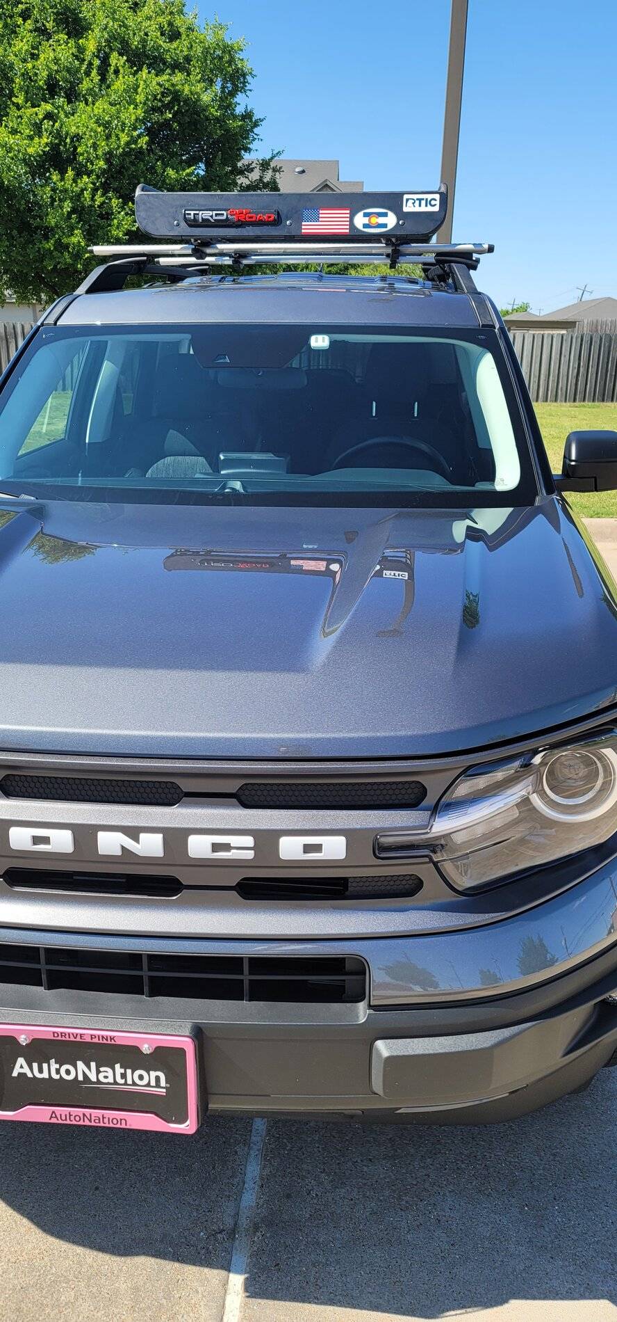

I have thule bars and cannot hear any whistling on the highway even with the window down. Maybe it's just in a tune I cannot hear. I installed on the notches but moved them to fit the yakima loadwarrior w/ extension.

Can you post a pic? thanks!

Thanks. I imagine that your basket affects the noise.
