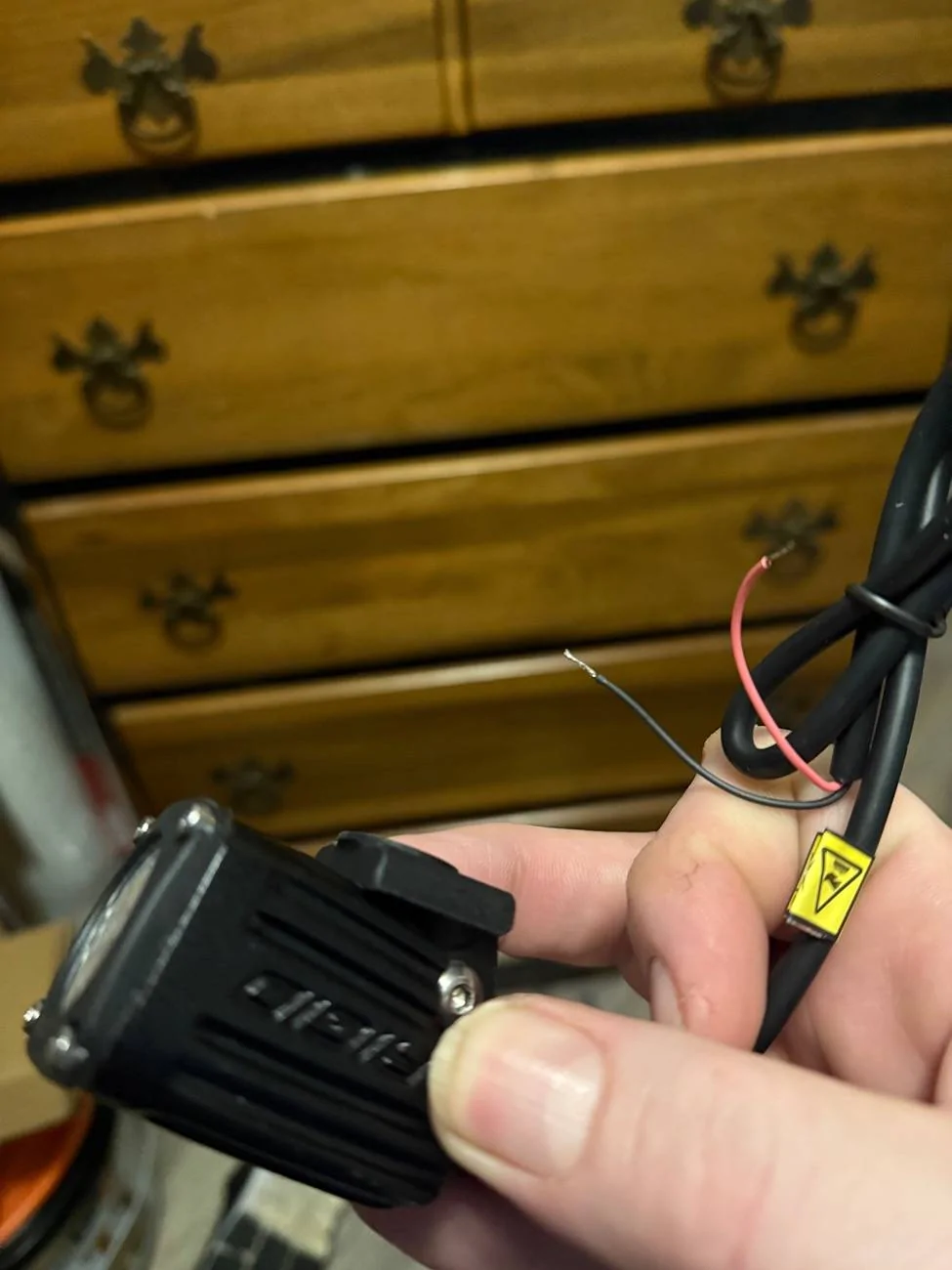

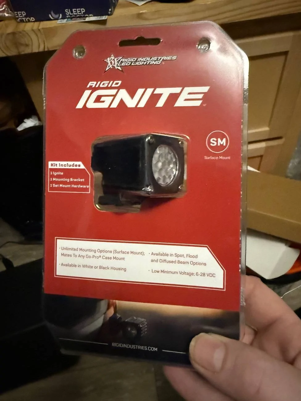

I bought a kit from Rigid, that came with 4 of these lights.
wanted to ask what gauge wire should I order to run these? Wanted to order online, and I’m unsure of gauge sizes. The attached pig tails seem very small gauge. Can I get away connecting similar?
Will be installing in pairs. Plan on connecting to lights on same switch.

@Troiano27 18ga stranded wire should be ok, you can visit a local auto parts store or hardware and have a look at various wire gauge sizes
Voltage drop across copper wire is a function of wire gauge and wire length, for your application the current likely is fairly small for the LED lights since they come will pigtails that are not heavy duty
12ga like the solid copper in your home wiring is overkill for your project (lol) and the pic looks like maybe 22ga wire but hard to tell from a pic
