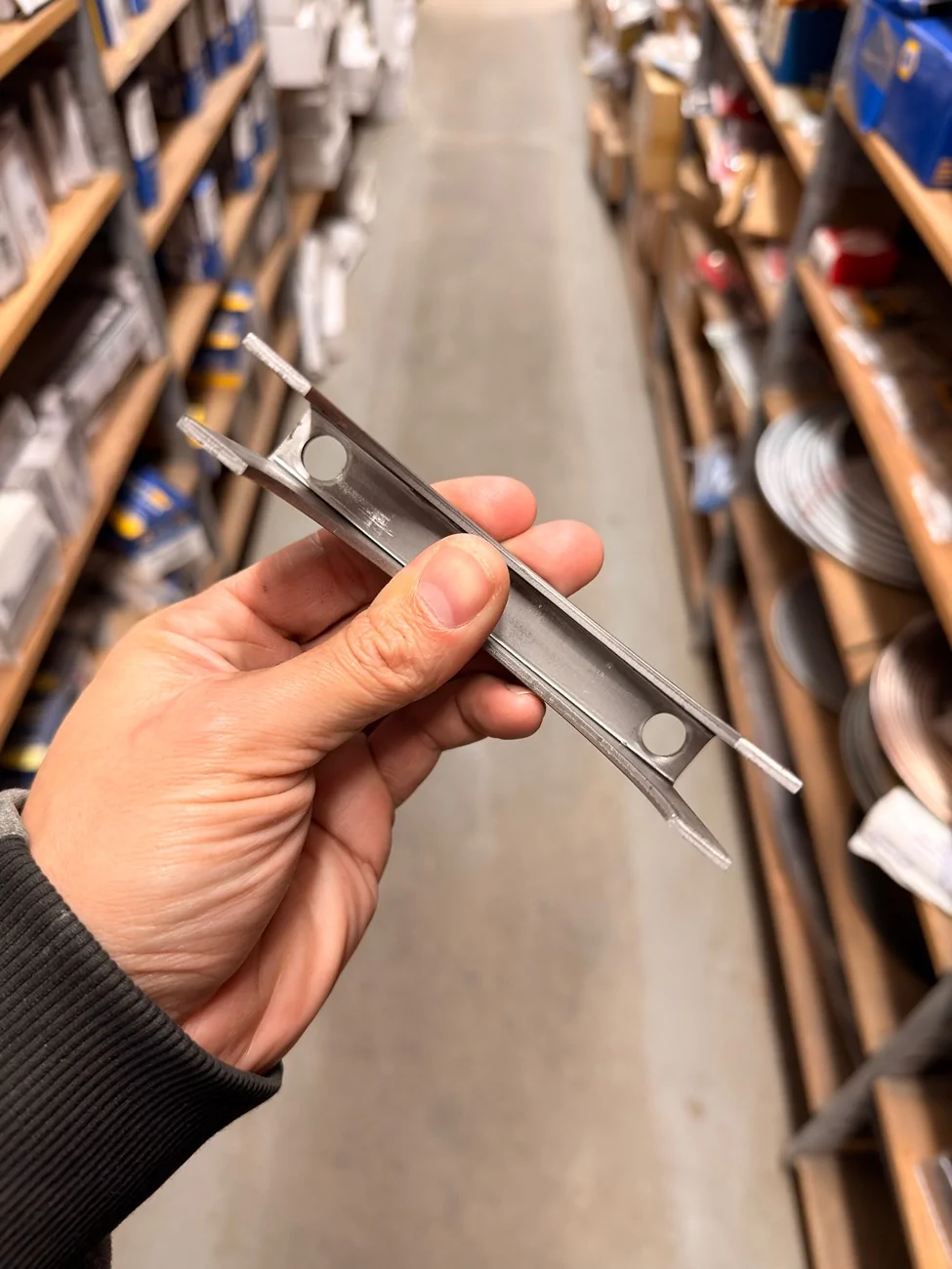

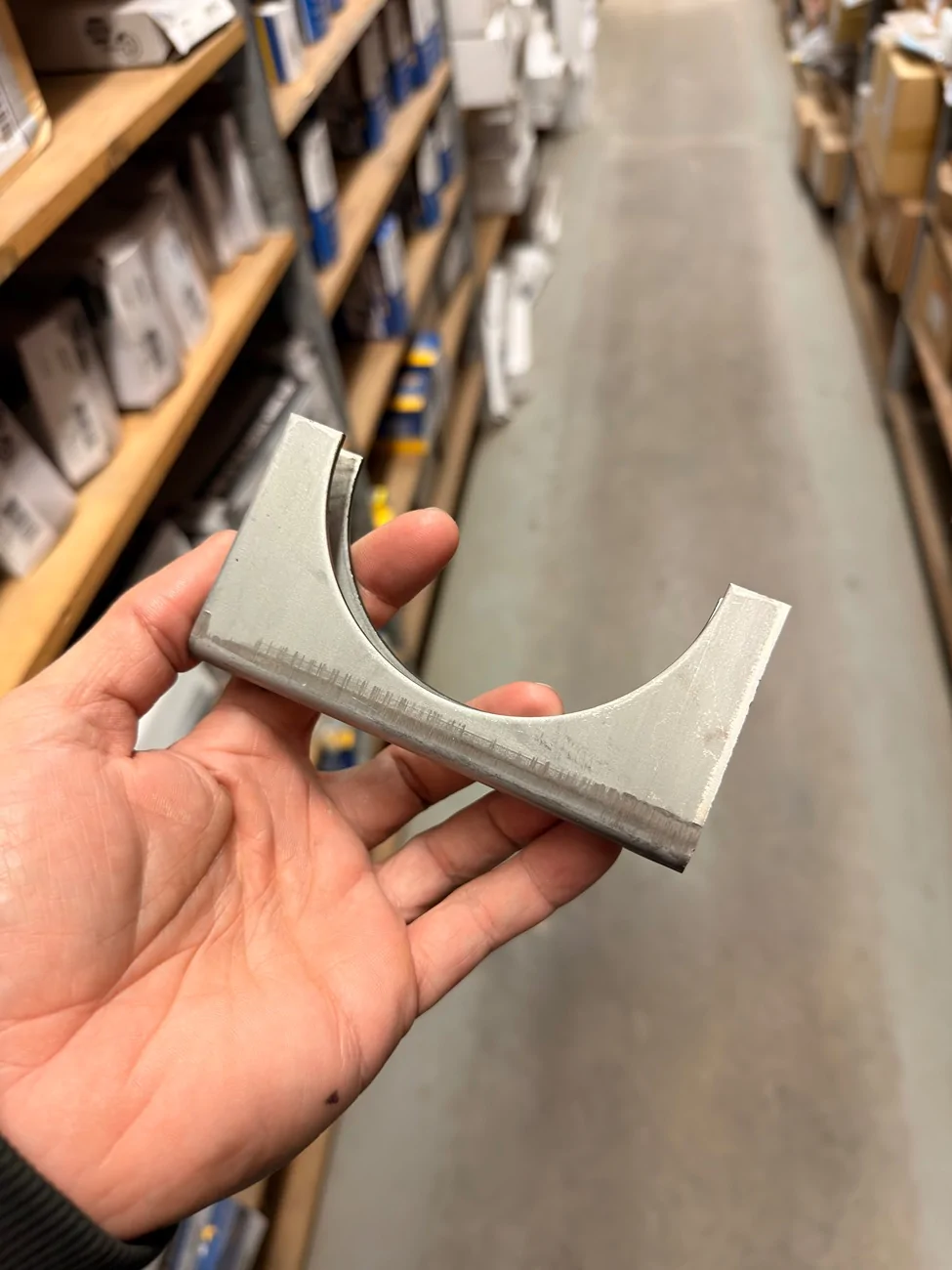

Essentially, I’m after something like this… from an exhaust clamp.
I’d imagine it would be pretty easy to make?
Ford Bronco Sport Who here can 3D print me something? IMG_4134
Ford Bronco Sport Who here can 3D print me something? IMG_4135

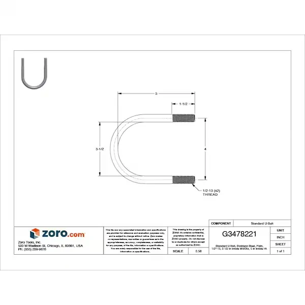

Ford Bronco Sport Who here can 3D print me something? Grainger_2dCAD2023xxg3478221
There’s the dimensions of the u bolt I ordered.
