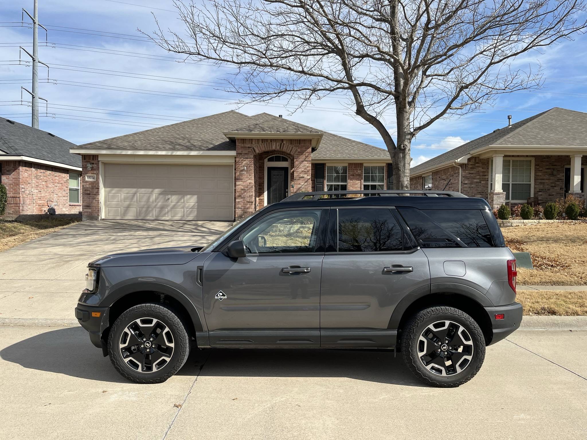

Hello,
wondering what would look best. Currently using stock wheels and Nitto nomad grappler in stock size (225/60/18). I had the 1.5” RC sst lift installed today so was considering a new tire/wheel combo.
Ford Bronco Sport Wheel/tire advice after 1.5” sst lift 1C546BE3-AA6E-4C39-9F86-00D9C0F0C475
Am thinking 235/65/18 or 245/65/17.
I noticed that there’s way less A/T options in the 235/65/18 size but the few options available are good and I like that the diameter is roughly 1/2” larger than the 245/65/17. Just looking for some opinions!
Thanks!
