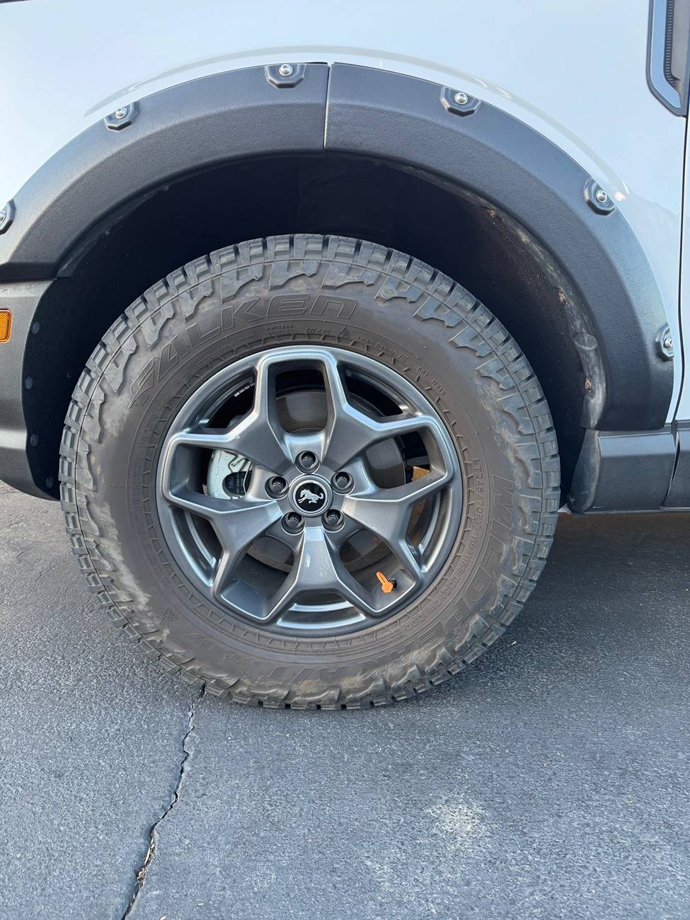

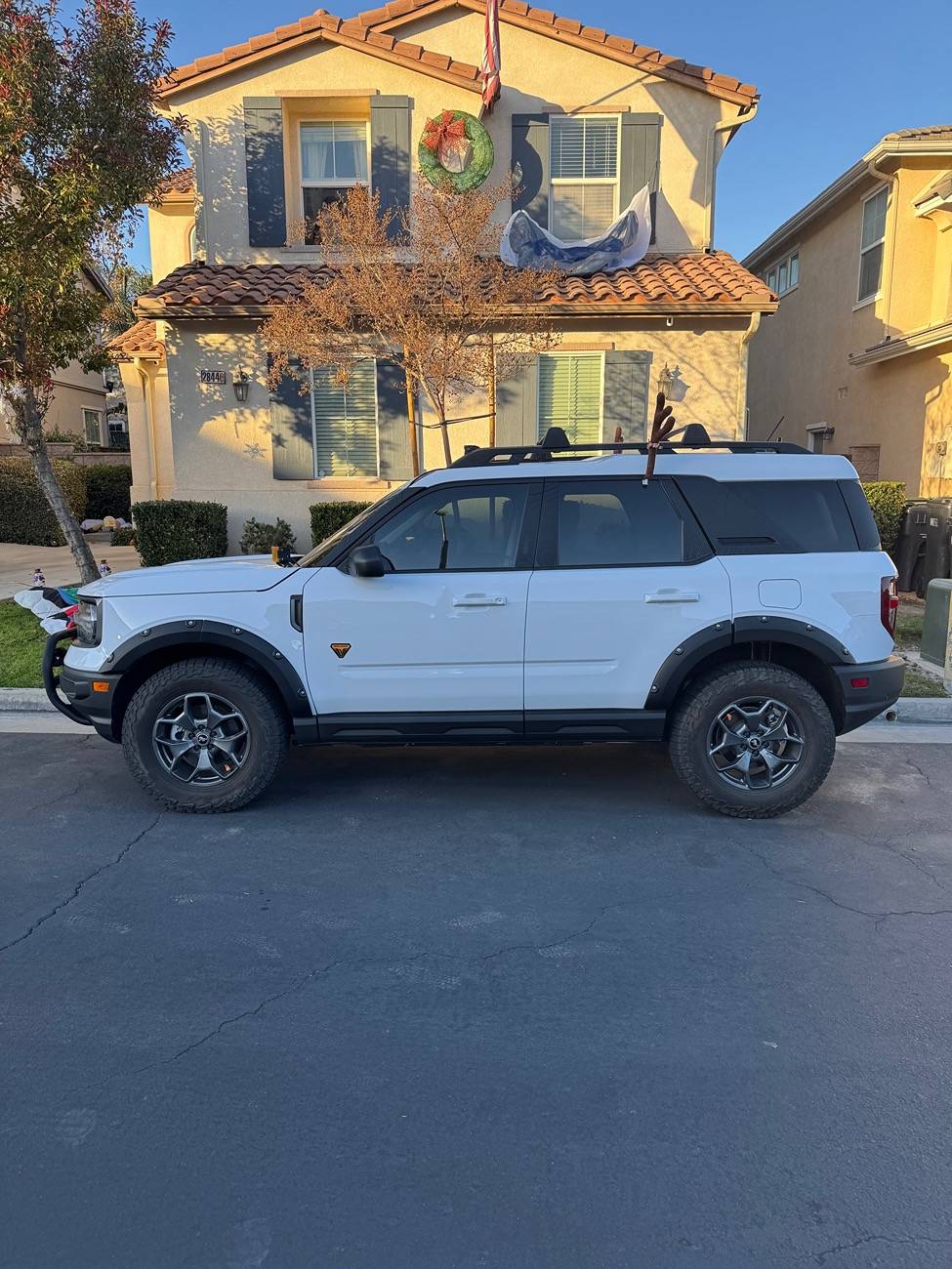

I only have 245/65/17 on mine..so you had no problems with the 245/75 rubbing?
very light rubbing at the fender pinch seam on the carpet wheel liner when turning the wheel with the HRG 1.5”lift. No turning limitations though. I plan on trimming down the pinch seam on the lower half of the seam for more clearance. No rubbing through the entire suspension cycle either.
Take care with the amount you trim and with rust proofing afterwards. The pinch welds are what hold the various parts of the unibody frame together; trim too much off and you will lose unibody rigidity. Additionally, the seams are the most likely place for water/debris intrusion of the seams between parts, which is why the factory takes special precautions with these areas. If you trim off a seam you will likely also take whatever material was added at the factory to weatherproof the seam.
