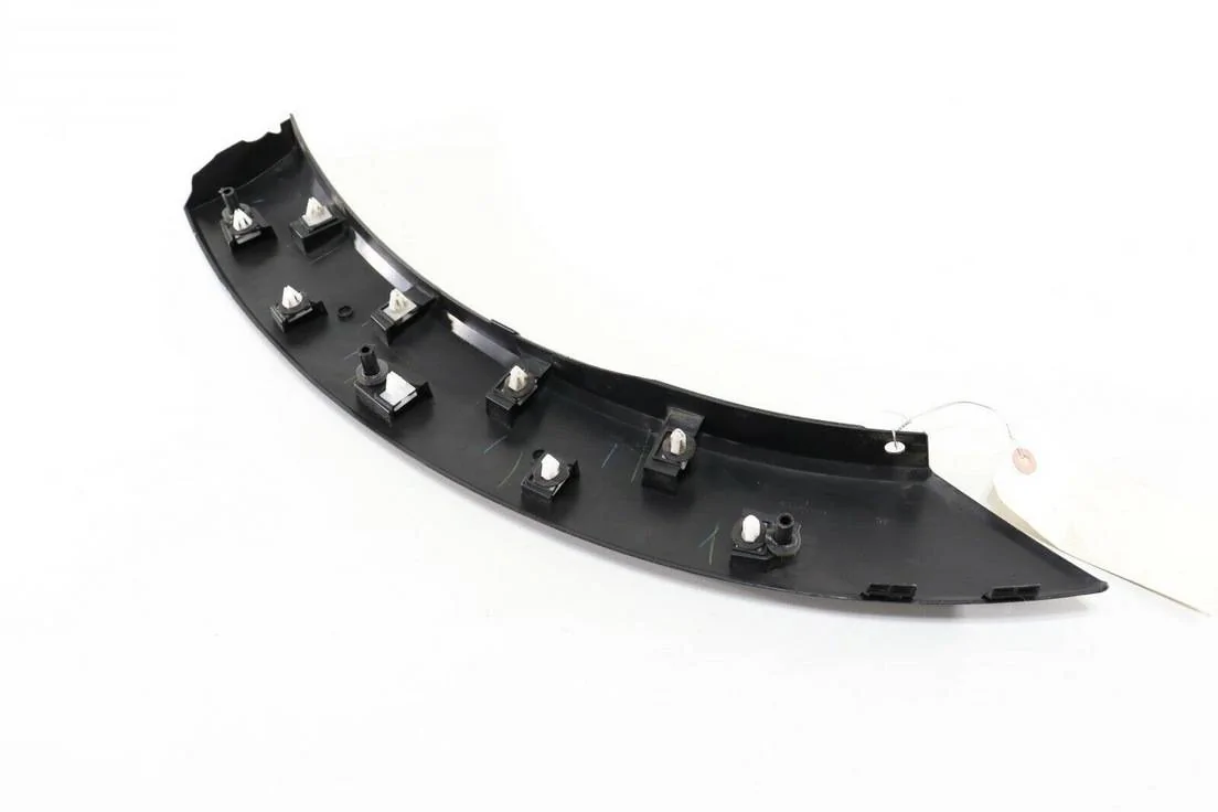

do these clips just pull out with brute force, or is there a trick? or a special tool (besides the usual trim removal tool)?
Ford Bronco Sport wheel arch molding clips rear fender  flar

the picture in my initial post is from a parts listing for these rear wheel arch moldings. the four clips on the inner radius can be reached by lifting the inner wheel well liner. the five clips and three locator pins on the outer radius go into a double-wall body structure, and i can't find a way to access the back of them - therefore also no picture.

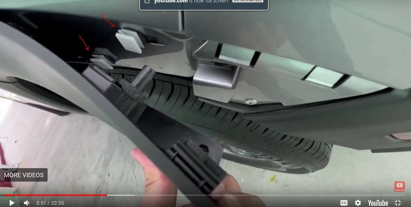

That hitch install video shows how NOT to remove these wheel arch moldings.
There has to be a trick.
Has anyone out there successfully removed these?
Ford Bronco Sport wheel arch molding clips rear fender  flare removal2
I've removed them to replace a rear and front bumper and, as far as I can tell, there is no way to remove without breaking a few.
