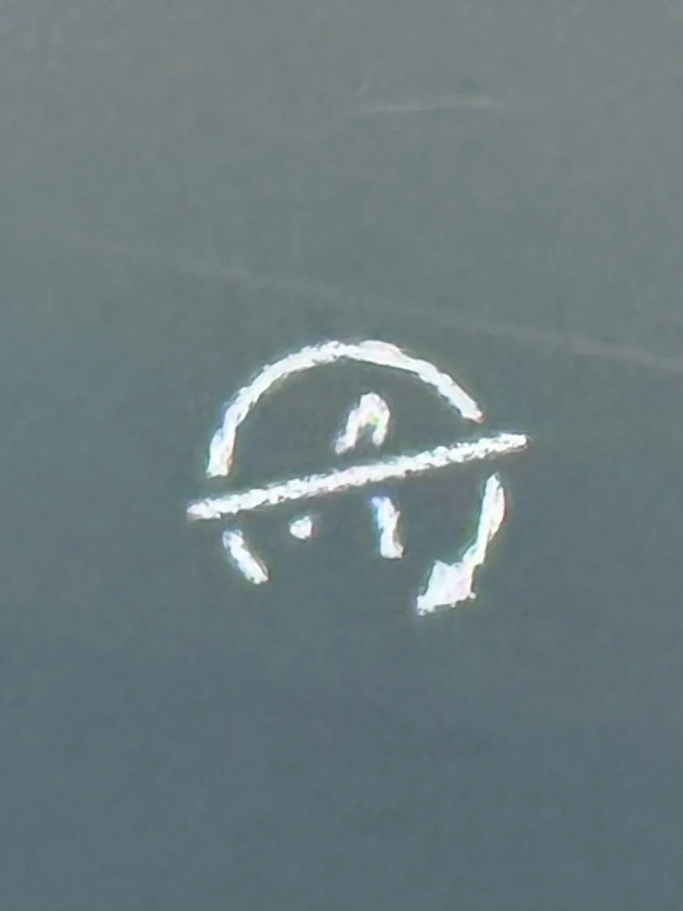

Any idea what this light means? If this is in the wrong place sorry I am new here!
Thank you

It's the light for the auto start stop. The light means auto start stop is not functioning or not currently available. Some people would consider that a good thing, myself I don't mind auto start stop, if functioning correctly it's transparent.

It will appear when you've either manually disabled it or because of engine load (it disables itself automatically, running A/C is an example).

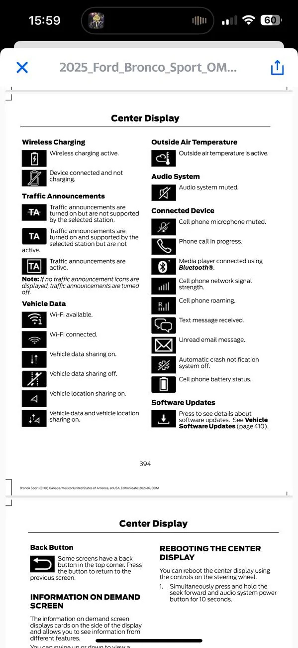

If it doesn't work often, it is a sign that your battery isn't sufficiently charged. There was a recall on the 21-24 Sports, so we got a new AGM battery for free. If you look in the owner''s manual, it will explain the normal reasons the Auto/Stop/Start won't work.
