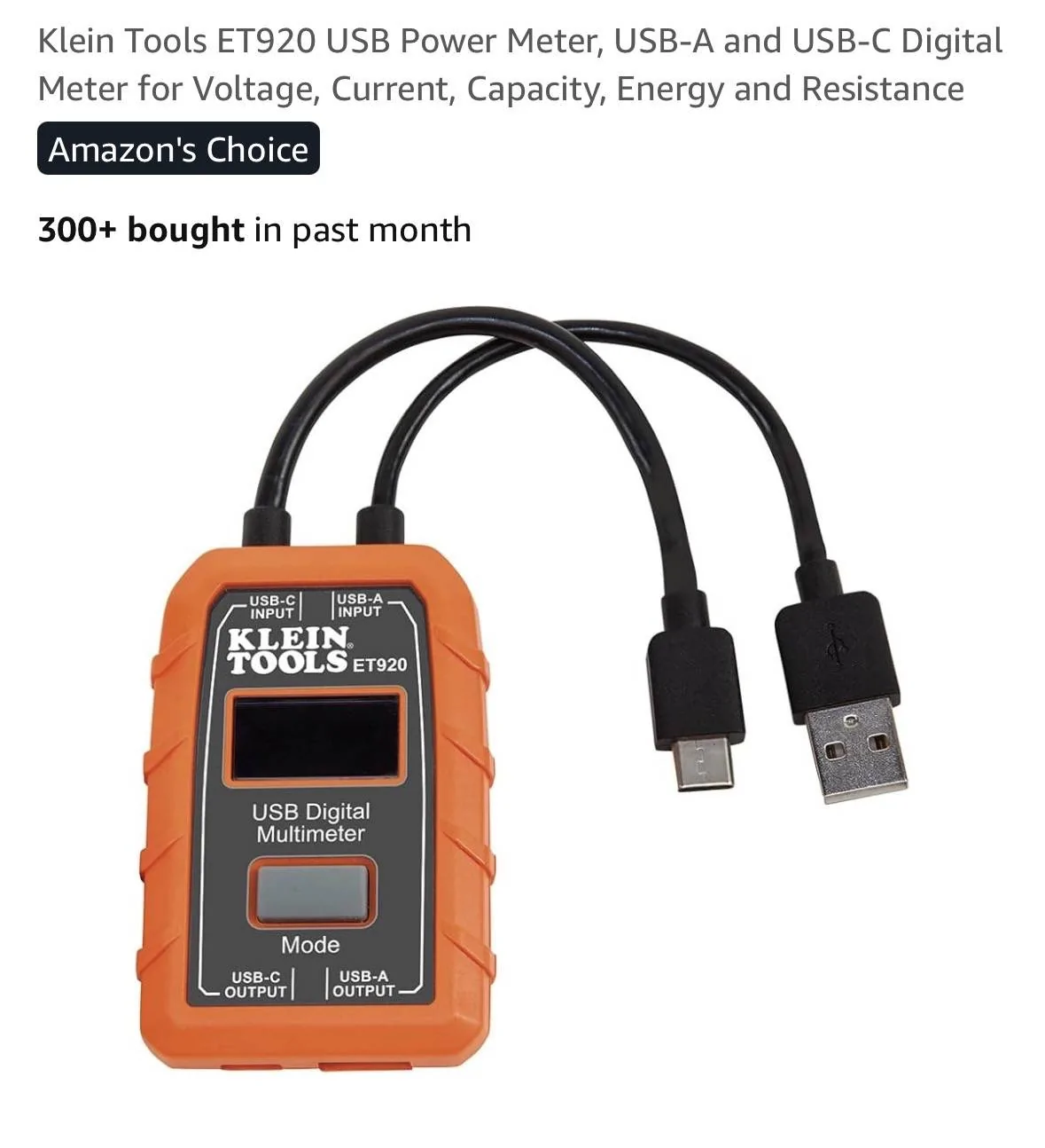

What I really want to see is the voltage and amperage supplied at each. Whatever it is, it's not enough to drive my Klein USB tester, with or without a load.
That’s odd, the Klein USB tester should work fine on all three USB-C and -A ports
Mine works so maybe order a new one from Amazon and if it has the same issue return with free shipping
https://a.co/d/hpOll8Z
Ford Bronco Sport usb keyed power IMG_8240

Oh, it works fine on everything but the BS. When I have more time, I'll goof with it some more.
