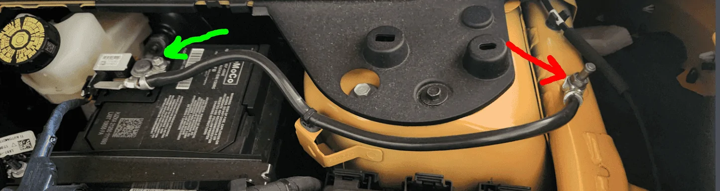

The comment I replied to says, in part:
"The paperwork says "Found chassis ground backed off from body, resecured ground, vehicle started. Cleared codes and tested functionality."
For example, see red arrow:

BTW -- where did I say, "all Bronco Sports are crap"?
What I wrote was, "Sounds like a factory mistake -- one that may explain some other battery issues."
I stand by that. I sounds like a mistake -- it basically has to be unless there's more to the story and someone loosened that connection after the BS was delivered.
Often , when a mistake/defect like that is discovered, there may be more. If that is the case here, it may explain some other battery issues.
If you somehow get, "all Bronco Sports are crap" out of that, it's on you.
