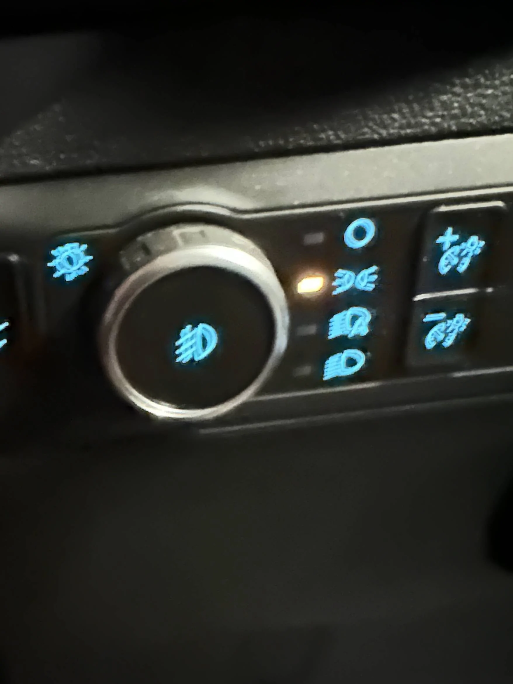

Hey?
I was just out at dark and was checking things, needless to say I couldn’t get the Auto lights mode to go to DRL. BUT, when I turned from Auto to manual and set the switch to DRL and turned turn signals on… the DRL STAYED ON! So hey that kinda blows a lot of the comments out of the water.

What switch did you think is "set to DRL"? There is no DRL setting on the headlamp control knob. If you manually turn the lights on, then yes, both are active.

There are 4 ā€˜settings’ or positions
-Off
-DRL (I’m assuming this is what this setting is)
-Auto Headlights On
-Headlights
The turn signal did not turn the Driving Lights off in the second position.

According to the owner's manual (pg 79), that position is for:
Parking lamps, instrument panel
lamps, license plate lamps and
rear lamps.
Deleted member 6350
Guest
Nope not like that, position 1 is Off. Pos. 2 is the parking lights. Pos 3 is Automatic and Pos. 4 is On.

Well in Automatic position the ā€œParking lightsā€ are on during the day… what I consider driving lights. They go off with the turn signal in that position, but not in the ā€œParking Lightsā€ position.

Position 2 is parking lights, what my daughter’s generation called ā€˜coolies’. It’s what I use to dim my lights at the sentry going on base. Driving with just the parking lights on is ticket able in some jurisdictions. Just an FYI.

Actually the ā€œparking lightsā€ operated in position 2 include the front and rear lights. The DRLs only are the front lights.

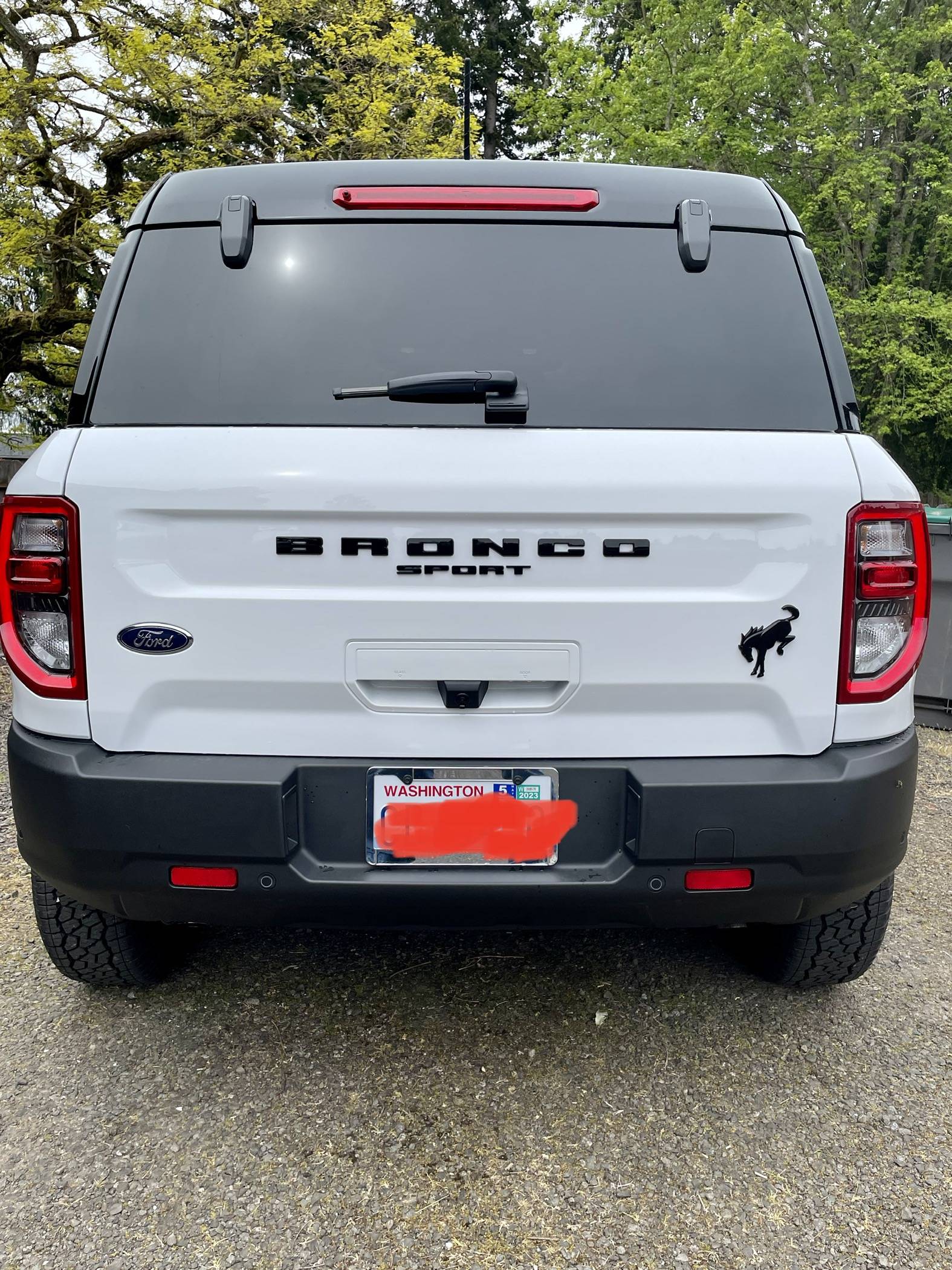

I've owned my '22 Bronco Sport Badlands for 6 months now, have made a few changes to the exterior... mine is Oxford White and had white lettering on the rear liftgate! Terrible look in my opinion so I purchase new "Bronco Sport" lettering in black to replace them. Much better look. I do have another pet peeve though, I do not like the way the front turn signals turn off the adjacent driving light...why? I spoke to a local Ford Service department about it and he said Ford wouldn't touch the current set up. Safety Issue?? All he could suggest is that a third party may come out with a "fix" for this, any comments?

Where do you purchase the black letters and how much did they cost. I own a BadLand sport 2021

If you've enabled DRLs in the Vehicle Settings in Sync, the LED bars will come on in the parking light position at half intensity. They will NOT shut off in response to the turn signal.
Purchased online:
LevittownFordParts.com… the letters were in the $120 range, ā€œBroncoā€ emblem was about $32.
