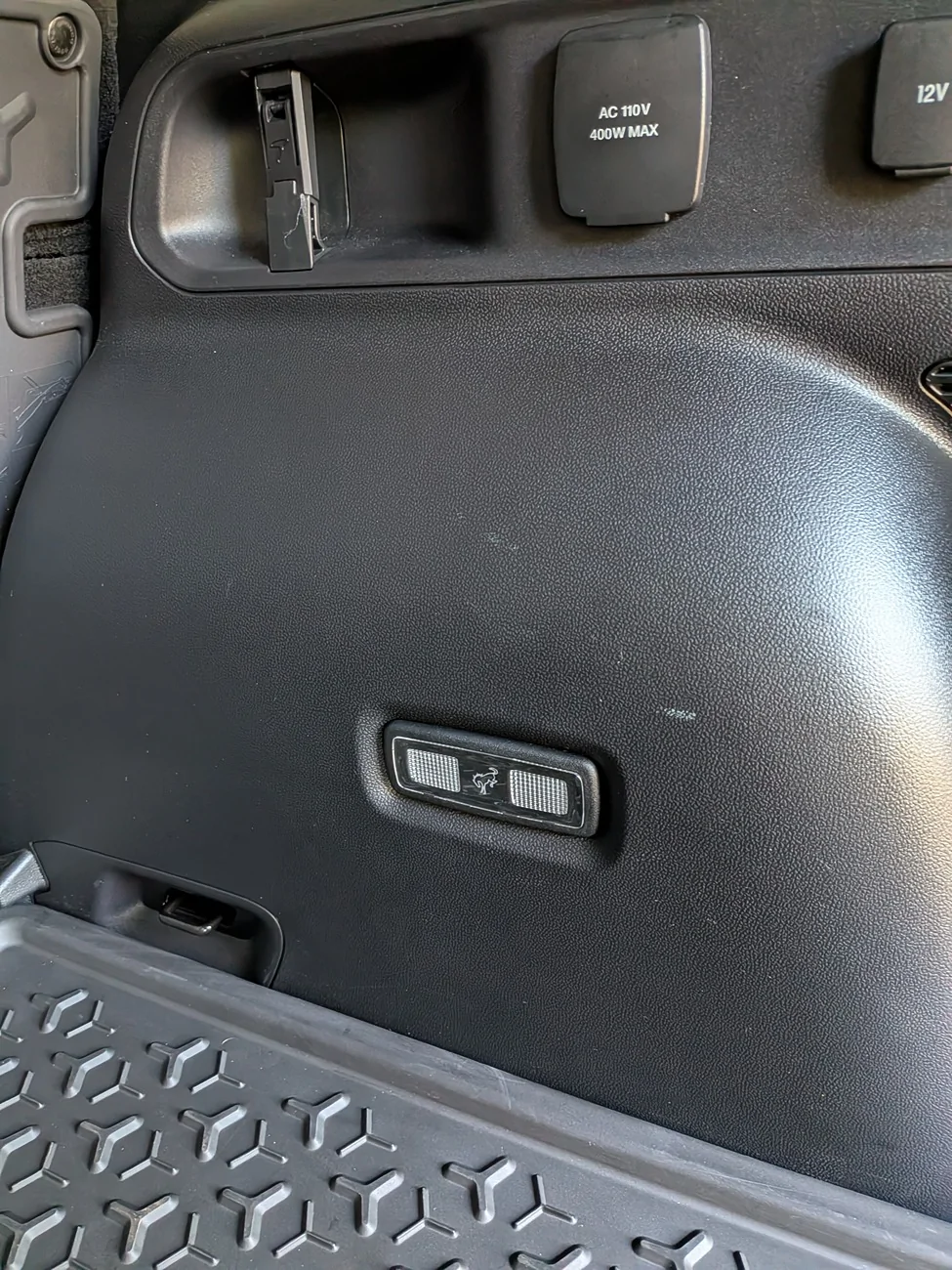

On my 2025 BSBL, is there a way to turn on this light? My understanding is the BSBL doesn't have ambient lighting.

I would imagine that it is switched off at the overhead console. The light comes on when doors are open, or when you unlock the car.
On the overhead console, there is a three position switch between the two map lights. They are: On, Delay, and Off. Check the position of the switch.

Thanks for the tip. We were out camping with this new gem and we only used the manual lights. Have a great day.

I just use the ones in the liftgate, the two that you can aim. The only way to turn that right side light on is to open a door or use the switch by the rear view mirror, and that turns on all the interior lights.
