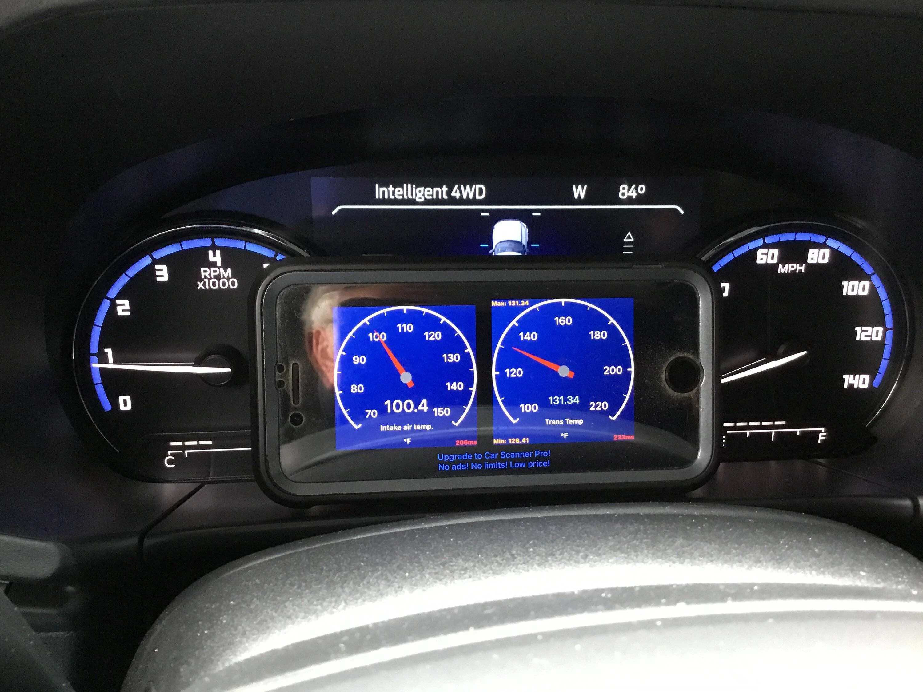

Downloaded APP mentioned by OP. It works with my Forseal Wi-Fi for IOS & Android that I use for Fusion OBDII. Only got to try for a little bit but did try Trans Temp & Inlet Air Temp. Took very short ride, values did increase some. Will try more tomorrow.

As posted above, I got this app to work briefly last nite. Today before starting my OB, it was in the garage overnite. where ambient temp was 84. I started the app and it showed inlet air temp as well as trans temp. They were not identical but close and both were in 80s. Also before starting the OB, I switched the app on my iPh to Fusion OBD where I have a “dashboard“ with ambient, inlet air, and coolant temps. All were in the mid 80s.
I changed back to the app OP has & started OB.
After about 20 min in light stop & go traffic, then steady 45-50 for 4-5 miles Inlet Air Temp settled at 108 & trans at 205. Ambient temp was 91.
Based on that I’m thinking there is a trams temp sensor somewhere. At info my 13 5.0 F150 (with tow pkg & trans cooler) very rarely sees 200 trans temp in town traffic.

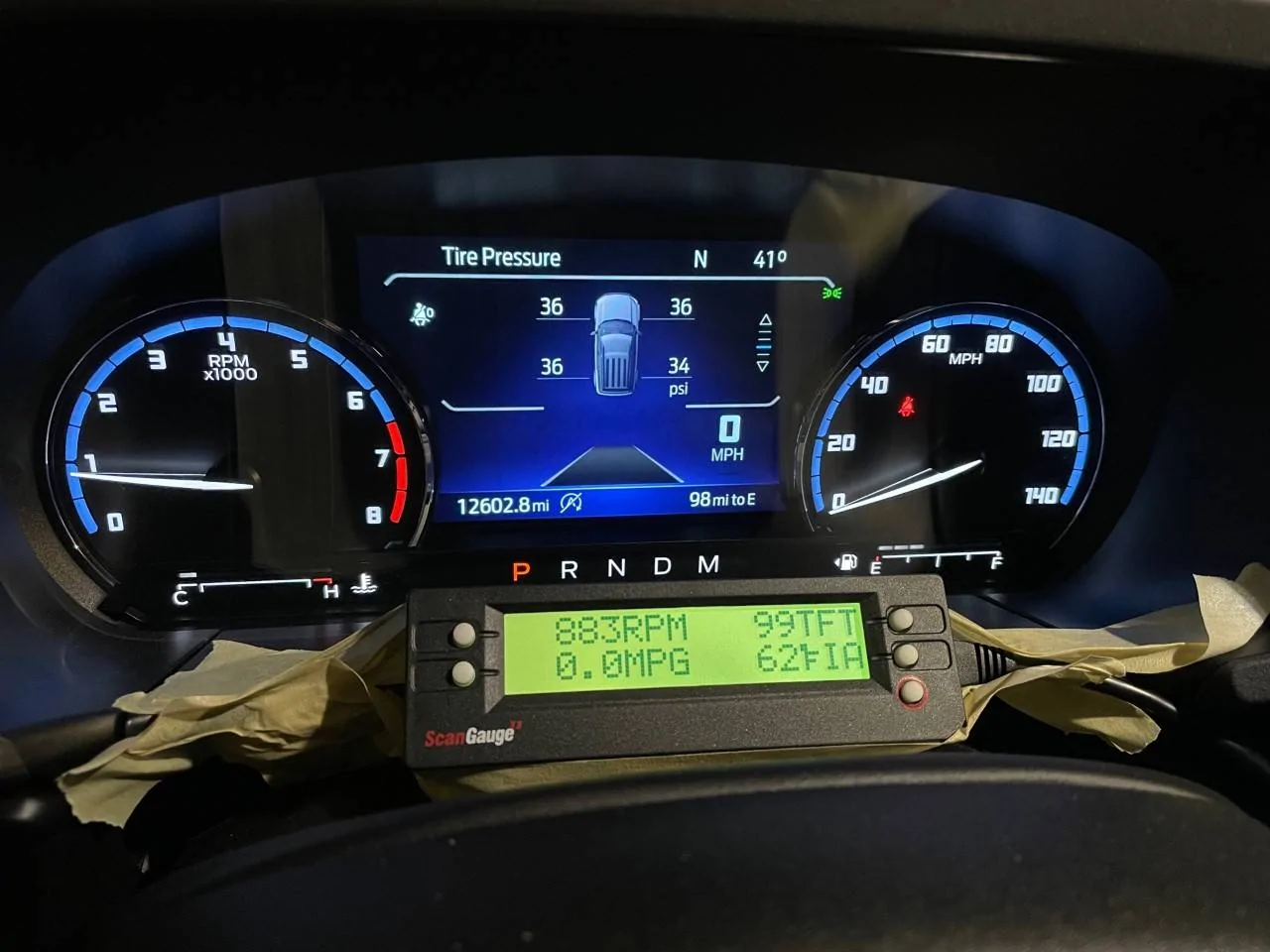

Update: I got my Scangauge 2 from EBay for $130. Pricy, yes, compared to the typical BlueTooth OBD2 gadget/phone combo's many folks use. But I stated my case above, for that. (In case anyone cares ;) ).
I plugged it in and temporarily taped it onto my dash under my instrument cluster as seen in pix below. It started right up and I was able to immediately add a 'gauge' (ScanGauge would call it an 'XGauge') for Ford CANSF transmission fluid temp, commonly referred to as 'TFT' per their recommendation in the channel definition from their web site Support section on PID's.
Right away, this 'TFT' gauge started showing pretty much what I'd been seeing previously above, with my little VeePeak OBD2 BT gadget and the phone app. That is, temps in the low 100's (F) upon startup and takeoff, then ~180's (F) when pushing the BS BL kind of hard. ('Kind of Hard' to me, is just spirited driving on side streets and freeways, in Sport mode, with a lot of full-throttle transients within the restrictions of legal operation on public roads).
I'm happy overall (so far) with the Scangauge 2. It meets my above criteria for my use case vision. Plus it enables me to track my most crucial parameter, TFT, going forward. I will make a more permanent velcro (try not to snicker now!) mount next, in the illustrated location, and proceed to the next phase of all this. I'd like it to show some "bonus" PID's too, like TBV (Total Battery Voltage) and SOC (State of Charge) for my new Optima 12V battery. Scangauge says those can be shown... but tonight I was struggling a little with getting those to display nonzero values so far. I will update you all, as time permits.

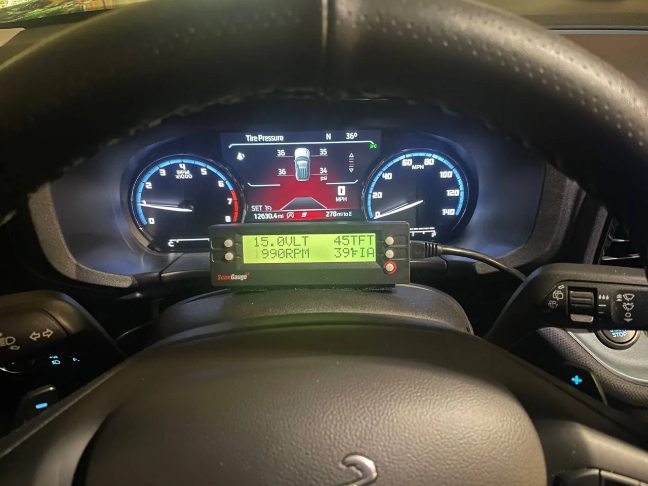

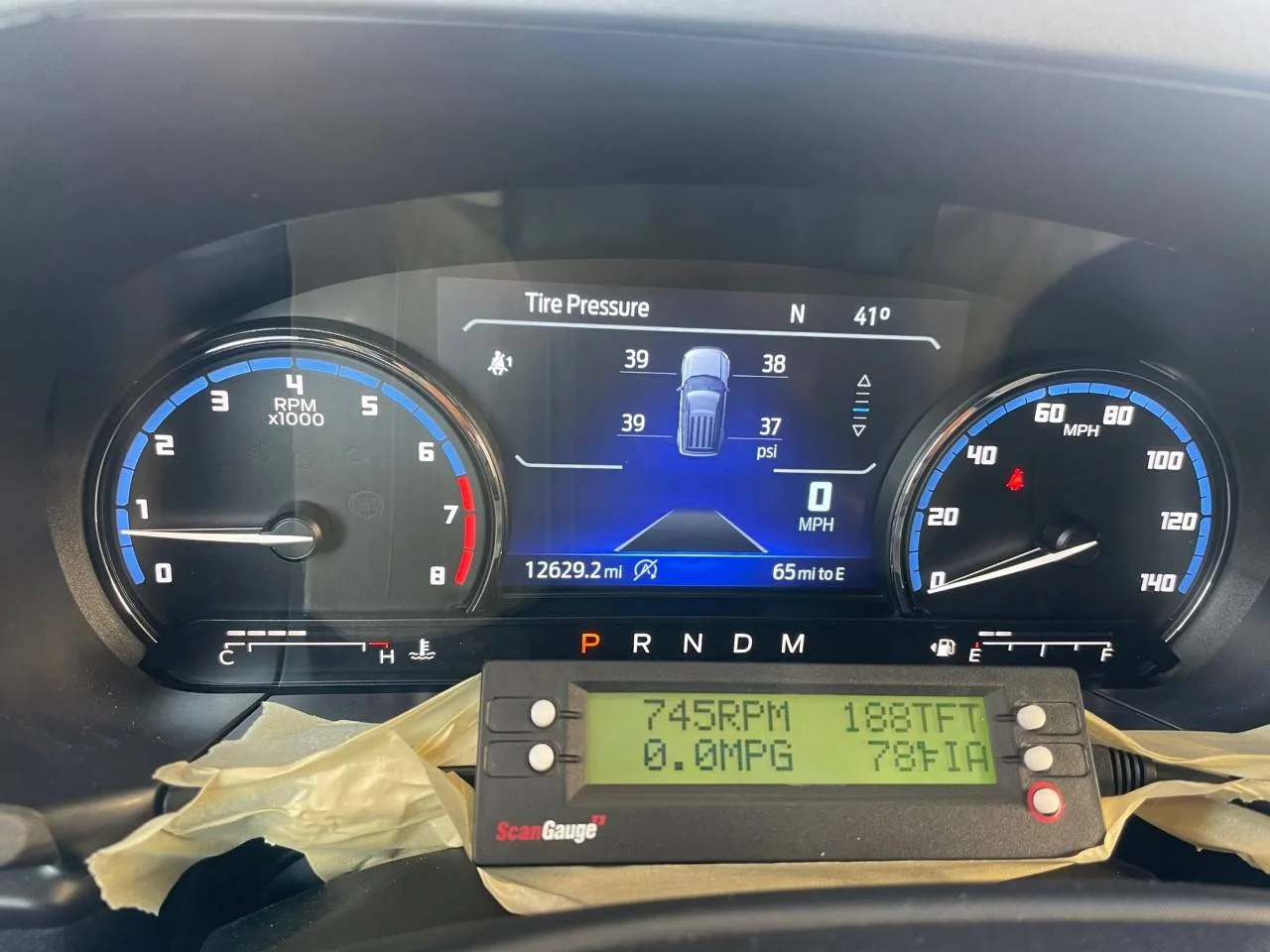

Another update - I'm communicating now with '[email protected]' on TBV and SOC, we'll see on that. In the meantime, I did find there is a default voltage available out of the box for the SG2 - it's called 'VLT' (Total Voltage? I guess) and tracks very well to what I'd expect my battery terminals to show if hooked up to a DC Voltmeter. That is, about 11.8 VDC with engine off and dome lite on, 12.x with same but after running engine, and 14-15 while engine is running. See pix below. I also started improving the mount today, going hi-tech with real Velcro as supplied with the kit. Many times I expect I will unplug and run without the SG2 in place, as in the last pic below. I've now got at least all the basic parameters I'd sought for this - especially the crucial trans fluid temps - so looks like this will work well.
