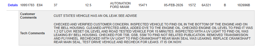

Let us know what the dealership says. Hopefully it’s not a major issue. There have been reports of some transmissions being overfilled at the factory and then seeping out of the vent/fill tube, with the fluid settling on top of the transmission under the air box. If that is the case, it is just excess fluid with no damage to the transmission.
Hopefully, but I'm not touching it and have them blame me for whatever reason that fluid is there. I used to work at the dealer I'm taking it to, so I'm not too concerned they would actually give be crap about it, but if I'm taking it there anyway, I might as well have them drain and replace the fluid after they look at it.
So just to close the loop on this: Looks like I won't have to drain and replace the tranny fluid. Apparantly, the issue was a much bigger deal than I anticipated.
