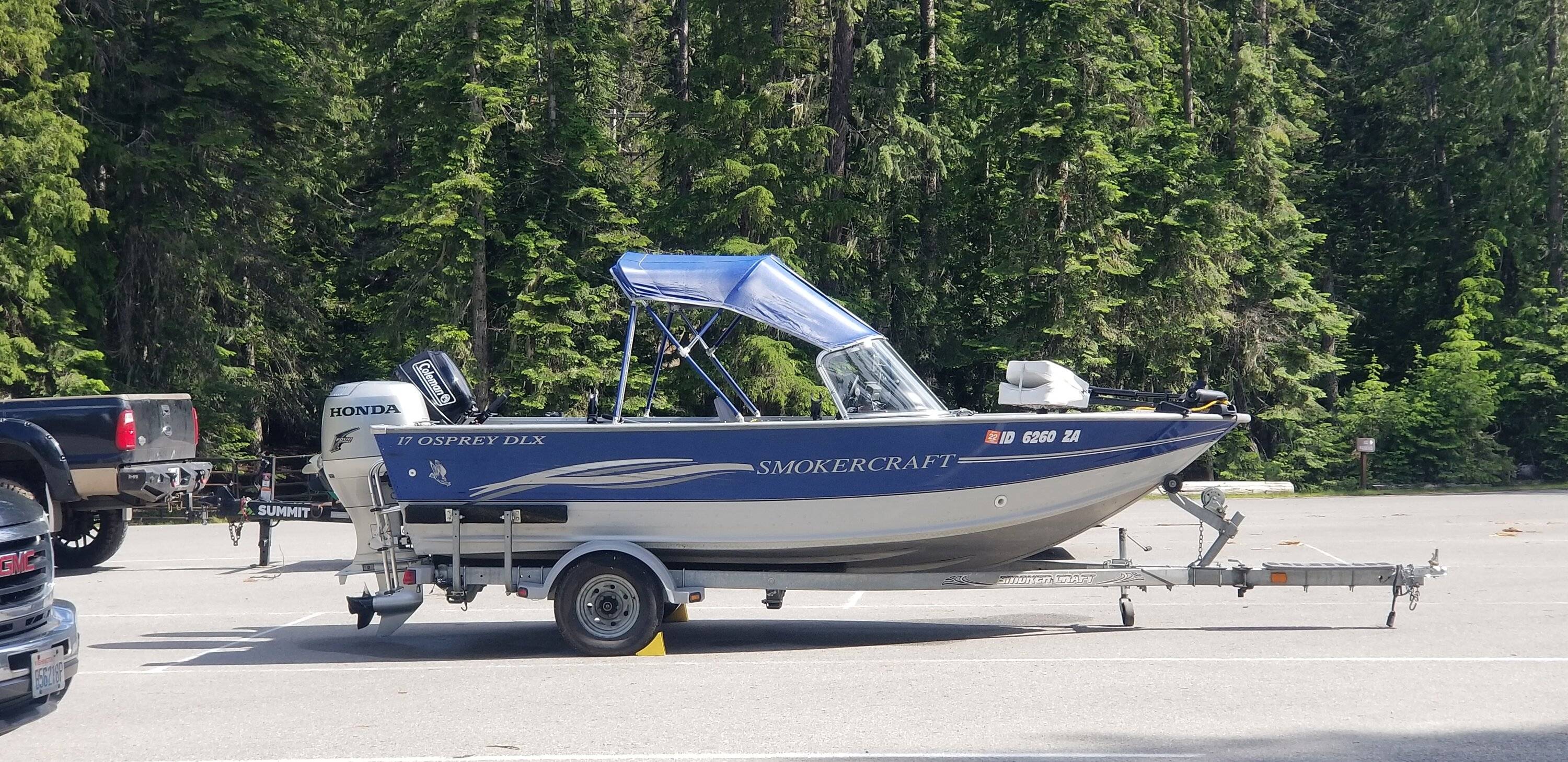

2200 tow is not what I expected. I think I will be selling as soon as I get it. I need to go weigh my boat and trailer.

Nice looking boat!
I'm thinking of towing a jet ski and matching trailer with my BL at some point. I think that's just about max capacity probably if filled with fuel.

that trailer likely weighs about 500-600 lbs alone, boat(aluminum, but with console, likely benches round front) id put it at 1400 plus motor(200ish), fluids, life vests ect. 2200 is too limited. I'll trade you a canoe ive got for that boat you could still go fishing PLUS you can have the happy day when you get rid of your boat... lol

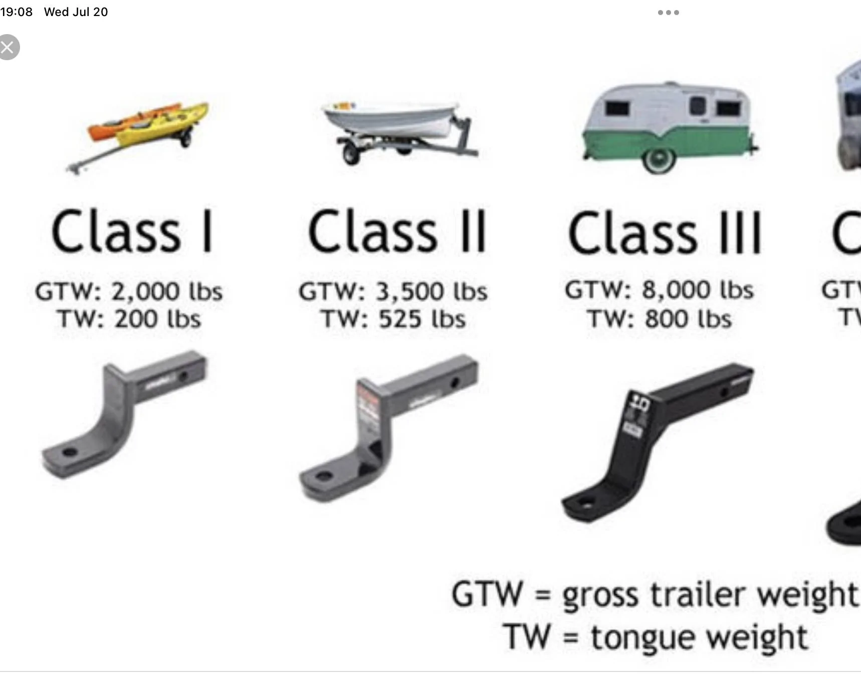

I didn’t order the tow package, but IIRC it’s a class II hitch. Check the manual for maximum tongue weight vs tow weight. Or go buy a F150 and get 17 mpg all the time instead of 24-26 mpg.
