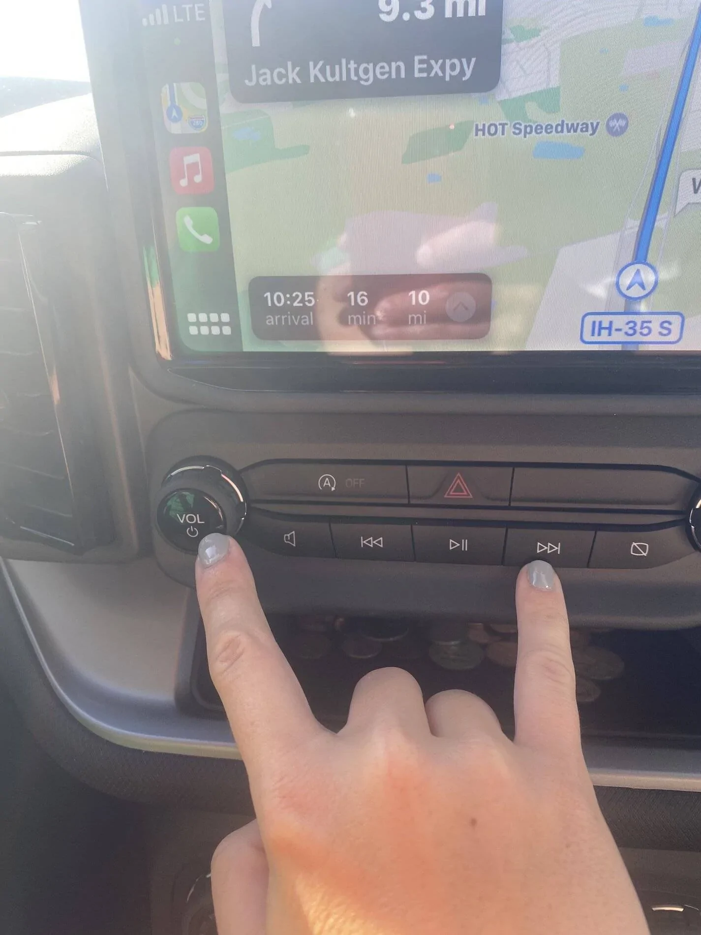

My 2021 Bronco Sport touchscreen has blacked out for the first time after owning for 8 months with only 9,000 miles on it. After reviewing different online solutions I discovered how to reset the touchscreen and Ford Sync system.
If your screen is black, press and hold the power button on the volume knob and the Right-Seek (forward skip button)button together until your display indicates it is resetting or has turned on. You may then release the buttons.
Ford Bronco Sport Touch Screen black outs 9AF3A290-D8D5-4062-BFC9-B83F935BDA20
