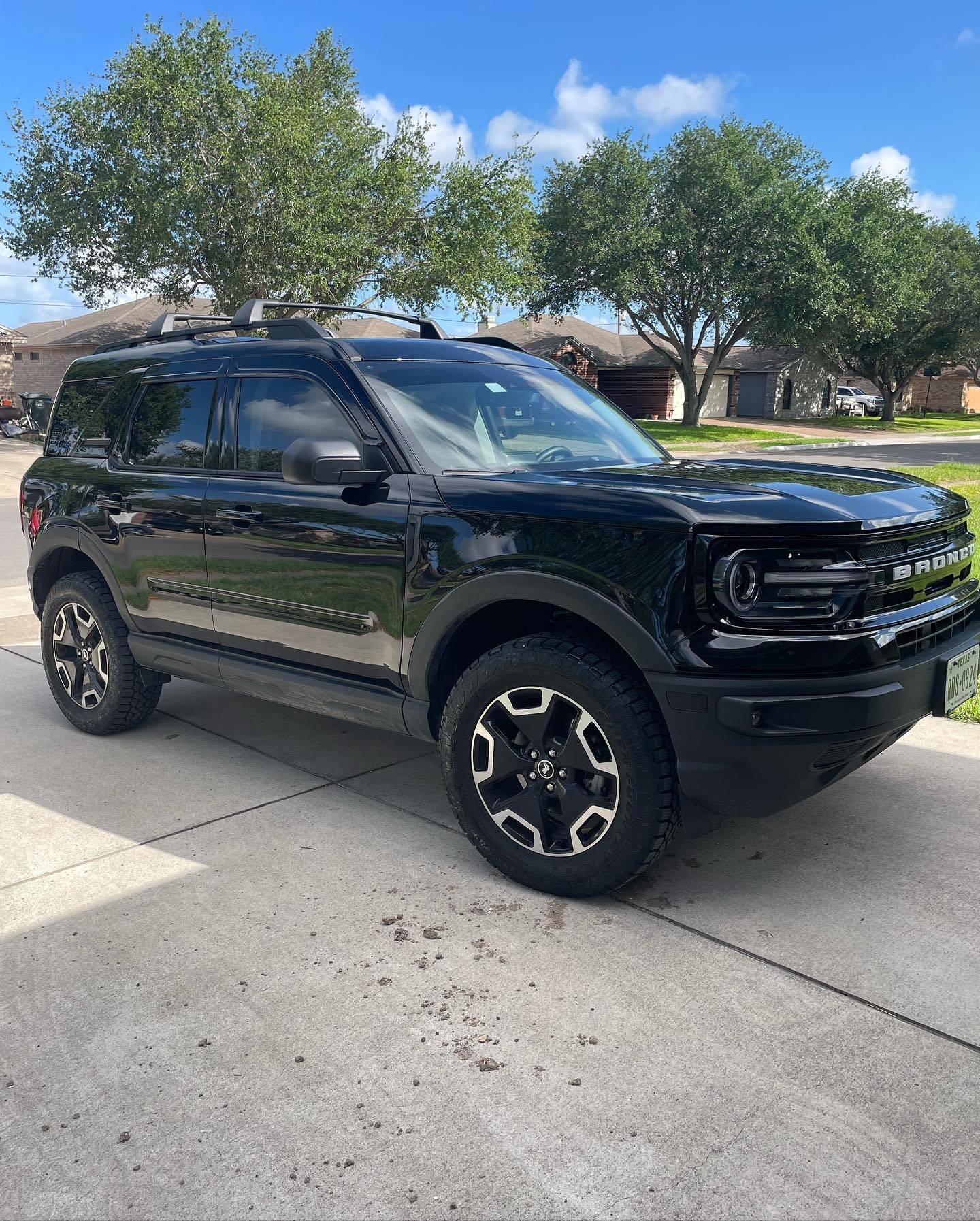

I have Toyo Open Country AT3 235/65/18 and have loved every mile
Ford Bronco Sport Tires and sizing 18A78605-0864-4D7E-BC0F-010D3A6DF3BB

Have you been able to take them in the snow yet? How’s they do? I will be in the PNW mostly, so interested in their performance. I’m very experienced with the BFG KO2s, not so much the other tires.
No snow down on the Gulf Coast of Texas. Driven on soft sand regularly and done well. Hardly use sand mode and no issues. Minor off roading including some freshly rained muddy spots and still no issues. No rubbing for me but I’m not pushing the limits of the Bronco either.

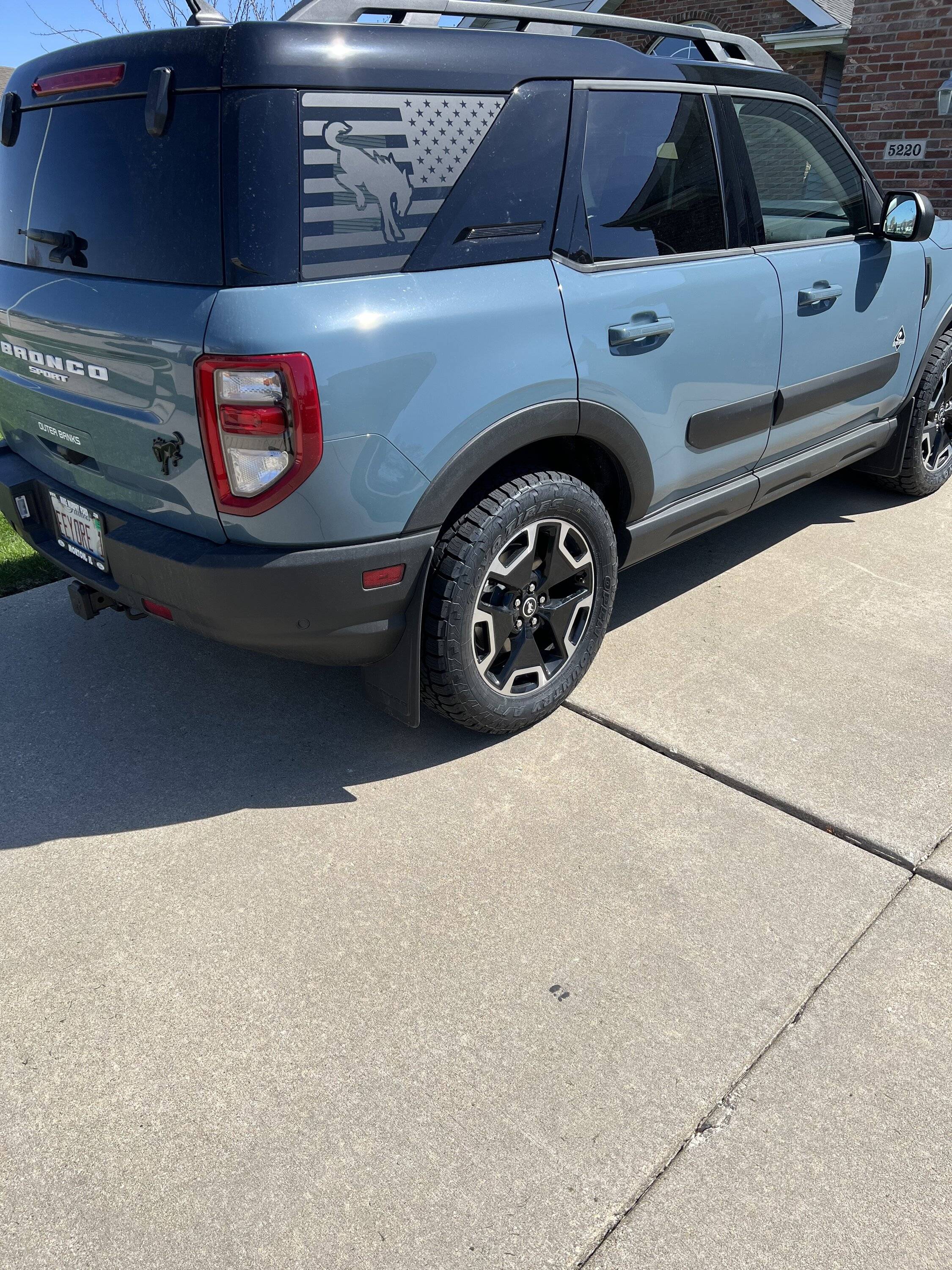

Also, have you taken them off-road at all? I’m curious if the 65 size caused any rubbing?
I have 245/65's. No rubbing at full lock and articulation.
The lugs no KO2'S are wider so I have heard about mine issues.
I was thinking about trying 235/70's next.

Goatsy, can you translate your second sentence? You must be learning from my writing! :cool:
Yup, change "no" to "on" and take out the word "mine".
On KO2'S the sidewall lugs extend out from the tire much more than most others. It makes the tread surface wider.
Basically KO2's are wider than other tires.
